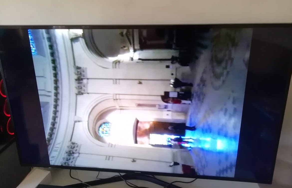

KarlHungus67 6 Posted March 23, 2021 Posted March 23, 2021 Hello, I know this topic must have been discussed thousands of time, but I cannot find a solution to fix it. I have some old video (mov format) created with an old iphone. video is in portrait format. In Emby web app, video is perfect. In VLC also. But on my Samsung app on my tizen smart TV, the video is rotated by 90°. So it fit very well my 16:9 TV, but it's difficult to watch without a stiff neck. I'm pretty sure there is something to modify with the video metadata, but can't find why ? And it's ok on emby webapp, so it's only a tizen problem, or is it a video problem ? Thanks. 2

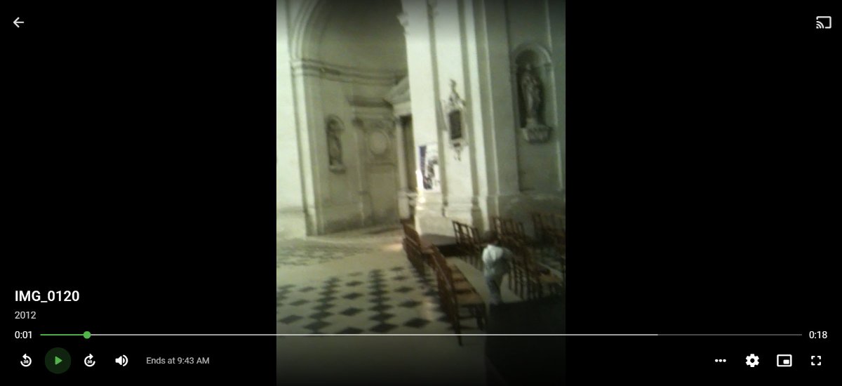

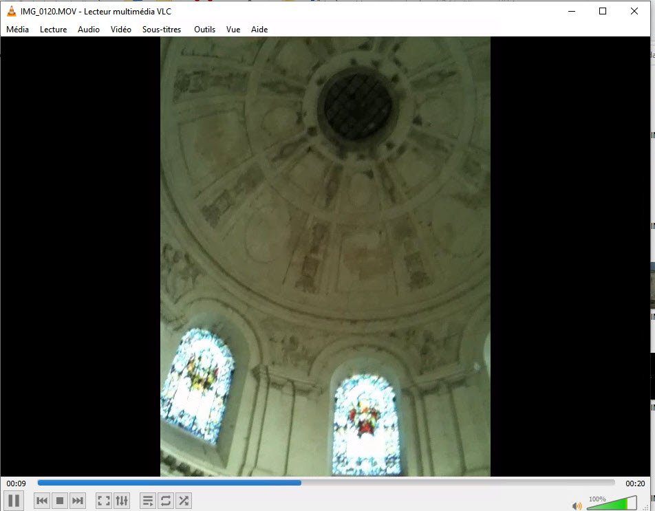

KarlHungus67 6 Posted March 24, 2021 Author Posted March 24, 2021 Sorry, haven't seen you replied to my topic yesterday...Don't receive notification. Please find attached the video file itself, and screenshot of VLC playing file (OK), screenshot of emby webapp playing file (OK) , and screenshot of my samsung playing file (KO - note that the thumbnail has the correct orientation on the TV). IMG_0120.MOV

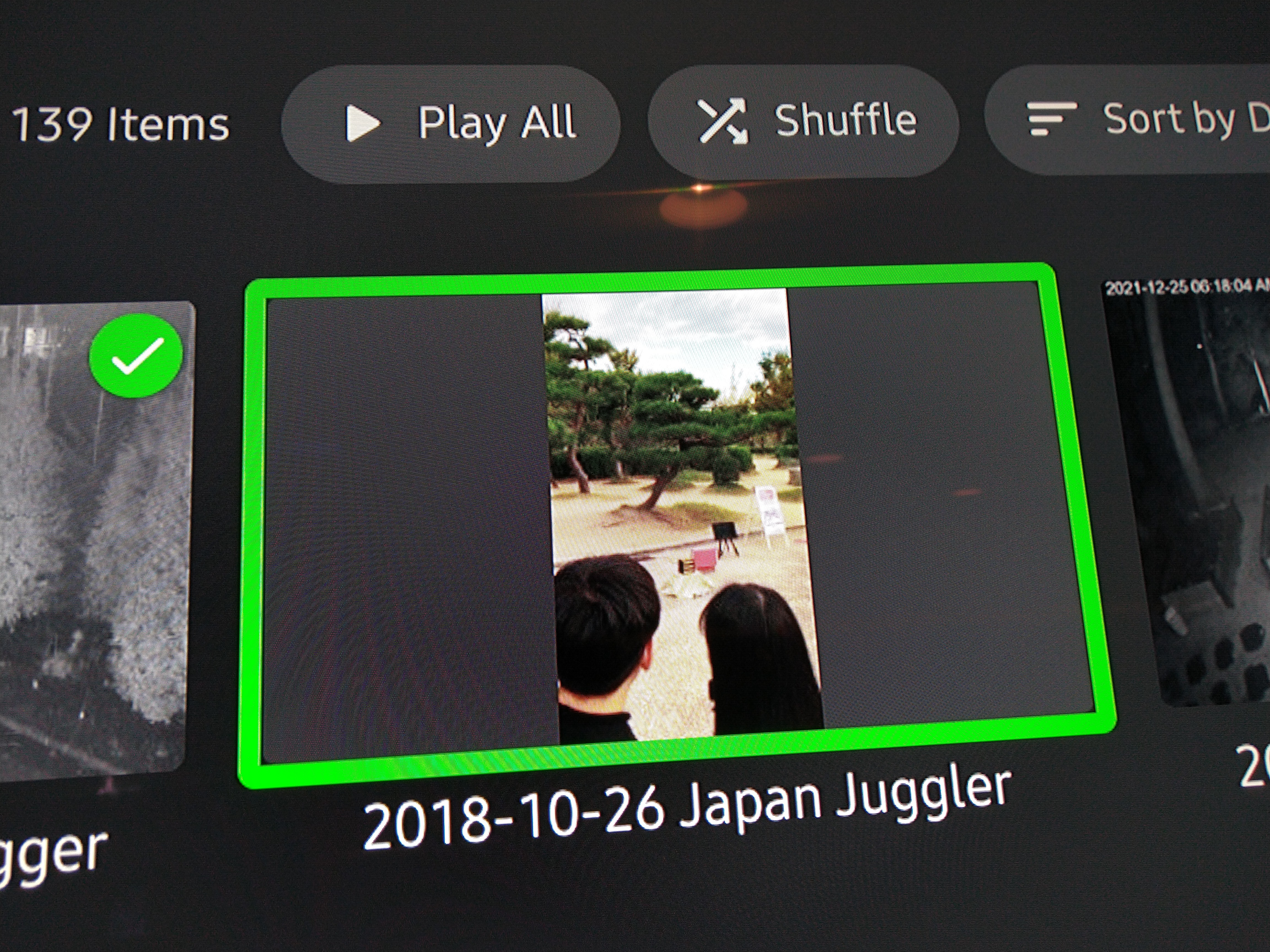

bmflagg 21 Posted February 7, 2022 Posted February 7, 2022 Any updated on this issue? I also am running across the same issue. Lastest emby, server (qnap) and for Samsung TV ( i have 3 of which all do it, including this years 65" 900a model..) Portrait videos or pictures, will thumbnail correctly in emby, but will landscape it once you open them.
