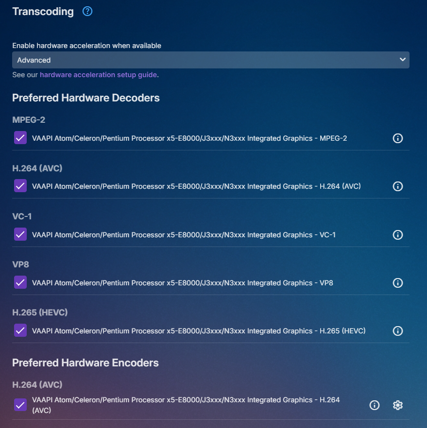

Zoomer88
Just wanted to chime in with an update. Somewhere between then and now (between 4.9.0.12-beta and 4.9.0.20-beta to be more precise) this flag seems to be fixed. With IGNORE_VAAPI_ENABLED_FLAG=true I'm getting the "-ignore_vaapi_enabled_flag hardware" in the command line and the transcoding settings appear and everything got detected properly and is working properly.
Thanks to everyone who took part in this! :)
Edited by Zoomer88
  • Thanks 1
Zoomer88
Pardon the grammar. It was so unexpected and at the same time got me so excited. Oh, I even forgot, how cool this hardware transcoding thing is. It's super stable and the switching between streams is like instantaneous with near zero cpu time.
@alucryd, you're my hero. Thanks so much for looking into it. If you need further debugging of Synology auto detection mechanism from within the container, I'd be really happy to assist!
  • Thanks 2
