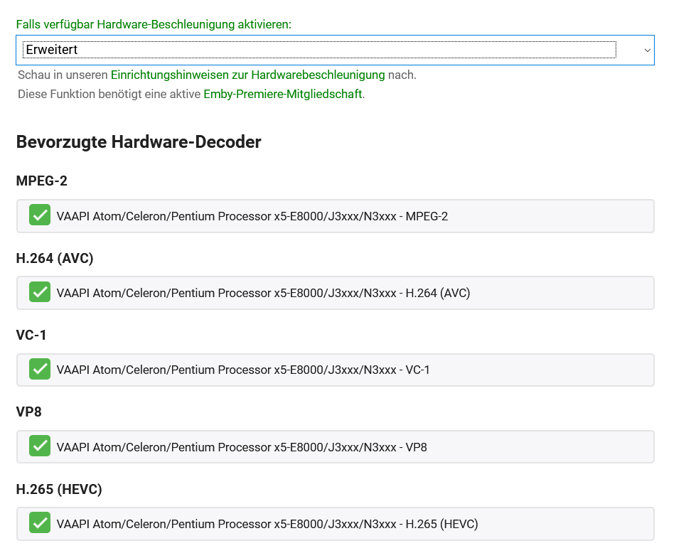

I am a new emby user and I am trying to enable hardware transcoding in emby. I have a emby premium plan.
Emby is running in a docker container on my DS416Play. I've forwarded the /dev/dri device into the container and ffdetect finds the device.
Unfortunately ffdetect says "IsEnabled=0" and there is not hardware transcoding offered in the webinterface

19056532_Bildschirmfoto2020-10-07um10_05_14.thumb.png.ef4fb0452488227b29a55669f125bd2b.png
But when I run emby as root inside the container (UID 0, GID 0) it is working:

Hi, I wouldn't pay much attention to IsEnabled because we ignore that on Synology. At the very least you will need to make sure the user it is running as is added to the video group. have you done that?
MisterDigit
Hello Luke,
thanks for the really fast answer. Probably you've missed some important detail in my description: I am running emby in a docker container on the DS416play
Ignoring the flag is not enabled in your docker package, only in the spk.
I've added "-ignore_vaapi_enabled_flag" in your docker container by modifying the start script /etc/services.d/emby-server/run:
s6-applyuidgid -U /system/EmbyServer \
    -programdata /config \
    -ffdetect /bin/ffdetect \
    -ffmpeg /bin/ffmpeg \
    -ffprobe /bin/ffprobe \
    -ignore_vaapi_enabled_flag \
    -restartexitcode 3
And yay, then it is working. But, of course, the change will be gone as soon as I update the container.
Anyhow possible that you add an option to enable this flag by setting some parameter in the docker environment ?

HI, that flag is only used in the Synology package, where it is specifically needed. It is not used in Docker. Ideally our Docker package could detect that it's on Synology and set the value, but that proved to be tricky. We'll have to see if there's a way we can allow this to be configured.
Thank you very much for looking into this!
  • Thanks 1
alucryd
We have a synology autodetection in place, but it looks like it might not work in your case. Could you run `uname -a` over SSH and post the output just to confirm, but I already see from the server log that it does not contain the token we're looking for.
alucryd
@Zoomer88Could you give the latest beta docker image a try? I added a `IGNORE_VAAPI_ENABLED_FLAG` env variable, setting it to the string `true` should pass the associated flag to emby.
  • Like 1
Hi, @alucryd! Thanks for looking into it. I've checked the knowledge base, download page and docker hub and can't seem to find the links to the beta container. Am I missing something? Could you please lead my hand to the one? On the docker hub I can only see those: https://registry.hub.docker.com/u/emby
The emby/embyserver was updated like a day ago, but this isn't a beta, right?
Sorry if those are stupid questions, I'm pretty new to emby :)
alucryd
No worries, you were on the right track, to get the beta docker you just need to pull the beta tag:
emby/embyserver:beta
