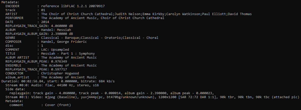

kkhan 16 Posted January 11, 2021 Posted January 11, 2021 I have noticed that on occasion emby assigns a spurious Album Artist to an Album. In the example below on the home screen, two Albums by "The Academy of Ancient Music" are being flagged as by an ensemble L'Arpegiatta. I have some albums by that ensemble elsewhere in the library. This appears to happen at random across the entire library but only occasionally. Rescanning or removing the album from the library, rescanning and then putting it back into the library does not resolve the issue. Maybe it is a database corruption issue? In which case maybe I can use a database editor to correct manually? From the example below, you can see that I am make sure all my tags are clean so I do not think it is a tagging conflict issue. In the past I have seen FLAC files with sometimes APE and VORBIS tags or ID3 and VORBIS tags so I make sure that all my FLACs have VORBIS tags, and MP3s and DSFs have ID3V2.3 only. Any advice or guidance would be welcome. Looking at one specific Album, in the detail view the same thing. The FFPROBE output shows that the Tag information is clean, for example for Track 2

PenkethBoy 2066 Posted January 11, 2021 Posted January 11, 2021 ok = looking at the ffmpeg output you dont have an AlbumArtist tag - so emby will default back to using the artist and as you have two..... Album Artist and Album_artist are not valid for emby - delete them and add in AlbumArtist and assuming nothing else is going on that should fix it the new music option in beta is even more strict as its only tag driven - so a good time to review and fix errors like this
kkhan 16 Posted January 12, 2021 Author Posted January 12, 2021 Thanks. Let me have a look at this. The tags are set by MediaMonkey so I will try a different tagger to see if that makes a difference. I will get back when I have done that. However, I am somewhat confused because an album which is correctly identified has exactly the same album artist tags as in the album causing problems (as the entire library is managed by MediaMonkey) as you can see below. The FFPROBE output for the first track Also MP3Tag reports the correct Tag. Maybe it is the additional "Album Artist" tag which governs how the tag is displayed is causing the problem. I will delete it and see if it solves the issue.
PenkethBoy 2066 Posted January 12, 2021 Posted January 12, 2021 dual artist tags not great idea - put both artist in one - IIRC ; can be used to separate them - dont use a , album artist is not used and redundant Use MusicBrainz Picard - much better as will be consistent with what emby expects
