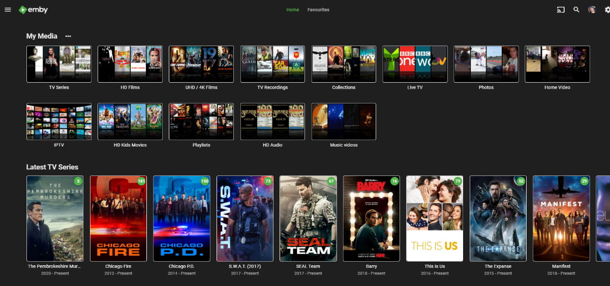

arrbee99 1712 Posted December 23, 2020 Posted December 23, 2020 Am wondering if anyone knows how to add a border around just the thumbs and posters on the home page, with a possible alternative to add them everywhere, like actors, more like this etc. It might look terrible would would like to try. I tried this but that makes the border too big and includes the text underneath - div.card { background: transparent; border-style: solid; border-width: 4px 4px 4px 4px; border-color: white; border-radius: 0.3rem; } am hoping to get it strictly round just the image. 1
Happy2Play 9441 Posted December 23, 2020 Posted December 23, 2020 (edited) 1 hour ago, arrbee99 said: add a border around just the thumbs and posters on the home page Like this limited to portrait and backdrop cards on Home Screen. Every type has its own card. div.homeSectionsContainer .portraitCard .cardScalable, div.homeSectionsContainer .backdropCard .cardScalable { background: transparent; border-style: solid; border-width: 4px 4px 4px 4px; border-color: white; border-radius: 0.3rem; } 1 hour ago, arrbee99 said: with a possible alternative to add them everywhere, like actors, more like this etc. All cards div.cardScalable { background: transparent; border-style: solid; border-width: 4px 4px 4px 4px; border-color: white; border-radius: 0.3rem; } Edited December 23, 2020 by Happy2Play 1

arrbee99 1712 Posted December 24, 2020 Author Posted December 24, 2020 (edited) I quite like this for now. Till I feel like a change anyway. I added smallBackdropCard, squareCard and fourThreeCard for the other rows. The only bug is these borders are on the outside and the highlight box is on the inside, so they don't overlap, as you can see with My Media > TV Edited December 24, 2020 by arrbee99
Happy2Play 9441 Posted December 24, 2020 Posted December 24, 2020 5 minutes ago, arrbee99 said: The only bug is these borders are on the outside and the highlight box is on the inside, so they don't overlap, as you can see with My Media > TV Are you sure it is not a issue with the image itself?
Happy2Play 9441 Posted December 24, 2020 Posted December 24, 2020 FYI home screen only all cards div.homeSectionsContainer .cardScalable 1
arrbee99 1712 Posted December 24, 2020 Author Posted December 24, 2020 As I'm sure you've noticed, I'm not sure of anything when it comes to css, but the plan was/is to have borders round stuff and when you hover over an item the border seamlessly changes colour to blue (its still white in that picture). Not a exactly a disaster, just seems bit weird that the border instructions are the same for the white permanent border as for the hover blue border, but they're in slightly different positions.
arrbee99 1712 Posted December 24, 2020 Author Posted December 24, 2020 5 minutes ago, Happy2Play said: FYI home screen only all cards div.homeSectionsContainer .cardScalable Thanks, does make it a bit shorter...

arrbee99 1712 Posted March 25, 2021 Author Posted March 25, 2021 (edited) Am playing with this again to see what it looks like with more rounded corners. With this (assuming I've copied the correct stuff) - add blue box when hovering - /* Remove Fade and Add Box to Focus Item */ div.cardOverlayContainer { background: transparent; border-style: solid; border-width: 6px 6px 6px 6px; border-color: var(--myblue); border-radius: 1.2rem; } and add white box round everything - /*Add Box to All Items on Movies TV etc */ div.cardScalable { background: transparent; border-style: solid; border-width: 4px 4px 4px 4px; border-color: white; border-radius: 1.5rem; } it seems to work in Firefox - but in Chrome its like the White border gets put underneath the image - so am wondering if there's a way to fix it up. Thanks. EDIT - btw the blue focus box works fine. Edited March 25, 2021 by arrbee99
Happy2Play 9441 Posted March 25, 2021 Posted March 25, 2021 @arrbee99 Hint add the same radius to the .cardScalable button But yes there are these quirks between browsers.
arrbee99 1712 Posted March 25, 2021 Author Posted March 25, 2021 Sorry. Am sure its obvious, but I can't get any cardScalable and button combo to work.

Happy2Play 9441 Posted March 26, 2021 Posted March 26, 2021 (edited) @arrbee99What issues are you having as all I did was add border-radius to button. /* Remove Fade and Add Box to Focus Item */ div.cardOverlayContainer { background: transparent; border-style: solid; border-width: 6px 6px 6px 6px; border-color: var(--myblue); border-radius: 1.2rem; } /*Add Box to All Items on Movies TV etc */ div.cardScalable { background: transparent; border-style: solid; border-width: 4px 4px 4px 4px; border-color: white; border-radius: 1.5rem; } div.cardScalable button { border-radius: 1.5rem; } Unless I am not understanding the issue as it corrects the issue you displayed above. Quote I can't code anything - its generally a matter of asking here or trying to spot something in the googleverse. Neither can I, learning from here and google also. But the way the image is layered in button on cardscaleable is the issue. But each browser seem to handle it differently. Edited March 26, 2021 by Happy2Play 1
arrbee99 1712 Posted March 26, 2021 Author Posted March 26, 2021 Thanks. That fixes it I think it was mainly it didn't occur to me to basically just add '<space>button'. I tried replacing div with button or had div.cardScalable-button and a few other things I've forgotten already. Obviously I'm much better at not being able to code than you are...
arrbee99 1712 Posted March 27, 2021 Author Posted March 27, 2021 It seems like this works fine in Firefox and Chrome - /* Remove Fade and Add Box to Focus Item */ div.cardOverlayContainer { background: transparent; border-style: solid; border-width: 6px 6px 6px 6px; border-color: var(--myblue); border-radius: 1.5rem; } /*Add Box to All Items on Movies TV etc */ div.cardScalable { background: transparent; border-style: solid; border-width: 4px 4px 4px 4px; border-color: white; border-radius: 1.8rem; } /*Get above to work in Chrome also*/ div.cardScalable button { border-radius: 1.5rem; } but it seemed to miss out rounded corners for images you get when looking at Edit Images and in the dashboard when an item was being played so that it had an actual image in an Active Devices box. It seems that this div.cardImageContainer { border-radius: 1.5rem; } fixes the images under Edit Images and helps with the Active Devices thing, but that still looks like this - Any thoughts please ?
Happy2Play 9441 Posted March 27, 2021 Posted March 27, 2021 6 minutes ago, arrbee99 said: It seems like this works fine in Firefox and Chrome - /* Remove Fade and Add Box to Focus Item */ div.cardOverlayContainer { background: transparent; border-style: solid; border-width: 6px 6px 6px 6px; border-color: var(--myblue); border-radius: 1.5rem; } /*Add Box to All Items on Movies TV etc */ div.cardScalable { background: transparent; border-style: solid; border-width: 4px 4px 4px 4px; border-color: white; border-radius: 1.8rem; } /*Get above to work in Chrome also*/ div.cardScalable button { border-radius: 1.5rem; } but it seemed to miss out rounded corners for images you get when looking at Edit Images and in the dashboard when an item was being played so that it had an actual image in an Active Devices box. It seems that this div.cardImageContainer { border-radius: 1.5rem; } fixes the images under Edit Images and helps with the Active Devices thing, but that still looks like this - Any thoughts please ? Well that is another layer being added/overlayed on the existing layer as the progress bar covers the unmodified box. Will do some testing shortly. 1
arrbee99 1712 Posted March 27, 2021 Author Posted March 27, 2021 Thanks. I couldn't decide if it was because of the progress bar, as you can see the white border gets covered up before it gets to the progress bar, but it doesn't take much to confuse me...
Happy2Play 9441 Posted March 27, 2021 Posted March 27, 2021 (edited) 28 minutes ago, arrbee99 said: Thanks. I couldn't decide if it was because of the progress bar, as you can see the white border gets covered up before it gets to the progress bar, but it doesn't take much to confuse me... Add this div.sessionNowPlayingContent { border-radius: 1.5rem; } Only issue maybe the beginning and the end of the progress bar being covered by your border. But you are talking seconds. Edited March 27, 2021 by Happy2Play
