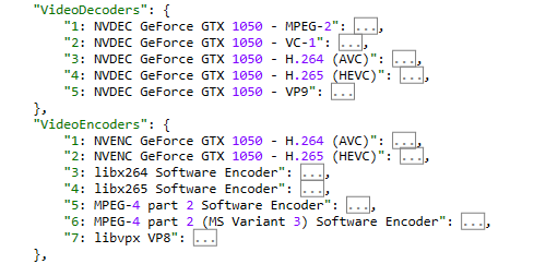

joydashy 3 Posted October 31, 2020 Author Posted October 31, 2020 Well, on host also not working. I do get different errors if that helps... hardware_detection-63739780928.txt
softworkz 4566 Posted October 31, 2020 Posted October 31, 2020 What are you talking about? All Nvidia codecs are perfectly detected:
joydashy 3 Posted October 31, 2020 Author Posted October 31, 2020 (edited) 9 minutes ago, softworkz said: What are you talking about? All Nvidia codecs are perfectly detected: My bad, I had not loaded my Premier key on the host installation yet... it works now. So the issue appears to be related to the container, that's good to know at least. Edited October 31, 2020 by softworkz 1
