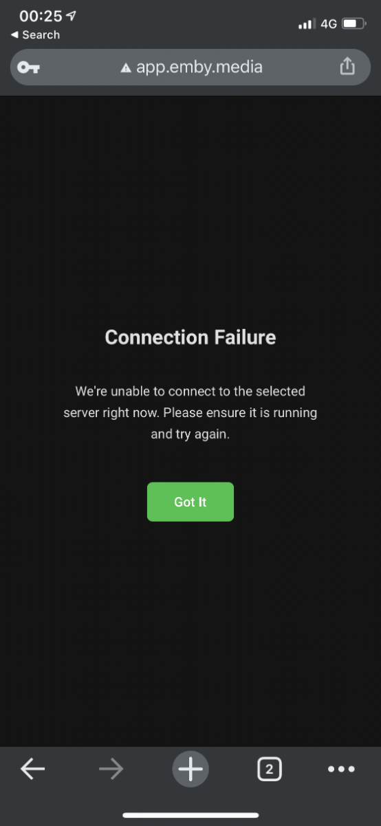

lshack 0 Posted December 14, 2020 Posted December 14, 2020 Hi Carlo @cayars, I seem to have a similar problem where I can't connect externally to the embly. When I try login with the web browser on my phone with the wifi off I can see the below screen. When I click on the "ShackiMac" server, the connection fails. I have followed all the advice above, so I think it could be a port issue too. Unfortunately I don't have the expertise to check this. Can you help? Thanks Lance
Carlo 4552 Posted December 14, 2020 Posted December 14, 2020 Hi, if you like setup a new user "Carlo" with access to one library which can be a test library with just an item or two in it. Send me a PM with your server info to connect to and the test account info. I can then try a test connection and see if I can connect and playback media. Based on that test I can let you know if I have any connection problems and we can take it from there either via PM, here in the forum or maybe a remote session depending on need and what I find. We can certainly try to help you, but let's start with the above, unless you have a preferred method of choice for help. Just let us know.
