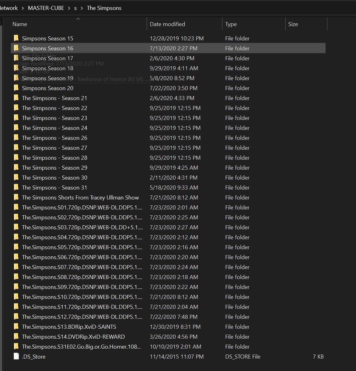

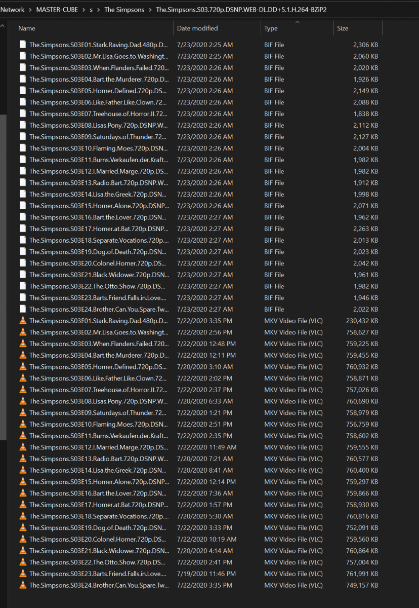

disworld 5 Posted July 22, 2020 Posted July 22, 2020 (edited) Good Afternoon everyone, I have added a season to my library, Emby tags all the shows correctly, but only ads a few to my library. I have already: Checked for (stable) updates Re-started the server. Re-Scanned: Season Show Library. Copied away, Deleted via emby & Copied back the files same files are found, same metatdata applied Not sure what else to try, so here I am. Screenshot: Left Metadata Manager Season 3, Episodes 1-24 found and tagged Episode 2 details shown Right GUI: Season 3 Episodes 6, 16, 22-24 are only episodes showing. Edited July 22, 2020 by disworld Annotate screenshot

Carlo 4552 Posted July 24, 2020 Posted July 24, 2020 (edited) Can you give us a screen capture of what this show looks like on disc? Edited July 24, 2020 by cayars
disworld 5 Posted July 24, 2020 Author Posted July 24, 2020 Like this? (Also, The other seasons were added after the 1st screen shot, the only issue is with 2 & 3. The other 1-12 are the same file structure and loaded alright. )
Carlo 4552 Posted July 24, 2020 Posted July 24, 2020 First thing I'd suggest is to clean that up so you follow naming guidelines. Learn to use a tool like filebot that will take the chore out of managing folders and files. Here's are recommended guidelines on TV Show naming: https://support.emby.media/support/solutions/articles/44001159110-tv-naming
disworld 5 Posted July 24, 2020 Author Posted July 24, 2020 (edited) What should they be changed to? They're all already The.Simpsons.S00E00.... All the metadata in the .nfo files was created correctly by emby, but the files weren't registered into the GUI, all the other 100+ files loaded okay Edited July 24, 2020 by disworld
Carlo 4552 Posted July 24, 2020 Posted July 24, 2020 Look at your naming convention and then look at the knowledge base. Start by looking at folder names, then file names.
disworld 5 Posted July 24, 2020 Author Posted July 24, 2020 (edited) Okay, I just tried Shortening the name of one episode that would not appear in the season from The.Simpsons.S02E01.Bart.Gets.an.F.720p.DSNP.WEB-DL.DDP5.1.H.264-MZABI to The.Simpsons.S02E01 Deleted all meta-files and re-scanned the library Once again, an nfo file was generated by EMBY with the correct episode data Once again, the Metadata Manager shows the episode Once again, The GUI of the season still does not show the episode. The folder and file names are already in-line with the naming conventions in the link you shared. All other 10 seasons and 222 files using the same convention loaded okay and every episode loaded in the Metadata manager. The files are 'found' but not appearing where it matters. Edited July 24, 2020 by disworld
