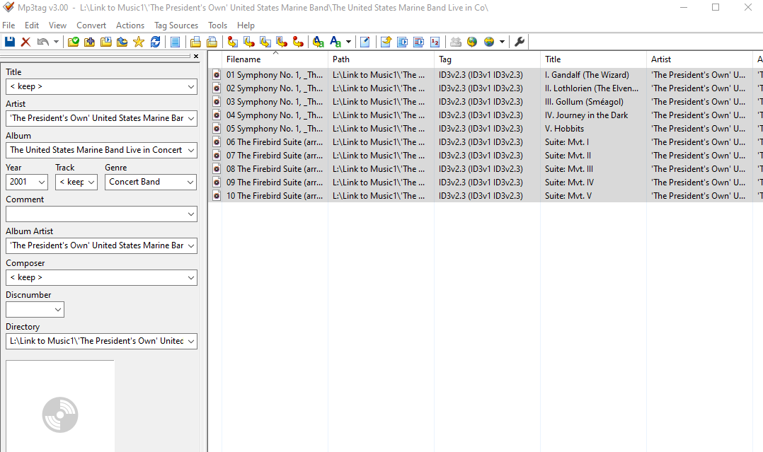

I'm struggling with artists being randomly assigned to some of my albums.  They are either all from 'The President's Own' United States Marine Band, or most of them are from that artist.  Within my music directory for Emby every artist has their own folder and there are no music files that aren't in a folder.  There are a few random albums in the main directory that aren't nested under an artist (I hope to fix that in the future).  In the first image below, note that the artist for each of the albums should be listed as 'The President's Own' United States Marine Band (that's the folder they are in, and the Artist and Album Artist are both listed as 'The President's Own' United States Marine Band within the metadata (that's what the other two images show).  Joshua Redman is listed as the artist for two of the albums, but he isn't, and he also isn't the composer.  Joshua Redman has his own folder and has 4 albums in the folder, none of which is these albums.  I selected Joshua Redman as the Artist within Emby and found that he has many albums, from various artists, that were incorrectly assigned to him (see 4th image).  Richard Wagner is a similar story, except that he doesn't have his own folder.  Wagner is a composer for some of the "songs" on some of my albums, but not that one.

If you nuked the library.db and disabled or removed the MusicBrainz plugin and are still getting these id, then they would have to be in metadata within the folder or embedded in the album tracks.
Ideally you would need to use ffprobe to read the info from the tracks as that is what Emby uses.  I believe you have to look at extended tags in mp3tag to see musicbrainz tags if tagged.

I'm trying to clear that data and then "refresh metadata" and "Scan Library Files" in Emby to see what happens.  If needed, I'll delete the library.db file again after this.  I'm using mp3tag under extended tags, then deleting that data (with the 'x" on the right of the menu).  I'll post again after I find out if it works.  Thanks for your advice.

Also in mp3tag if you click on the individual tracks (extended tags) do they show any musicbrainz tags?  I have only did some testing with mp3tag so I don't know all the ins and outs of clearing multi-track tags.  I use MusicBrainz Picard and will edit the tags there if needed.

I've already deleted the library and am starting fresh.  It takes a while, but I'm not using anything on Emby right now, so it's not a huge deal.  Since I blank-deleted the Musicbrainz tags from the Marine Band stuff, I checked a track from Joshua Redman and found that he does have tags from musicbrainz.  Since I used Musicbrainz Picard to do a lot of the tagging for me, I'm not surprised.  I remember having trouble with the Marine Band albums in Picard, so I think I switched over to MP3tag and manually tagged them after trying to auto-tag a few, which might explain the inconsistency.  If this solves the problem, I guess I know what to do with any problems like it in the future.
