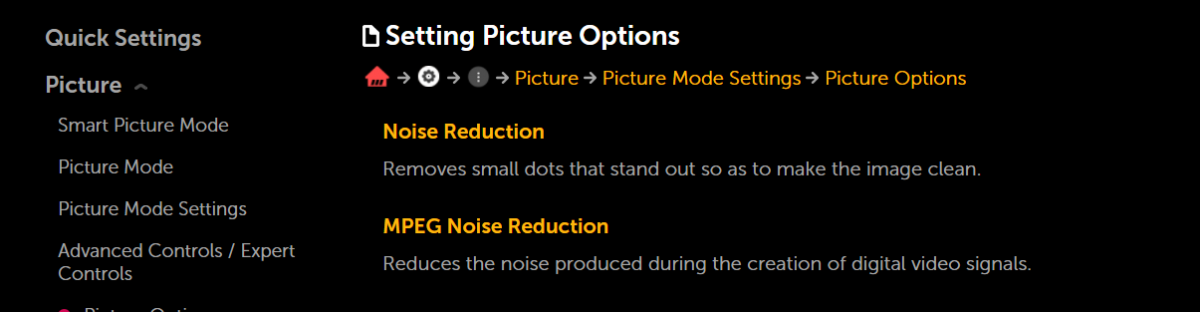

Guest kovibalko Posted November 2, 2020 Posted November 2, 2020 Hi! Eventually it turned out what the problem was: I took back the noise reduction in the TV picture setting - and the blur was gone :) Thanks to everyone!
SamES 996 Posted November 2, 2020 Posted November 2, 2020 11 minutes ago, kovibalko said: Hi! Eventually it turned out what the problem was: I took back the noise reduction in the TV picture setting - and the blur was gone Thanks to everyone! Thanks for the feedback. That's amazing that noise reduction caused the picture to look so bad for you. I'll try and keep that in mind for others to try,
rbjtech 4931 Posted November 2, 2020 Posted November 2, 2020 (edited) 1 hour ago, kovibalko said: Hi! Eventually it turned out what the problem was: I took back the noise reduction in the TV picture setting - and the blur was gone Thanks to everyone! A useful reminder - thanks. I'm pretty sure the default for an HDMI source is either off or low.  NR is meant for low quality digital OAC broadcasts (where it does actually help), but with a direct digital HDMI profile (remember you get independent settings for EACH HDMI source), all it will do is blur the image - did you maybe set it to high thinking it would improve the picture ? For 1080p/4K sources, turn it all off - the source should not need extra post processing Edited November 2, 2020 by rbjtech
Guest kovibalko Posted November 2, 2020 Posted November 2, 2020 I turned off the settings shown in the attached image to resolve the blur (noise and mpeg noise)  What does it mean: "I'm pretty sure the default for an HDMI source is either off or low." where can i set this up at all?
