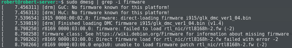

softworkz 4566 Posted June 25, 2020 Posted June 25, 2020 OK, thanks. It appears to be an issue with the installed graphics driver and what we are delivering. Could you please show the output of 'vainfo' and post the hardware detection log?
RobertDi 0 Posted June 28, 2020 Author Posted June 28, 2020 (edited) Edited June 28, 2020 by RobertDi
RobertDi 0 Posted June 28, 2020 Author Posted June 28, 2020 I have tried backports and newest kernel without success - will try with latest ubuntu server instead and let you know the reuslt
