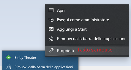

crazy4emby 1 Posted December 6, 2023 Posted December 6, 2023 (edited) Switching this to minimized for me worked. It actually does open the window and you can see it, fullscreen. Right click on the file to get the properties. Edited December 6, 2023 by crazy4emby 1
