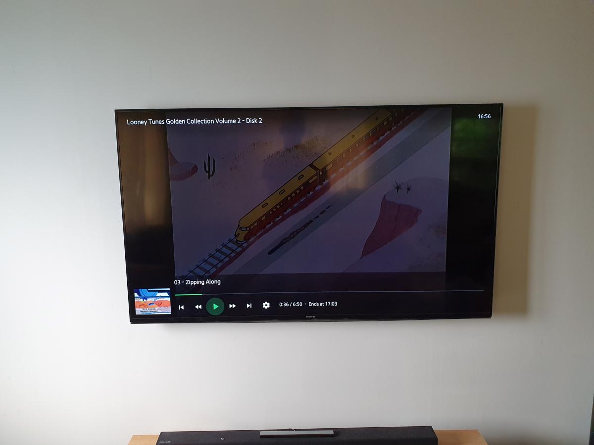

supergeek 4 Posted June 7, 2019 Posted June 7, 2019 HI Long time user, first time poster. First off I love Emby and have been using it for many years but I've had one bug that I just can't figure out. Whenever we use the shuffle feature for a TV series the first episode will play perfect and the remaining episodes will be faded. It looks as though the next episode overlay is always on. I've turned off themes and the next episode info option but still the issue remains. Emby Server v4.1.1.0 Samsung App v1.0.61 TV Model: ua55j6200 Cheers Super Geek embyserver.txt ffmpeg-transcode-04a577ff-faf5-4d51-b68f-f6a7a1428791_1.txt hardware_detection-63695579166.txt

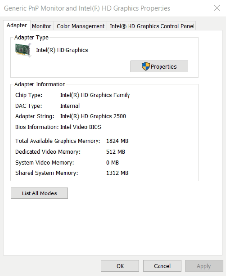

supergeek 4 Posted June 17, 2019 Author Posted June 17, 2019 Sorry link must've died; https://ufile.io/nresm5al I've attached my display adapter properties and transcoding settings for reference.
Luke 40083 Posted June 17, 2019 Posted June 17, 2019 Can you take a picture of this, before and after?
FrostByte 5257 Posted June 17, 2019 Posted June 17, 2019 Okay, I got the episode and copied it four times and clicked shuffle and did not see the problem. It direct played every time without the shadow. Preview was on. My transcode settings are similar, but I'm on a Synology NAS and use VAAPI so not exactly the same. It shouldn't really matter though because the file doesn't need transcoding and direct plays every time. Is the file you posted one of the files which you had problems with? Does it transcode? Just that it isn't one of the ones in your logs. Looking at the specs of your TV it should be able to DP this episode also https://developer.samsung.com/tv/develop/specifications/media-specifications/2015-tv-video-specifications Could you take a screen shot of the mediainfo for one of the two shows in your log above and post it? It might be easier if I had the data for the file which matched your logs.
