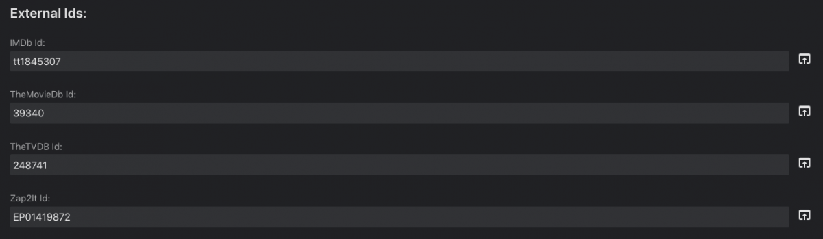

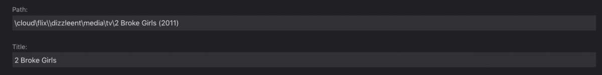

Have you verified the IDs are actually identical?
Can we see the two Emby items in the metadata manager that shows their paths and the IDs so maybe we can spot something?
Thanks.
schmitty
Local Library:
Cloud Library:
