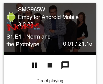

slicedmass 2 Posted February 2, 2019 Author Posted February 2, 2019 Well I just connected to my server via my phone while on LTE and started playing a file, dashboard says Direct Play but I highly doubt Emby is not involved.

slicedmass 2 Posted February 2, 2019 Author Posted February 2, 2019 That can't be entirely correct considering I just tested via LTE to my https external Emby server and it says on the dashboard it is direct playing when according to that page it should say im direct streaming. I can also see in resource manager the emby server pushing the exact speed that the file is in mbps.

slicedmass 2 Posted February 2, 2019 Author Posted February 2, 2019 I just tried it, Connected to LTE, starting playing video (showed Direct Playing) killed the emby service and about 20-30 seconds later the video froze. Maybe try on ur end again but see if it eventually kills out if you let it keep playing.
ebr 15670 Posted February 2, 2019 Posted February 2, 2019 Whether what Happy is describing works depends on the app in use. If it is one of the HTPC apps (like Theater desktop) then he is correct. For pretty much all other apps, the server is feeding the file directly to the app. But, again, in this case, the server simply responds to requests from the app for data. It has no ability to "push" more to the app than it has requested. It really sounds to me like you simply have an overloaded mechanical disc in these situations. 1
