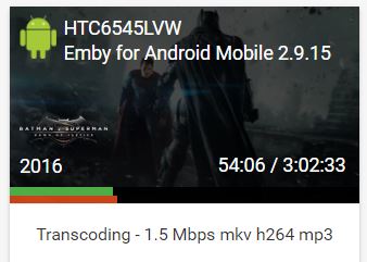

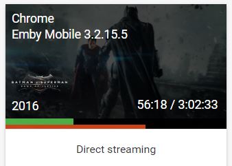

The red bar indicates how much of the file has been converted and the green bar indicates your present position in the video.
This is when the server has some involvement. The reasons for this are:
  • The audio is not supported by the player (codec, frequency, etc). In this case, the server will demux the file, adjust the audio, remux the file and stream it to the player with no change to the video
  • The container isn't supported by the player (MKV, AVI, MP4 etc). In this case, the server will demux the file and remux it in a supported container, with no change to the audio or video.
  • The player does not have direct access to the file and the server has to 'serve' it over http, to give the player access. In this case, nothing is changed if the player supports the file properties.

Transcoding:
This is when the server has to transcode/change the video, but not always the audio.  Reasons for this are:
  • Your network doesn't have enough bandwidth to stream the file. This often occurs when using a mobile device on the mobile network. An example would be if your movie has a bitrate of 10 Mb/s but your internet connection has less than that. The server will run an initial bandwidth check and then transcode the file to a bitrate that will be supported.
  • The player doesn't support the video codec (h264, h265, XVID etc). The server will then transcode it to a supported codec.
  • If you have subtitles burnt into the video (there is an option for this, in the sever)

The problem is no one will pay attention to the different colors or know what they mean and with the single word "Transcoding" there, some people will freak out and post out here that Plex is "Direct Streaming" the same item that Emby is transcoding when they are actually doing
I think they would pay attention. I know I only pay attention when I see red that is, which in my example is truly worst case scenario. Everything else is just "nice to know" info. If everything works, you shouldn't worry. If you want to optimize, then it's easy to do without checking your logs.
Please answer this @ebr : What does "Direct" stand for in direct stream? It's near impossible to understand the term direct stream.
Direct stream, to me, means playing the file as-is via a stream. The term "direct" stream is even more meaningless if you include light modifications. In fact, it makes it anything but direct.
Transcode by definition is the file being modified. That's why I believe my solution is the best long term strategy. And I mean this, in the nicest way :)
You guys have the last word, but you are better than Plex, therefore don't let them limit you.
Speaking as a user: We just want to be given the right information, in a quick way that's simple to understand. Direct stream is not informative because it could easily be direct playing from the server OR transcoding the file lightly that has almost no effect on the CPU.
Edited by Angelblue05, 04 July 2017 - 12:00 AM.
