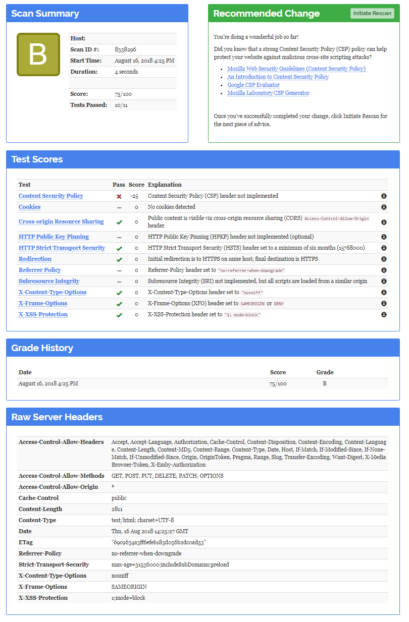

makarai 108 Posted August 16, 2018 Posted August 16, 2018 (edited) Hi hi, This is my report with haproxy instead of nginx, i guess i have to fix some stuff. However @@pir8radio, would you mind doing this again so i can check if i set all the correct headers, also can you let me know what you set for the CSP For other HAproxy users: .. outdated What i noticed is CORS differs as well Content is visible via cross-origin resource sharing (CORS) files or headers, but is restricted to specific domains Edited September 18, 2018 by makarai
makarai 108 Posted August 17, 2018 Posted August 17, 2018 (edited) in the meantime i achieved also A+ and a working emby with the following front end settings: I moved all headers to the ssl frontend #...outdated Edited September 18, 2018 by makarai 1
pir8radio 1305 Posted August 18, 2018 Author Posted August 18, 2018 (edited) Hi hi, This is my report with haproxy instead of nginx, i guess i have to fix some stuff. However @@pir8radio, would you mind doing this again so i can check if i set all the correct headers, also can you let me know what you set for the CSP For other HAproxy users: http-response set-header X-Frame-Options SAMEORIGIN http-response set-header X-XSS-Protection "1;mode=block" http-response set-header Referrer-Policy "no-referrer,same-origin,strict-origin,strict-origin-when-cross-origin" http-response set-header X-Content-Type-Options nosniff http-response set-header Strict-Transport-Security max-age=31536000;includeSubDomains;preload What i noticed is CORS differs as well Content is visible via cross-origin resource sharing (CORS) files or headers, but is restricted to specific domains Yours, looks good, I actually stole some of your settings, and combined with mine.. I now have this: same score as my initial test but hey... add_header Content-Security-Policy "default-src 'self' https://*.mydomain.net wss://*.mysomain.net https://www.gstatic.com https://www.github.com; base-uri 'none'; form-action 'self'; frame-ancestors 'self'; object-src 'none'; script-src 'sha256-bdnU7HNzra4Qmlo30dpjygO1RLIIqRVu1wcOsl0OWqU=' https://*.mydomain.net https://www.gstatic.com; img-src data: https: ; style-src 'unsafe-inline' https://*.mydomain.net" always; Edited August 18, 2018 by pir8radio 1
