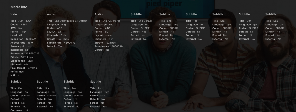

shocker 104 Posted March 6, 2018 Author Share Posted March 6, 2018 Sorry for the late response, I've performed multiple tests with multiple Samsung Tizen TV's on 1.0.37 in order to find a pattern. Please find below my findings: Found a TV Show with only one sub: - EN, internal, non-forced: OK for all episodes/all seasons. Found another TV Show with multiple subtitles: - EN, internal, non-forced: Not OK - EN, internal, forced: Not OK - EN, external, non-forced: Not OK - Other languages, internal, external, non-forced: Not OK. repeated the test for 10-20 random episodes from random shows with multiple subtitles and I had the same result, it's not working. As users reported that > 90% of the subtitles are not loaded and since there is also the "duplicate subtitle bug" on this release I was thinking that it might be an issue when there are multiple subtitles. Found another item with only one subtitle, external this time (rum, external, non-forced), is not working, performed this test for 5 different movies with online one sub, external and I had the same result, it's not working. Trying to find an item with only one internal subtitle, non-forced, to repeat the test to see if only those subtitles are working. Can anyone perform this test as well and provide feedback? Thanks! Link to comment Share on other sites More sharing options...

shocker 104 Posted March 7, 2018 Author Share Posted March 7, 2018 Can you please describe this a little more? If you have multiple subtitles for a movie and start the movie, let's say with english subtitle, going to the "CC" button on screen and change the language to French or any other language is not doing anything. There is a loading meniu but the subtitle is still running with english language. Link to comment Share on other sites More sharing options...
