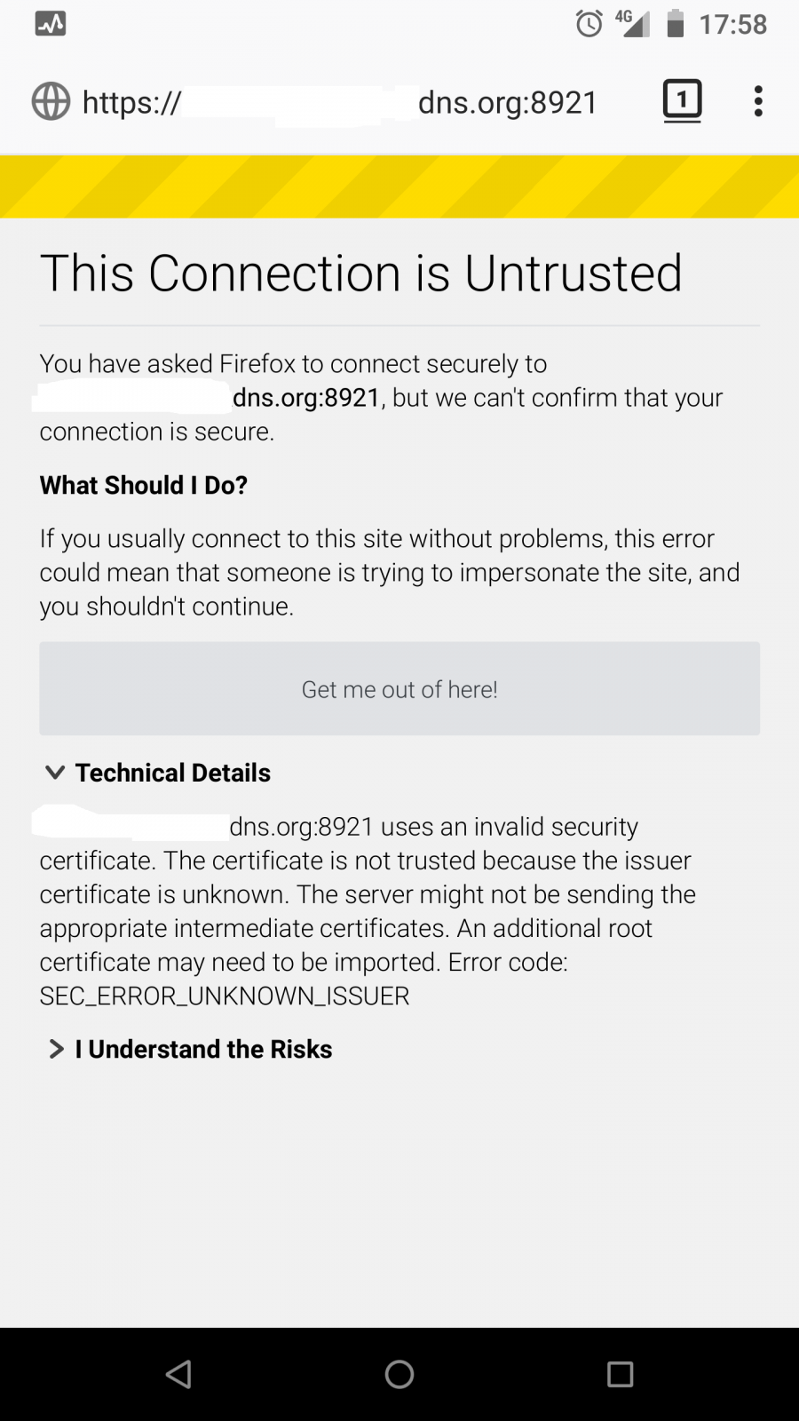

After updating embyserver to dotnetcore on my unraid server I got som problems when connecting to my embyserver web page.
Problem only happens when the browser has newer seen my certificate before. If I connect to another site eg port https://mydomain:443 insted of https://mydomain:8920 and back to 8920 it says everything is secure.
But if the first time I connect is to emby server i get site not trusted certificate error. So its important to delete all appdata for browser on each try. I'm doing this by uninstall/install firefox on my android phone.

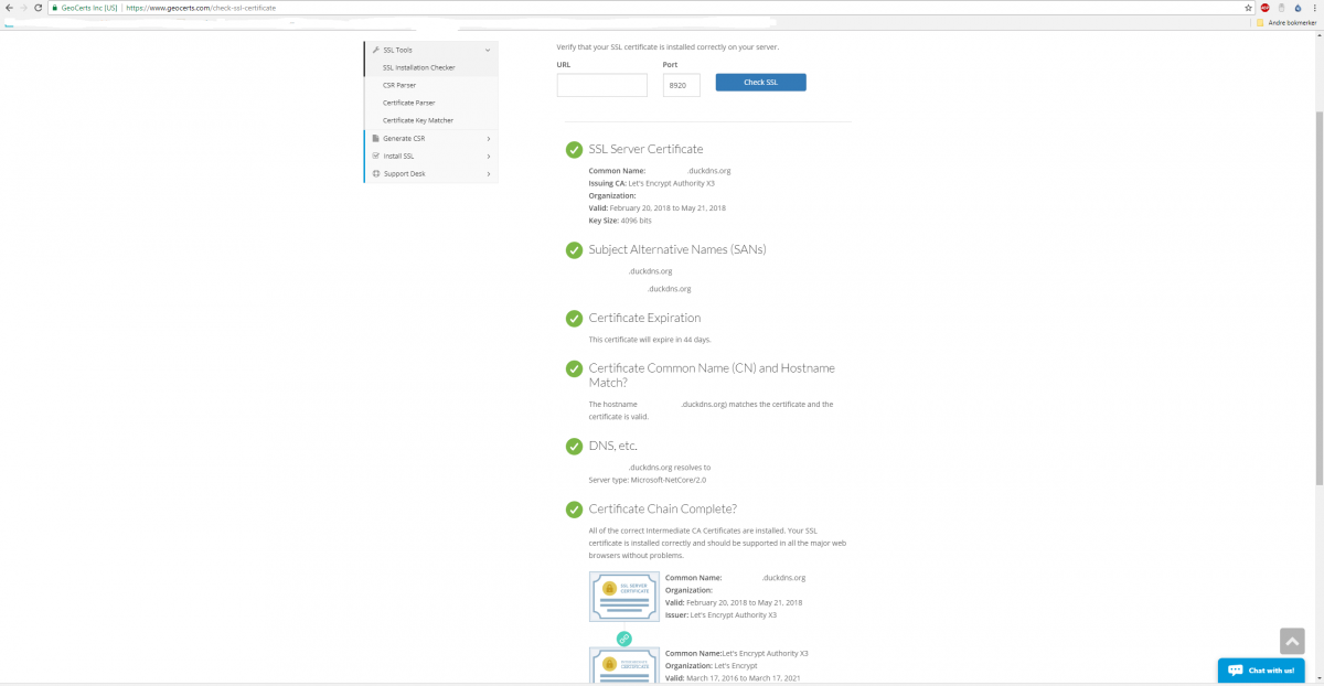

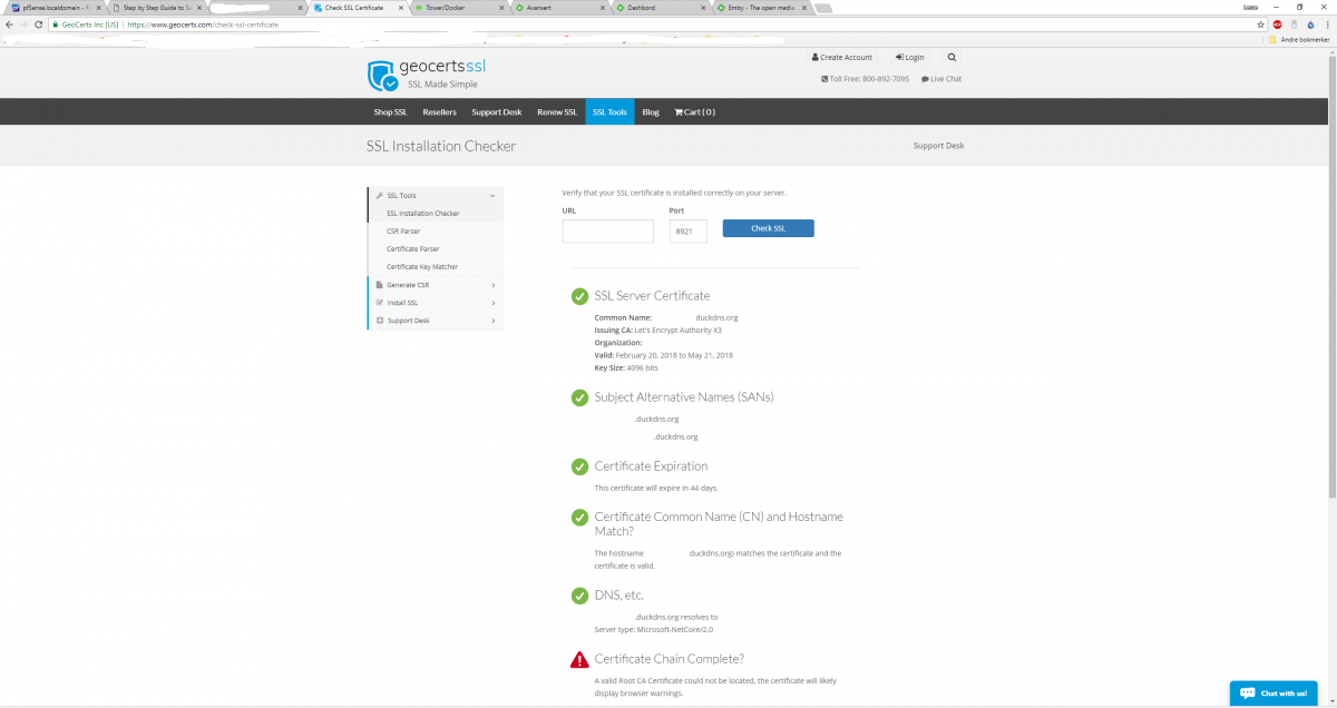

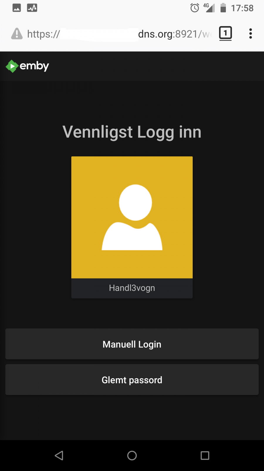

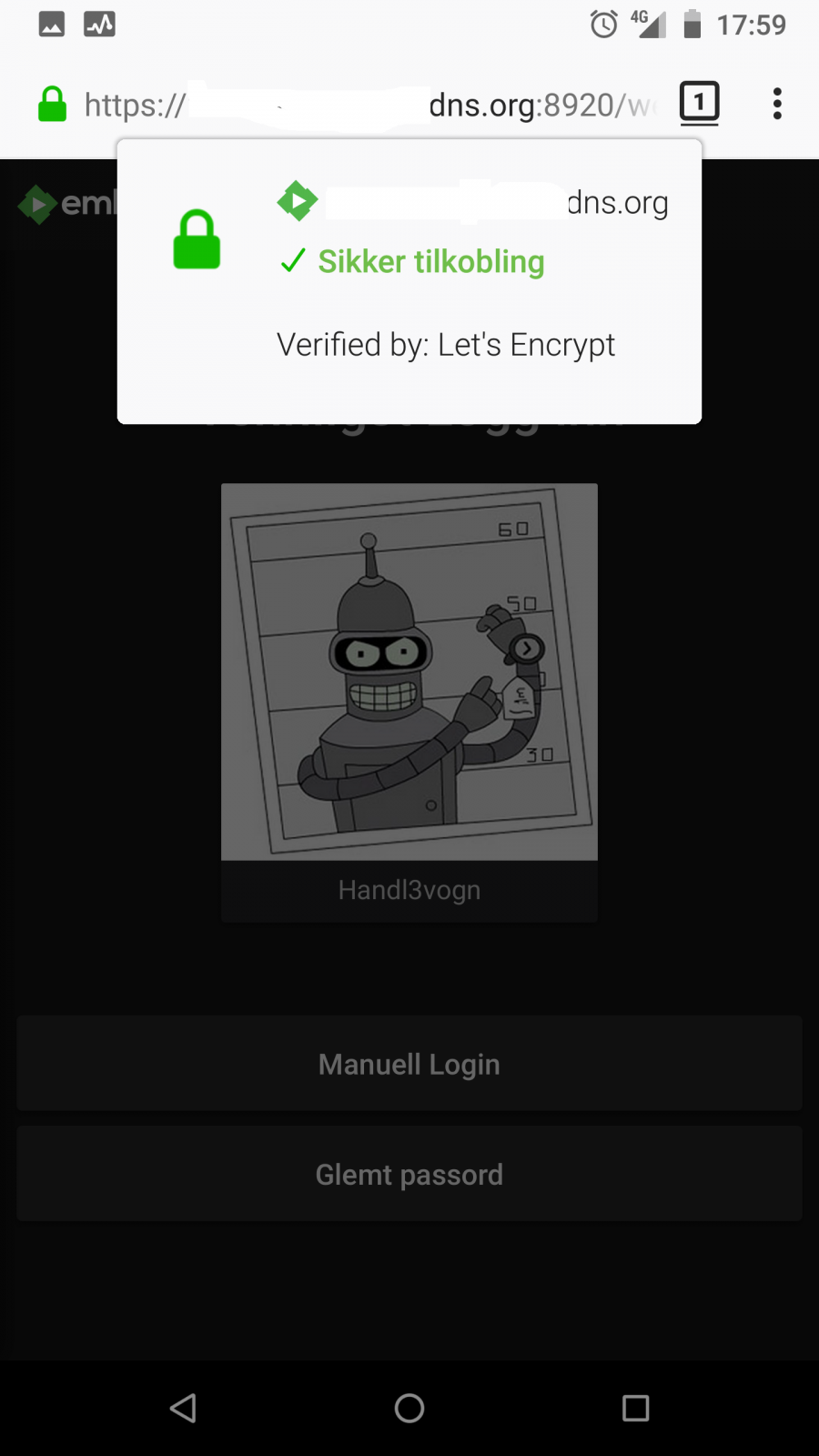

Here are som pictures maybe these will help.
port 8920 is running Versjon 3.2.60.0 mono docker
port 8921 is running Versjon 3.2.60.0 dotnetcore docker
Same Certification file is used on both servers.
Edited by Handl3vogn

Tried again using the official emby docker versjon 3.2.70 and still get the certificate error in browser.

Did a ssl test https://www.geocerts.com/check-ssl-certificate
And got these results (see screens)
