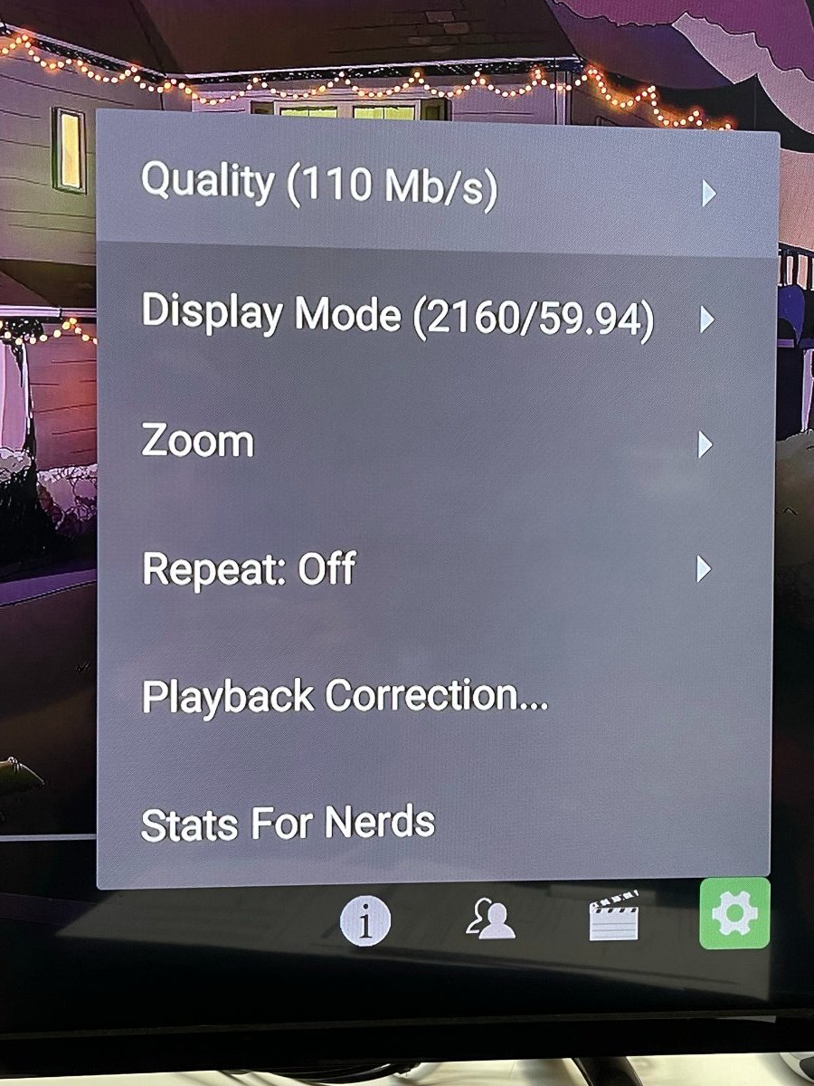

I’m on an Android device (NVidia Shield) and it appears that after the recent app update the ability to adjust playback speed has been removed.
Was this intentional? Is it coming back? It’s 100% of the reason why I subscribed, so I’m really disappointed the feature has been taken away.

MortigiTempo
6 hours ago, ebr said:
Hi.  Why do you think it has been removed?
The feature is missing now. I've been using it regularly, and yesterday it was gone. I tried six different videos (most of which I've used fast speed on before), the option to adjust the speed appeared on only 1 of the 6.
In the Google App store it shows that Emby for Android TV was updated recently. I'm not sure how to see the specific update information, but I can see a small blurb that says "What's new: Improved playback support Many improvements for the upcoming 4.6 server r..." and then it cuts off. Emby says it's version 2.0.09g.
It works fine on my iPhone.
Edited by MortigiTempo
Can you please show me the stats for nerds for that same playback?
Okay, that item is bitstreaming a compressed audio track (DD+) so speed changes are not possible when doing that (there is no way to adjust the speed of the audio).
I have discovered one issue where the app is too restrictive and also won't let you change speed when locally decoding an encoded track like that.  That issue will be corrected in the next release but won't help in this particular case.
Could you clarify this?
Just to make sure this is clear, the specific video I've been troubleshooting with was working with speed playback days ago. It's not a new video. Same video. Same audio track. Emby was playing it at faster speeds without issue. I've been playing videos with these DD+ audio tracks for months at faster speeds without issue and the audio has been adjusted without any noticeable problems. Emby on my iPhone is still playing the video at faster speeds without issue, despite the video being DD+.
If I'm understanding you correctly and changing the speed of a video with a DD+ audio track is not possible. At the same time I've apparently been doing just that for months on an almost daily basis. I can currently do it on my iPhone. I'm just trying to figure out what changed and more importantly how can I make it work again.
The key is the speed cannot be changed when bitstreaming those formats.  This is because the audio is being delivered to an outboard device in a compressed format so the speed cannot be altered except by the device that is decoding that format.
Forcing the transcode to stereo should have allowed you to get the speed menu back.  Can you do that again and show me the stats for nerds?
