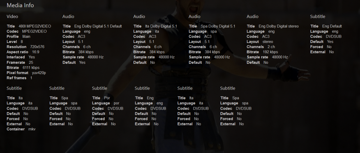

bigembyfan 54 Posted September 1, 2018 Posted September 1, 2018 (edited) I got it setup ok, it loads well and looks great on my tv, I added the mpg2 licence to the Pi (Raspbian) and that says it's enabled. One main issue is nothing will play, I get the loader on all videos (selecting the mkv versions, or pre-encoded mp4 versions and also tried a .ts recording). I have to esc + esc + esc to eventually exit the app and try again. The app itself looks great, initially a few images didn't load but on next view everything seems there and it's more than responsive enough. I have attached some debug logs attempting to play Indiana Jones. I have double tested it works using the web client over my remote url and also from Firefox on a linux machine on the same network as my Mac Mini server (connecting over local IP to 192.168.0.3 like the Pi is). Might be worth noting on the Pi itself I get a message like "fs access result for path: Error: ENOENT: no such file or directory access" - searching the forum there's another user that had that but Luke you said that wasn't an issue, just an attempt to play it directly or something like that. Ideally I'd use the Mac Mini to transcode by default to the Pi and just have the Pi act like a lazy client with as little load as possible (which I'm sure it does). emby-logs.txt Edited September 1, 2018 by bigembyfan
bigembyfan 54 Posted September 1, 2018 Posted September 1, 2018 (edited) I should add, I've tried via Chromium which works but the UI is pretty jittery (compared with the smoothness of emby theatre) and the playback works but is also stuttery. Chromium has the cast to my Bravia option which works perfectly so as a temporary solution that's what I will use. I also tried the video setting in the emby theatre app to; auto, rpi and rpi copyback. None of the options lead to being able to play a video. Would be great to get videos playing in emby theatre, I'm excited to get that going as my always on emby client attached to my main TV. Edited September 1, 2018 by bigembyfan

tdiguy 97 Posted September 5, 2018 Posted September 5, 2018 A little note about the video player, we are using OmxPlayer, which is included with Raspian. Omxplayer does not support software MPEG2 video playback, to enable MPEG2 playback you will need an MPEG2 codec key to unlock the MPEG2 hardware decoder. http://www.raspberrypi.com/ Currently we don't have any detection for this, so the app will always try to direct play mpeg2, and without a hardware decoder key it will fail. I forget the command but there is a command on the pi that will respond with a yes or no for hardware acceleration. Sent from my moto g(6) play using Tapatalk
bigembyfan 54 Posted September 5, 2018 Posted September 5, 2018 (edited) I'm really struggling with this spinning loader / no playback in ET (3.0.2) on my Pi, I've spent a few evenings trying to get something to play, anything, but nothing will start, it just stays on the spinner. This happens for all file types; mkv, mp4 and mp3 audio books. Direct Play It should have access to direct play via nfs that I've setup on the Mac server, when I view 'showmount -e 192.168.0.3' (where 192.168.0.3 is my Mac Emby server), I see the folder on the Mac that contains all the media. I can mount to the Movies folder for example: mount -t nfs 192.168.0.3:/Volumes/MyMedia/Emby/Movies/ /mnt/movies/ Browsing to /mnt/movies/ then successfully lists all the movie folders and files I have on my server so the connection works. In the Library setup on the Emby Server, for movies folder as an example, I added the optional network path of all the three below and none of them seems to be working: nfs://192.168.0.3/Volumes/MyMedia/Emby/Movies nfs://192.168.0.3:/Volumes/MyMedia/Emby/Movies /mnt/movies Streaming I thought if the direct play access had any issues then ET on the Pi would revert to streaming instead and streaming works from Chromium on the web player on the Pi (although a bit stuttery) and from every other device I connect externally or internally so again I'm not sure what the issue is there. If I try to connect to my remote url for the Mac in ET on the Pi (ie using a secure domain rather than the local 192.168.0.3 IP that ET automatically finds), exactly the same spinner + no video result happens. ---------------------- My Server is up to date and Emby Premiere is active. Looking through the debug logs I see unknown profile messages for movies, like the below: 'Info App: Profile: Unknown Profile, Path: nfs://192.168.0.3/Volumes/MyMedia/Emby/Movies/Old School (2003)/Old School (2003).mkv' Do I need to configure anything more on the Pi in ET? I use Auto almost throughout but have changed the Video type to RPI and RPI Copyback to see if that changed anything. I've also run emby-theatre as root and it didn't help, just needed me to login again.After leaving the spinner go for a long while eventually I do get a "Playback Error" - "No compatible streams are currently available" message, I hadn't seen these before. I have attached some file info for some of the movies I've tried to play on the Pi. I'm stumped, any help would really be appreciated. embyserver.txt Edited September 5, 2018 by bigembyfan
