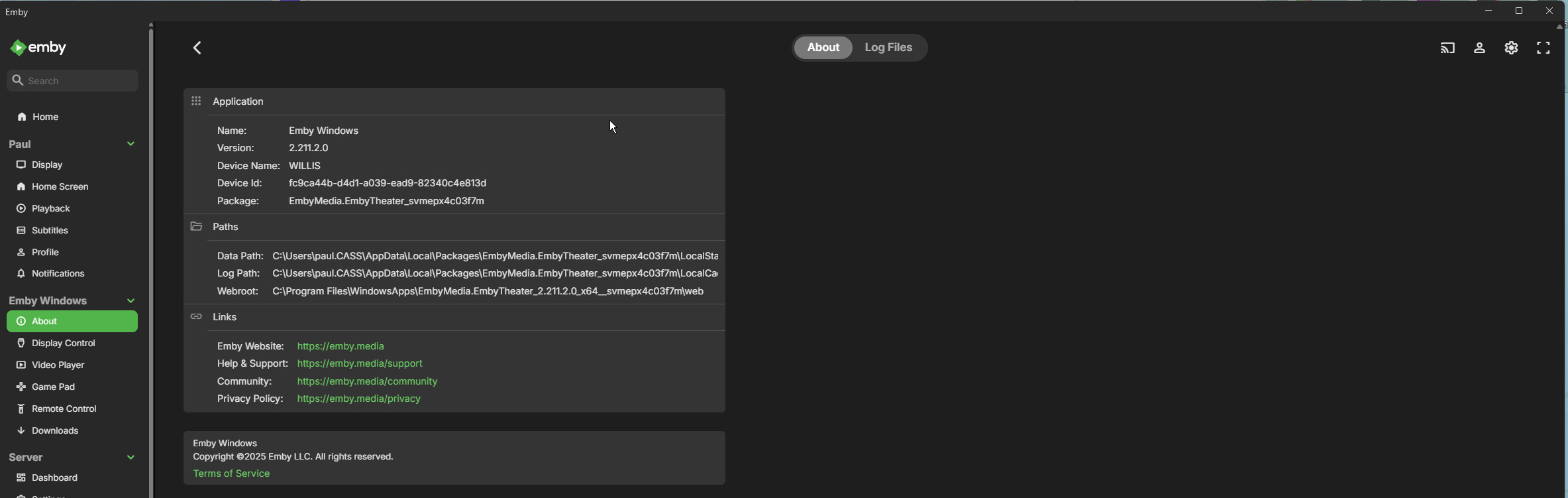

softworkz 4570 Posted February 3 Posted February 3 3 hours ago, pwhodges said: There are loads of Emby.Theatre entries in the registry, and they are created on install. If the client isn't using them, it must be Windows Store. The client stores all of its local settings under the "AppData" tree (exact path visible on the "About" page). Windows store doesn't play any role in how the app is working. The app is not depending on the store (which is essentially just another store app). The store only cares about updating, but the app would also run on a machine where the MS store is not even installed. 3 hours ago, pwhodges said: Since this problem arose on updating the driver, when the A380 is being used for the desktop, then (a) Emby client doesn't work, and (b) independently, if I RDP out to another machine (e.g. the server running Emby server, when I am updating it), then there is a black screen for 15 seconds before the remote screen is shown. I have not observed either of these effects without the other being simultaneously present. Okay, then it's pretty unlikely related to the app at all. 4 hours ago, pwhodges said: Anyway, following your suggestion, I now have the desktop running from the onboard, with Emby and RDSP both working perfectly, and HandBrake is using the GPU for AV1 encoding (though it seems a little slower than before for some reason). Possibly the primary graphics adapter gets priority for memory transfers. 4 hours ago, pwhodges said: So everything is fine for now. Glad to hear that!
pwhodges 1857 Posted February 3 Author Posted February 3 30 minutes ago, softworkz said: (exact path visible on the "About" page). Well, part of it anyway!
softworkz 4570 Posted February 3 Posted February 3 2 hours ago, pwhodges said: Well, part of it anyway! Your user name is too long
davidb7170 21 Posted February 4 Posted February 4 7 hours ago, pwhodges said: Well, part of it anyway! I found mine went over the display space as well, so I highlighted the text and copied to notepad, then it was all viewable...
