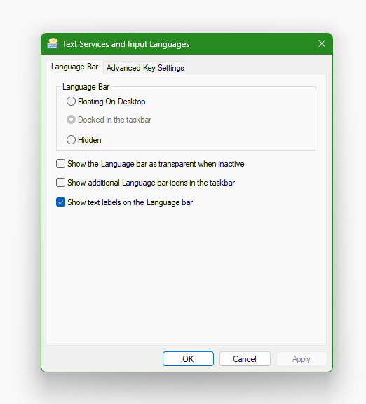

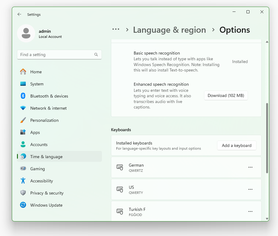

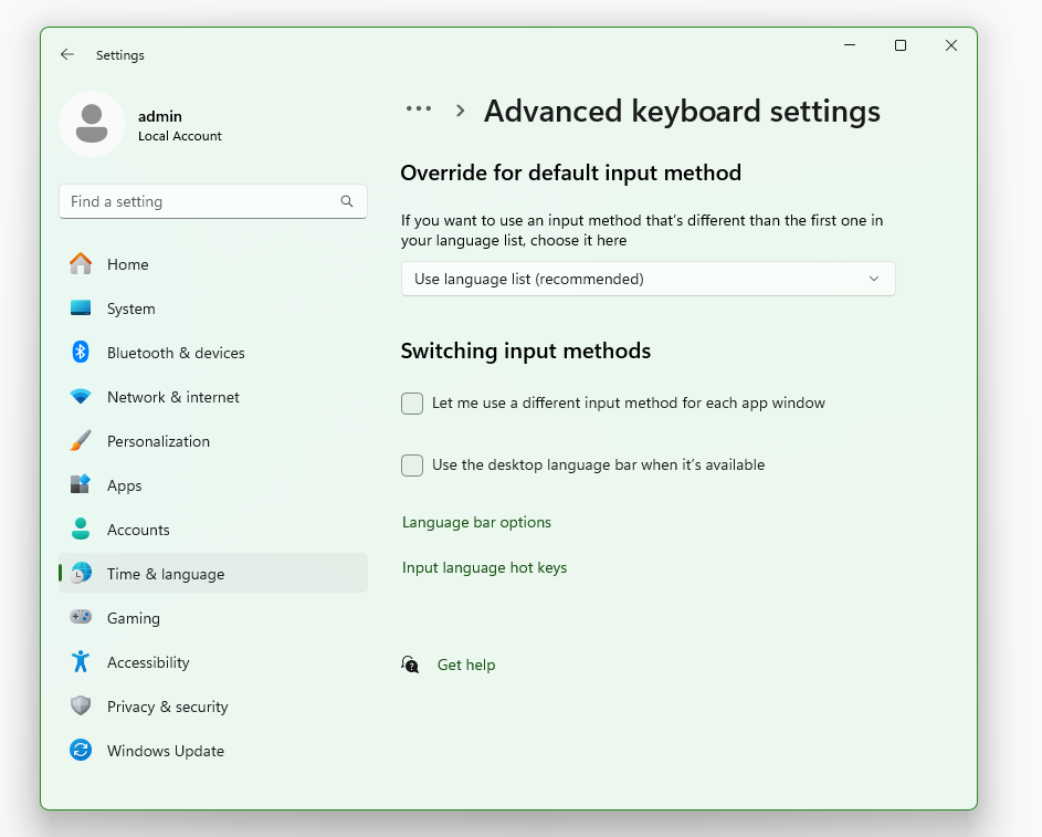

softworkz 4566 Posted February 2 Posted February 2 On 1/31/2025 at 1:36 PM, pwhodges said: PROBLEM 1: I had not taken note of the new Windows client for some reason, so I have been continuing to use the excellent Electron-based Theatre client. Today I discovered that this client is the cause of an apparently unrelated problem - after I start the Electron-based client, the \ and ` keys on my Perixx keyboard get swapped, and the PrtSc triggers my SCP client. Perixx support are unaware of any way in which this can happen, and the only way to get the keys right again is a full OS restart (or just living with the keys swapped...). (I suspect this is something to do with Electron itself rather than Emby.) You are saying the keys get swapped not only while using the Electron app but at the OS-level, even when the app is stopped? Have you gone through Windows language options? I have multiple keyboard layouts installed, and there are some key combinations which automatically switch it. There's also the option to switch keyboard layout per app, maybe that's configured and it doesn't switch back?

pwhodges 1855 Posted February 2 Author Posted February 2 1: Nothing to do with OS options - the changes are too bizarre; and yes, once changed, it remains until the next hardware reset (reboot). But don't worry - I'll not run the electron version again (I uninstalled it as a test, and now can't download it anyway). 2: Where are the logs for this client? Paul
