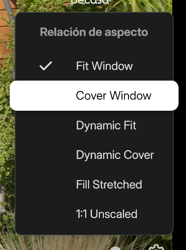

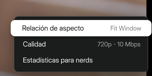

Lalico 1 Posted January 25 Posted January 25 Hello everyone, first of all, I want to say that I love this program so much that I bought Premiere... I would like to know if there's a way to set the "aspect ratio" adjustment to a default value of my choice. Having to change it for every video is tedious, and if I don't, it doesn't make full use of my screen. Thank you very much.

generiq 258 Posted January 26 Posted January 26 (edited) 4 hours ago, Lalico said: Hello everyone, first of all, I want to say that I love this program so much that I bought Premiere... I would like to know if there's a way to set the "aspect ratio" adjustment to a default value of my choice. Having to change it for every video is tedious, and if I don't, it doesn't make full use of my screen. Thank you very much. This would require --video-aspect-override, resulting in the change of the frame dimension (stretching or squashing) Or do you simply mean you want your choice to persist for every video? Like an option at the player level like with subtitles Edited January 26 by generiq 1

generiq 258 Posted January 26 Posted January 26 6 minutes ago, Mahinepua said: This script might do what I’m explaining. https://www.heimkinoverein.de/forum/thread/22736-mpv-autocrop-script-v2/ How do I run scripts in MPV? You want the dynamic options. That link, is this:
generiq 258 Posted January 26 Posted January 26 11 minutes ago, Mahinepua said: How do I run scripts in MPV? Put it in the scripts folder

generiq 258 Posted January 26 Posted January 26 5 hours ago, Lalico said: Hello everyone, first of all, I want to say that I love this program so much that I bought Premiere... I would like to know if there's a way to set the "aspect ratio" adjustment to a default value of my choice. Having to change it for every video is tedious, and if I don't, it doesn't make full use of my screen. Thank you very much. If persistence is what you're looking for, add your support for the request here: https://emby.media/community/index.php?/topic/76147-force-aspect-ratio-persistent-user-playback-setting/ 1 1
softworkz 4569 Posted January 26 Posted January 26 1 hour ago, Mahinepua said: Sounds like dynamic cover is the setting to try. I’ll try the latest autocrop2 script also. Mine is better than autocrop 1

softworkz 4569 Posted January 26 Posted January 26 12 hours ago, Mahinepua said: Do I need to set a custom resolution of 3840 x 1634 to make dynamic cover work with a 2.35:1 screen? The dynamic crop feature aims to address all cases where the regular "Auto" fit mode would lead to have black bars at both top-bottom and left-right, depending on the current video output area. It works dynamically and follows resizing of the app in windowed mode. In full-screen mode, it's the same: It eliminates black bars, so you have them either at top-bottom or left-right - but not both. The resolution of the screen is the reference for this, as it is taken as the output area of your display. If your display resolution is not representing the desired output area, then yes - you need to change it. 12 hours ago, Mahinepua said: I think the autocrop script can do this without changing resolution by setting the 'canvas/screen format' instead. This is what I was referring to in my post above by limiting the vertical video height to an aspect of 2.35:1 on a 16x9 screen then zooming out when a 16x9 frame is detected to fit the reduced height. The autocrop script has various modes of operation, but by default it aims to "detect" the aspect ratio of the content video and then locks in to it. You can also define this up-front (or define a number of possible ratios from which it should try to choose one. On the way to detect this, it can switch around a number of times until "it is sure" about it. You can also configure it to keep switching dynamically, but this is always delayed (until "it is sure") and the switching can be quite annoying. The dynamic crop feature in the Emby Windows app works differently: It is configuration-free It doesn't try to lock-in to a certain aspect ratio and always adapts dynamically It dynamically adapts to the current output window size Adaption is happening INSTANTLY, it doesn't have any delay, waiting "to be sure" This is made possible by additional image analysis and plausibility checks When you want to compare, try a movie with lots of ratio changes (e.g. 'Oppenheimer')
