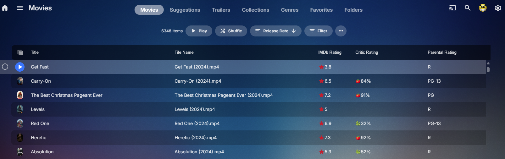

Happy2Play 9441 Posted December 25, 2024 Posted December 25, 2024 3 hours ago, RLanger7228 said: Is there a way to search Emby for the actual file names, instead of the titles they may be recognized as? No not that I know of. The most you can do is change to table view, enable filename column and compare title to filename. Otherwise, a database guru would have to come up with a query to compare them. 1

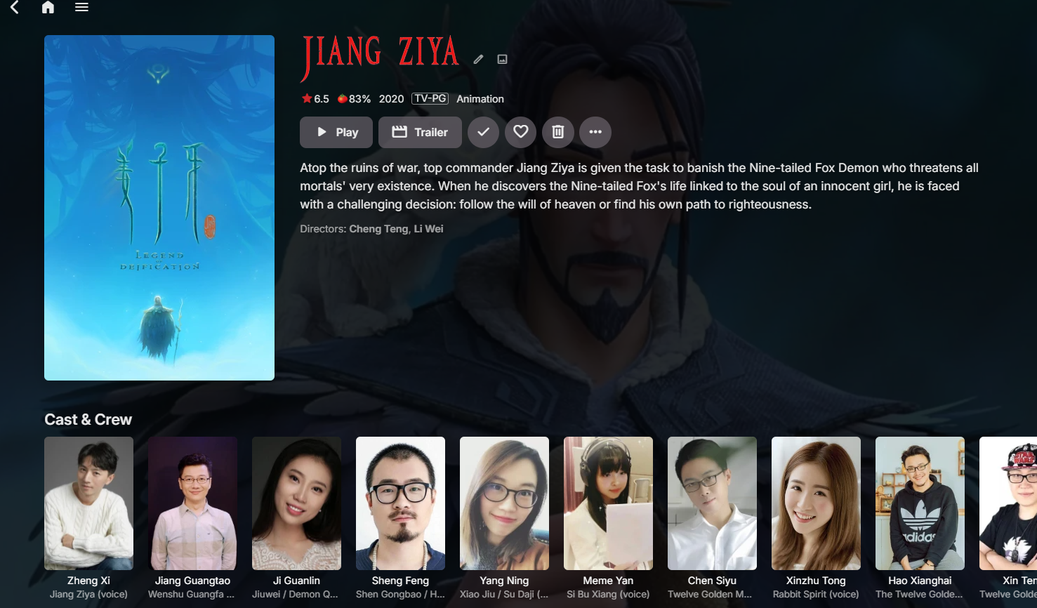

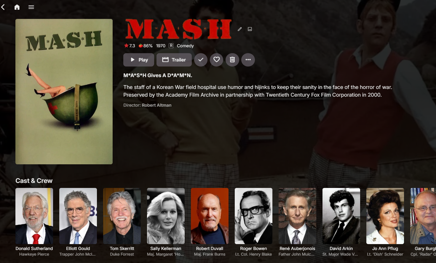

Neminem 886 Posted December 28, 2024 Posted December 28, 2024 1) MASH (1970) is this it M*A*S*H (1970) — The Movie Database (TMDB) Try calling it Folder : MASH (1970) {TmdbId-651} Video : MASH (1970) {TmdbId-651}.mkv 2) Jiang Zia (2020) is this it Legend of Deification (2020) — The Movie Database (TMDB) Folder : Jiang Ziya (2020) {TmdbId-635389} Video : Jiang Ziya (2020) {TmdbId-635389}.mkv 1

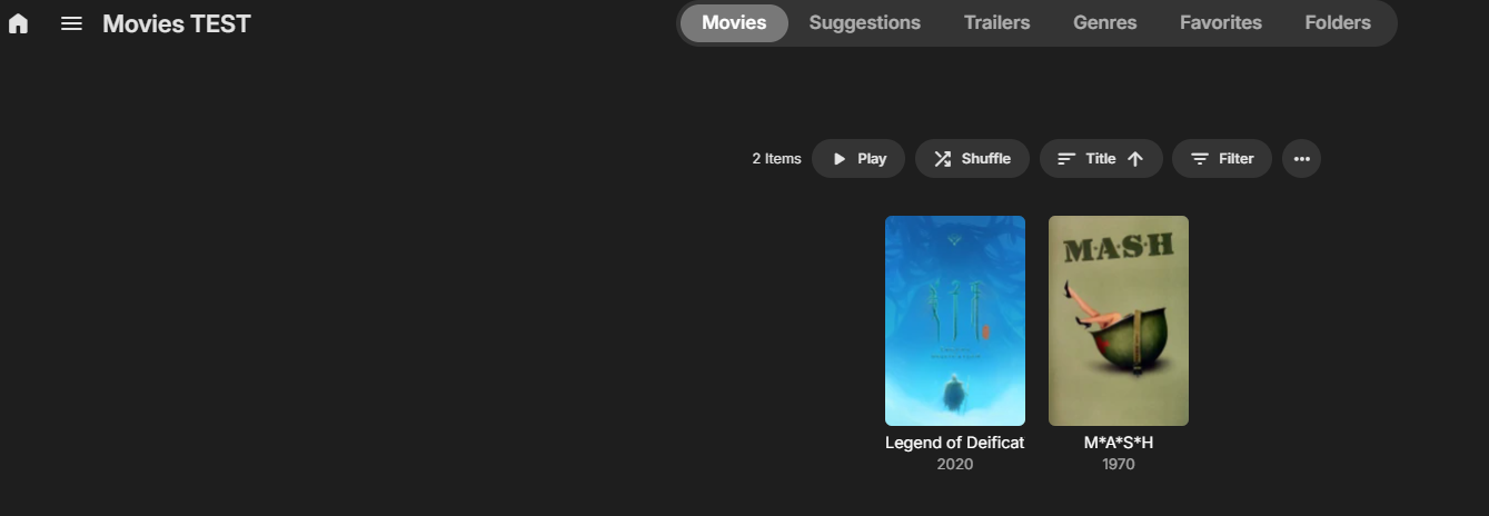

RLanger7228 56 Posted December 28, 2024 Author Posted December 28, 2024 @NeminemOK. I added the ID # to the file name for Jiang Zia, as you recommended. I don't normally keep each movie in a separate folder & have over 2000 movies that added to the single movie folder without problems. However, as an experiment, I made a separate folder for MASH using the naming convention you recommended above. Neither were automatically acknowledged in Recents, nor were they acknowledged after a library re-scan. This is quite frustrating! Usually, a movie is at least acknowledged by Emby & displayed as SOMETHING, even if mis-identified. These don't seem to be acknowledged at all. In responding to another issue, in a discussion with another user, I scanned my log file, and I saw references that showed the movies were being deleted from the database. If they are being deleted, then they must have been added at some point. If they were added (and deleted when removed from the indexed folder) why are they not being displayed? I am uploading the log file in case it might be helpful. embyserver - 2024-12-28 - 3-20PM.txt

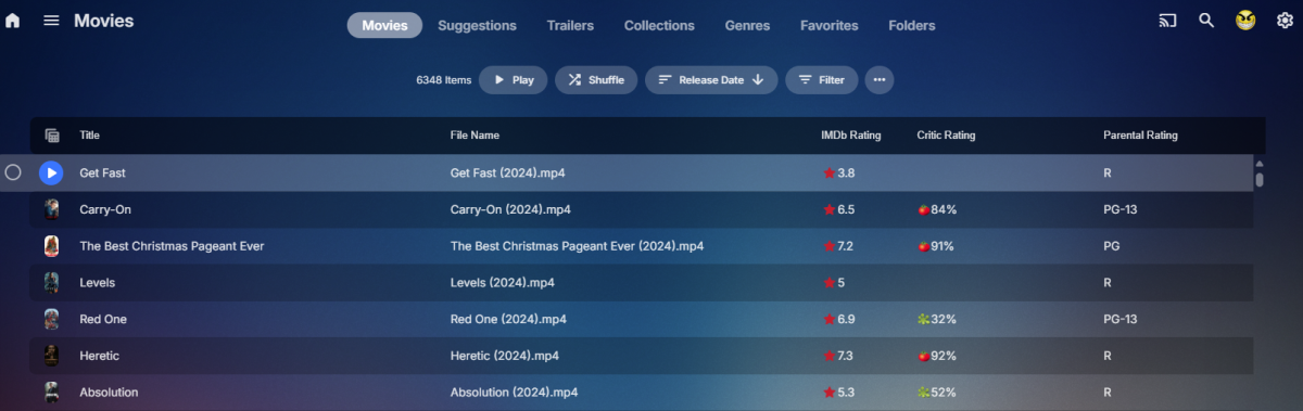

Luke 40074 Posted December 28, 2024 Posted December 28, 2024 I'm sure they were recognized, but possibly as something else. For example, looking at your first log: 2024-12-24 13:19:53.827 Info LibraryMonitor: Legend of Deification (/volume1/video/All Other Movies/Jiang Zia.mp4) will be refreshed. So we can see that this title was recognized as Legend of Deification. One helpful tool at your disposal is to view the library using table view, and then add the filename column. You can even sort on it. This will help you find it quickly. 2

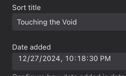

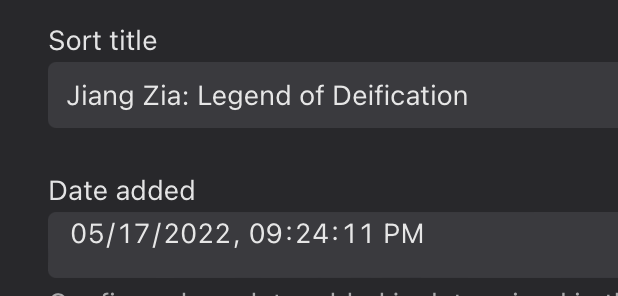

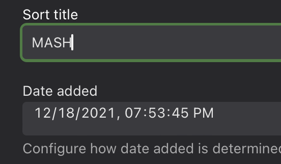

RLanger7228 56 Posted December 29, 2024 Author Posted December 29, 2024 Actually, I hadn't even looked at the Date Added at all. I assumed it was not changed when it didn't appear under Recents on the home page or at the top of the movies list when sorted by Date Added. However, at your suggestion, I went to the metadata of both movies I couldn't find before & the new movie I added as a "control" & took screen shots of the added date. The new movie has yesterday's date, but the 2 other movies still have older dates - which would keep them from showing up in Recents. Theoretically, this should not be an ongoing problem: How many times will I need to delete & re-add a movie? However, this may represent a "bug" and might be worth having the programmers take a look into it. Another suggestion: The title of MASH is "officially" M*A*S*H, but I set the SORT title to just MASH. MASH could not could not be found using Search, which suggests that SEARCH only looks at the official title. Do you think it might be valuable to include the SORT title in the search function? (BTW, I think it's brilliant that you offer a sort title field in the metadata). BTW, The user with the INOTIFY solution was FrostByte, not JackFrost (my error. It sucks to get older).
RLanger7228 56 Posted December 29, 2024 Author Posted December 29, 2024 I think I found the answer to my question (which would obviate the need to explore for a bug): As I was looking at the screenshots I sent, I noticed that below the Date Added it said I could configure the way Date Added is determined. When I went to the Library Settings, I saw that I could choose Date File Created OR Date Scanned into Library. Of course, I had Date Created selected. I originally selected that because I added about 1800 movies when I transitioned to Emby from Video Station, and wanted the original date added order to be preserved. I didn't think about that when dealing with this issue. Once again, my error was based on an incorrect assumption. Sorry to have taken up so much of your time for my mistake(s), but thank you for pointing out the error of my ways. 1
