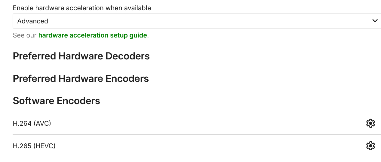

thekingpin 23 Posted November 23, 2024 Posted November 23, 2024 (edited) Hello I am running into this issue again that the GPU is recognised by Emby but the options for hardware transcoding are not showing. This issue was previously fixed with Version 4.8.10.0 but appears to be happening again. Just to be clear, Passthrough available (non-NVIDIA) is selected from TrueNAS. Hardware logs attached: hardware_detection-63867970936.txt Edited November 23, 2024 by thekingpin Added screenshot of issue.

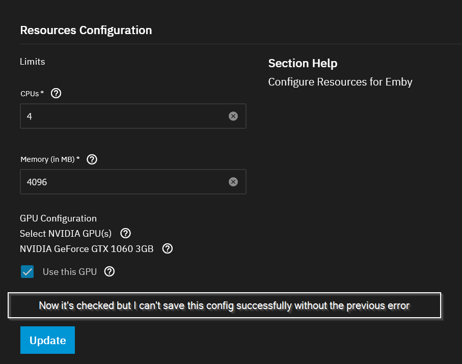

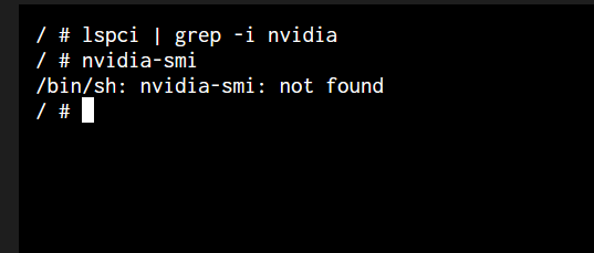

tech37 8 Posted March 7 Posted March 7 In a similar boat but no luck yet - when I check "Use this GPU" from the Emby app settings in TrueNAS, I get the attached error messages talking about the UUID not being set. However, when I manually set the GPU UUID in /mnt/.ix-apps/app_configs/emby/versions/1.2.17/user_config.yaml, it still doesn't appear in Emby, and when I try to check the box afterward, it clears the UUID field again. Have tried changing the Emby app group ID to both video (44) and render (107), as well as add the emby 'apps' user to both groups, but no dice as of yet. From within the container shell it has /dev but not /dev/dri, so not sure if it's an issue with the docker-compose.yml setup itself? This thread is one of the closest to my issue that I've seen so thought I'd try here Any help appreciated! truenas_use_gpu_error.txt user_config.yaml
thekingpin 23 Posted March 7 Author Posted March 7 44 minutes ago, tech37 said: In a similar boat but no luck yet - when I check "Use this GPU" from the Emby app settings in TrueNAS, I get the attached error messages talking about the UUID not being set. However, when I manually set the GPU UUID in /mnt/.ix-apps/app_configs/emby/versions/1.2.17/user_config.yaml, it still doesn't appear in Emby, and when I try to check the box afterward, it clears the UUID field again. Have tried changing the Emby app group ID to both video (44) and render (107), as well as add the emby 'apps' user to both groups, but no dice as of yet. From within the container shell it has /dev but not /dev/dri, so not sure if it's an issue with the docker-compose.yml setup itself? This thread is one of the closest to my issue that I've seen so thought I'd try here Any help appreciated! truenas_use_gpu_error.txt 7.31 kB · 0 downloads user_config.yaml 2.96 kB · 0 downloads I don't think you can paasthrough a NVIdia GPU to containers in Scale. At least that option is not available directly when editing the container from the GUI (Electric eel) You can only passthrough non-nvidia

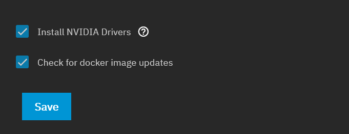

tech37 8 Posted March 7 Posted March 7 5 minutes ago, thekingpin said: I don't think you can paasthrough a NVIdia GPU to containers in Scale. At least that option is not available directly when editing the container from the GUI (Electric eel) You can only passthrough non-nvidia I would have thought that too, except scale has an option to install nvidia drivers and enable support, and other containers like immich have played with it nicely f
thekingpin 23 Posted March 7 Author Posted March 7 3 minutes ago, tech37 said: I would have thought that too, except scale has an option to install nvidia drivers and enable support, and other containers like immich have played with it nicely f I think this is the previous release of truenas, those options have changed in latest release. I would not edit the configs manually either and stick to GUI. What UID and GUI have you set for the container?
thekingpin 23 Posted March 7 Author Posted March 7 On second thought, have you tried stopping immich which is currently using the GPU. I think there was something in the previous TrueNas that you can only passthrough the GPU to a single container and not multiple at the same time.

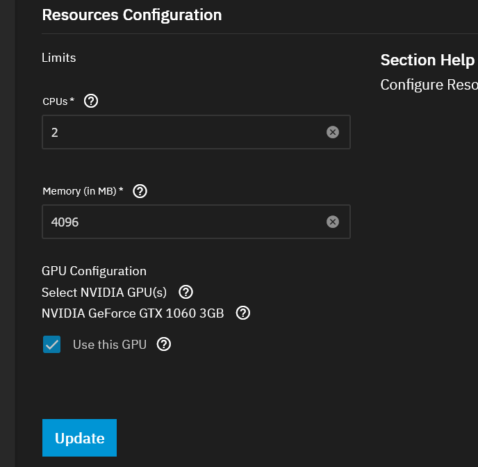

tech37 8 Posted March 8 Posted March 8 (edited) On 3/7/2025 at 12:05 PM, thekingpin said: On second thought, have you tried stopping immich which is currently using the GPU. I think there was something in the previous TrueNas that you can only passthrough the GPU to a single container and not multiple at the same time. Hmm I actually had both Immich and Nextcloud 'using this GPU', but I disabled them anyway, and then the 'use this gpu' did get checked for the Emby container/app, even though it still didn't show anything in the Transcoding section or in the container shell. Still got the same error when trying to hit 'update' on the app while the checkbox was configured, and no change after turning the app container off and on Am I missing something obvious? Edited March 8 by tech37
thekingpin 23 Posted March 8 Author Posted March 8 17 minutes ago, tech37 said: Am I missing something obvious? I don't think so, but, from what your previous reply said, you edited the config manually: GPU UUID in /mnt/.ix-apps/app_configs/emby/versions/1.2.17/user_config.yaml I would suggest not doing that. The error shows something wrong with the config. Quickest fix is probably: Take a backup of emby and reinstall the container without manually editing the config. 2
tech37 8 Posted March 8 Posted March 8 1 hour ago, thekingpin said: I don't think so, but, from what your previous reply said, you edited the config manually: GPU UUID in /mnt/.ix-apps/app_configs/emby/versions/1.2.17/user_config.yaml I would suggest not doing that. The error shows something wrong with the config. Quickest fix is probably: Take a backup of emby and reinstall the container without manually editing the config. @thekingpinwe're in business! The user_config.yaml file looks to have been fine, but the backup, delete app/container, reinstall and restore did the trick! I think I installed the Emby TrueNAS Scale app before I had checked the 'support Nvidia GPUs' checkbox, so the app was installed without that support, but now the GPU is showing up in Emby as expected. Thanks for the help! 1
