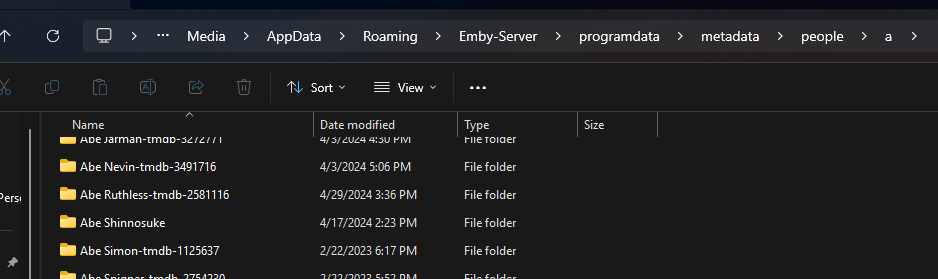

Happy2Play 9441 Posted July 30, 2024 Posted July 30, 2024 Normally will get from internet on import of media. But are stored in /metadata/people/alphabet folders by name but preferably name-tmdbid-xxxxxx. But may need more information on what you are doing.

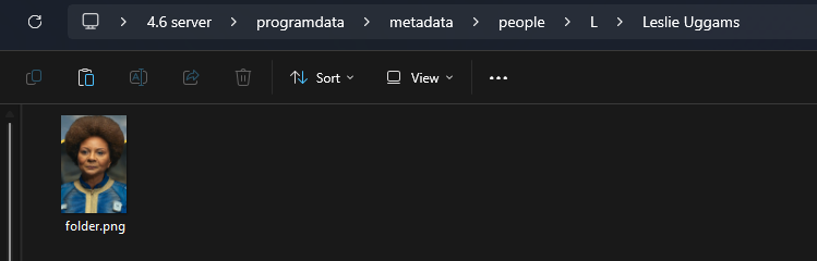

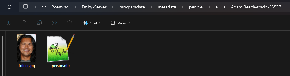

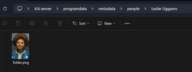

Happy2Play 9441 Posted July 31, 2024 Posted July 31, 2024 1 minute ago, terse said: My file directory is different from yours. emby can recognize all the actor's name, but it will not display the actor's picture No change yes, i did,I ran it and nothing changed. I manually added people to the metadata folder. The directory is as follows, but the actor photos are still not displayed /config/metadata ├── collections ├── genres ├── library ├── people │ └── actorA.jpg └── tags Can't be like that as ever person is in their own folder and a folder.jpg Forgot yes there are two option alphabet subfolder or not. <EnablePeopleLetterSubFolders>true</EnablePeopleLetterSubFolders>

Happy2Play 9441 Posted July 31, 2024 Posted July 31, 2024 If you change the EnablePeopleLetterSubFolders to false you will need people folder by name with your own image If you leave it at true you will need same example above in a L folder. Since Emby will not use url provide you have to manually get every person image and make appropriate person folder.

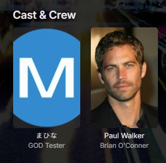

Happy2Play 9441 Posted July 31, 2024 Posted July 31, 2024 1 minute ago, terse said: i change the EnablePeopleLetterSubFolders to false, restart the emby, I added the following file and then ran the metadata update, but the actor pictures still did not appear. Thank you very much for your help. It seems that emby does not support reading local actor pictures. /config/metadata ├── collections ├── genres ├── library ├── people │ └── actora │ └── folder.jpg └── tags And does any nfo have an actor named "actora" My test <actor> <name>まひな</name> <role>GOD Tester</role> <type>Actor</type> </actor> <actor> <name>Paul Walker</name> <role>Brian O'Conner</role> <type>Actor</type> <tmdbid>8167</tmdbid> <imdbid>nm0908094</imdbid> <tvdbid>261189</tvdbid> </actor>
Happy2Play 9441 Posted July 31, 2024 Posted July 31, 2024 @Lukein my tests it appears so but are all actor nodes considered type Actor when type not provided? <actor> <name>まひな</name> </actor>

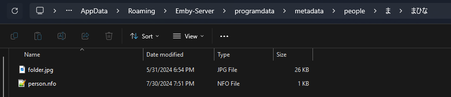

terse 1 Posted July 31, 2024 Author Posted July 31, 2024 6 hours ago, Happy2Play said: And does any nfo have an actor named "actora" actorA is just an example name I wrote. Refer to your test,After many attempts, the actor's photo can now be displayed. Should the name of the actor's nfo all be saved as person.nfo? Is there a template for the information in actor nfo? How to fill in the title, subtitle, date of birth, introduction and other information in nfo in a standard way?
Happy2Play 9441 Posted July 31, 2024 Posted July 31, 2024 5 minutes ago, terse said: actorA is just an example name I wrote. Refer to your test,After many attempts, the actor's photo can now be displayed. Should the name of the actor's nfo all be saved as person.nfo? Is there a template for the information in actor nfo? How to fill in the title, subtitle, date of birth, introduction and other information in nfo in a standard way? That is why you have to have a by name folder for every person/actor as it needs a folder.ext image and person.nfo. As for a template you can fill in all the info in the UI to see a working on but here is an example. Spoiler <person> <plot><![CDATA[Paul William Walker IV (September 12, 1973 – November 30, 2013) was an American actor. He became well known in 1999 after his role in the hit film Varsity Blues. However, he was perhaps best known for starring as Brian O'Conner in The Fast and the Furious film series. His other films include Eight Below, Into the Blue, She's All That and Takers.]]></plot> <outline><![CDATA[Paul William Walker IV (September 12, 1973 – November 30, 2013) was an American actor. He became well known in 1999 after his role in the hit film Varsity Blues. However, he was perhaps best known for starring as Brian O'Conner in The Fast and the Furious film series. His other films include Eight Below, Into the Blue, She's All That and Takers.]]></outline> <lockdata>false</lockdata> <dateadded>2021-04-22 18:50:44</dateadded> <title>Paul Walker</title> <year>1973</year> <sorttitle>Paul Walker</sorttitle> <imdbid>nm0908094</imdbid> <tmdbid>8167</tmdbid> <premiered>1973-09-12</premiered> <releasedate>1973-09-12</releasedate> <enddate>2013-11-30</enddate> <placeofbirth>Glendale, California, USA</placeofbirth> <uniqueid type="tmdb">8167</uniqueid> <uniqueid type="imdb">nm0908094</uniqueid> </person>
