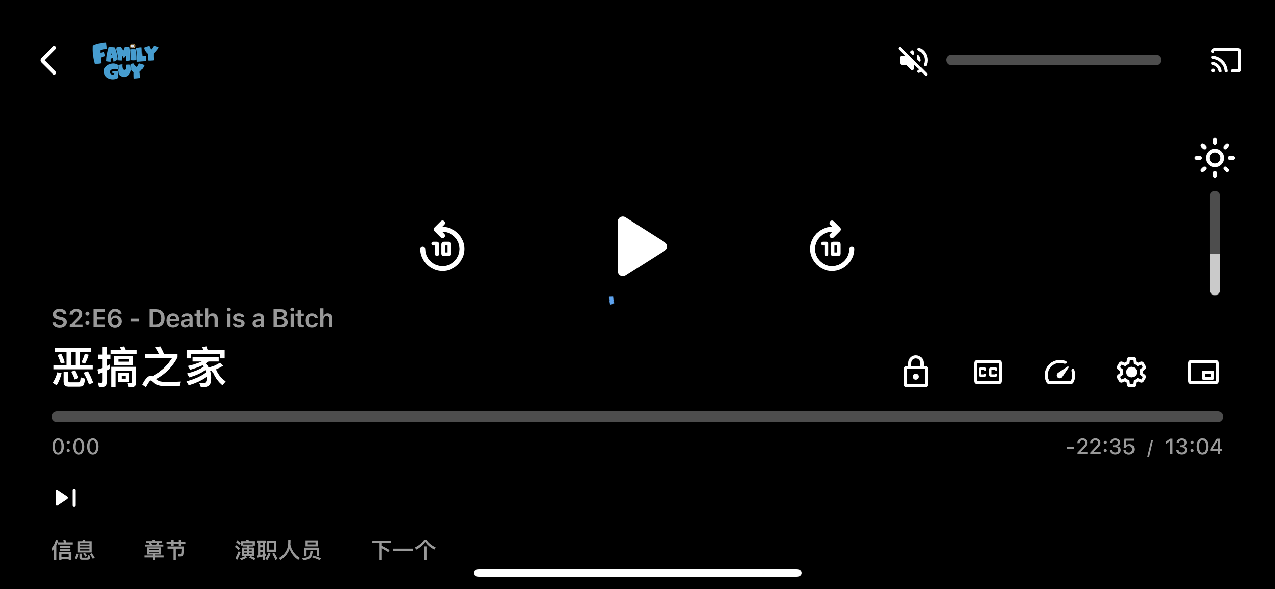

Magnoliiiia 3 Posted July 9, 2024 Posted July 9, 2024 Problem with Transcoding Media on iPhone Devices, Including Safari and Emby App I am experiencing issues with transcoding media on iPhone devices, including both the Safari browser and the Emby app. Specific Issues: When decoding and playing MP4 media (e.g., "Family Guys"), the page continuously displays a loading circle. Upon checking the transcoding log, the following error appears: "Could not write header for output file #0 (incorrect codec parameters ?): No such file or directory." Additional Testing: Transcoding and playing this MP4 media on Xbox and PC using Chrome browser does not present the same issue. Transcoding and playing MKV media on iPhone devices (including Emby app and Safari) does not present this issue. When disabling hardware transcoding, the iPhone devices can transcode and play the MP4 media correctly. I need help in resolving this problem. plz embyserver.txt ffmpeg-transcode-ef195ea5-6a52-4e3c-aad1-cd3cae8844bf_1.txt

Magnoliiiia 3 Posted July 9, 2024 Author Posted July 9, 2024 (edited) I didn't find the "side menu" he mentioned, and it's strange that if I switch to software transcoding, the problem doesn't occur. The issue also doesn't happen with other videos using hardware transcoding. I even downloaded the Chrome browser on my iPhone, but the problem still persists. Edited July 9, 2024 by Magnoliiiia upload png
