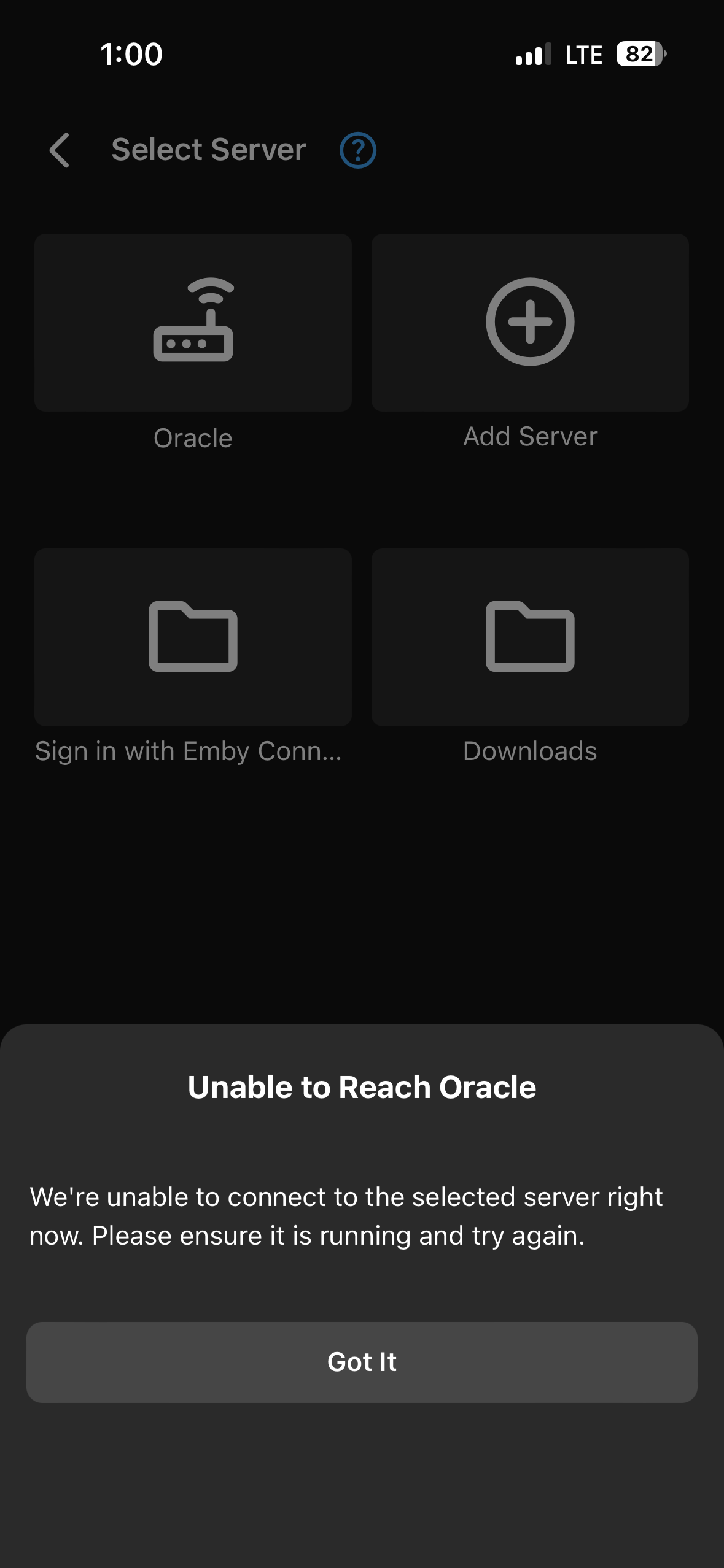

SMTV91 15 Posted June 9, 2024 Author Posted June 9, 2024 Thanks for checking in! Unfortunately remote connection isn’t working for me. The server is up and running and other remote connections with other software work but not Emby on my phone. I can’t get past the choose server screen. And I haven’t made any changes to my network connection ie ISP or ports etc Not sure what else it could be. Unless I need to reinstall the server?
Luke 40136 Posted June 9, 2024 Posted June 9, 2024 Hi, please try doing a manual connection by clicking add server and entering the server address manually. Please let us know if that helps. Thanks.
SMTV91 15 Posted June 9, 2024 Author Posted June 9, 2024 So on my local wifi I tried and still get the playback error. I tried to start watching this episode of One Piece - Startling! the secrets of the island is finally revealed on my iphone. (Logs attached here). And trying to connect manually throws back the "unable to connect to the selected server" error using both my local and remote server addresses as indicated on the emby dashboard. embyserver.txt

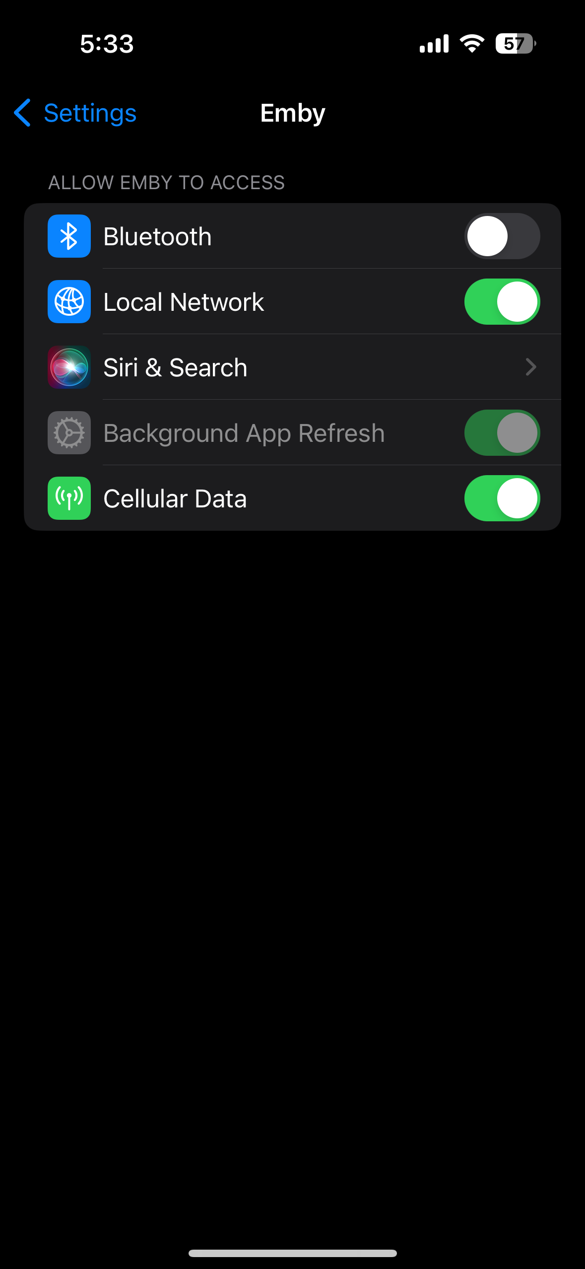

Luke 40136 Posted June 19, 2024 Posted June 19, 2024 Try making sure the app is granted local network access on the device.
SMTV91 15 Posted June 19, 2024 Author Posted June 19, 2024 (edited) 53 minutes ago, Luke said: Try making sure the app is granted local network access on the device. @LukeI haven’t changed anything in my network configuration and the app has local network access. It’s just that after the update nothing worked anymore on my phone and my remote connections can’t access my server anymore. Edited June 19, 2024 by SMTV91

Luke 40136 Posted June 19, 2024 Posted June 19, 2024 1 hour ago, SMTV91 said: @LukeI haven’t changed anything in my network configuration and the app has local network access. It’s just that after the update nothing worked anymore on my phone and my remote connections can’t access my server anymore. Can you please still check it anyway? Thanks.

SMTV91 15 Posted June 19, 2024 Author Posted June 19, 2024 1 minute ago, Luke said: Can you please still check it anyway? Thanks. Already checked and it's still connected.
Luke 40136 Posted June 19, 2024 Posted June 19, 2024 4 minutes ago, SMTV91 said: Already checked and it's still connected. What exactly did you check, and what did you find?
SMTV91 15 Posted June 19, 2024 Author Posted June 19, 2024 1 minute ago, Luke said: I would suggest checking out our Connection Troubleshooter: Connectivity Please try the steps listed there and let us know which ones succeed and which ones do not. Thanks. This is what I used to set up remote connections initially and everything is the same. Ports are forwarded and open and there's access through firewall. Is there anything in the logs that may explain? Do I need to reinstall my server or something else? Too bad I can't just rollback the emby app on my phone
SMTV91 15 Posted June 19, 2024 Author Posted June 19, 2024 31 minutes ago, Luke said: What exactly did you check, and what did you find? Allow local network access on the app:
SMTV91 15 Posted June 20, 2024 Author Posted June 20, 2024 On 6/19/2024 at 5:35 PM, SMTV91 said: Allow local network access on the app: @LukeAlso rechecked port forwarding through my ISP, checked remote status using canyouseeme, and of course nothing in my configuration has changed. Using app.emby.tv works but in the app nothing. I can't even login on the app anymore when I try to it says login error.
SMTV91 15 Posted June 20, 2024 Author Posted June 20, 2024 (edited) 2 minutes ago, Luke said: Have you tried clicking forgot password? @LukeBut the same password works everywhere else i sign in on emby (ie safari, chrome, fire stick, ios on ipad etc). It's just the ios phone app where I can't log in and when I was able to login I kept getting the no available streams error. Edited June 20, 2024 by SMTV91
