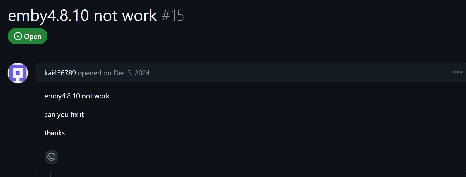

Luke 41244 Posted February 3 Posted February 3 14 minutes ago, richenginner said: how to run in emby windows server? The github link in the first post seems to have some detailed instructions.
richenginner 2 Posted February 3 Posted February 3 1 minute ago, Luke said: The github link in the first post seems to have some detailed instructions. only for docker
richenginner 2 Posted February 3 Posted February 3 1 hour ago, Luke said: i tried, but not save and reset to empty values
Luke 41244 Posted February 3 Posted February 3 12 minutes ago, richenginner said: i tried, but not save and reset to empty values Best thing to do is report your issue in the topic for the plugin. Thanks.
richenginner 2 Posted February 3 Posted February 3 2 minutes ago, Luke said: Best thing to do is report your issue in the topic for the plugin. Thanks. another user report but user don't response yet. thanks!
Luke 41244 Posted February 3 Posted February 3 3 minutes ago, richenginner said: another user report but user don't response yet. thanks! I don't know what that's from, but the user didn't provide any description of their problem. That could mean anything. The developer should ask some questions, but the user should also provide more detail.
