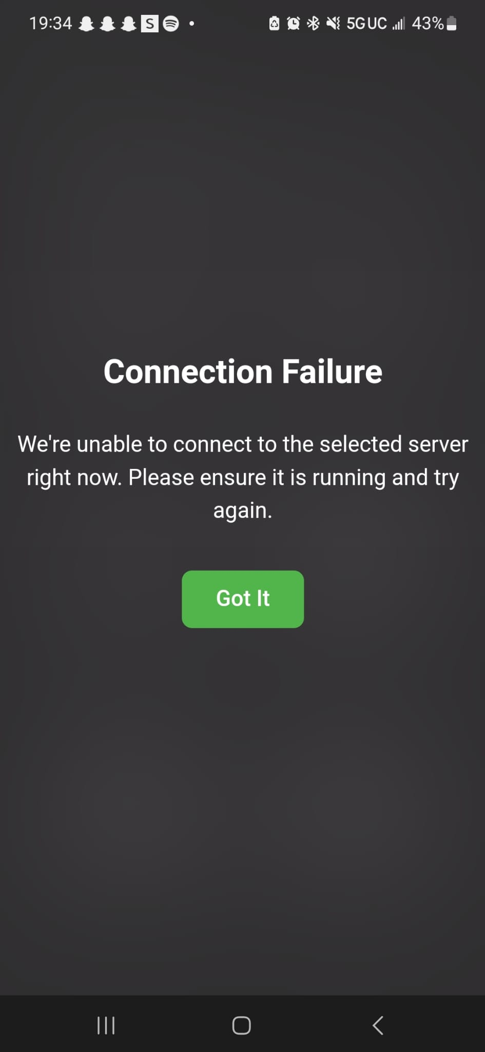

keithwalker80 6 Posted June 10, 2023 Posted June 10, 2023 Since the issue with the plugin that caused the servers to not start, I have had quite a few users not able to login remotely with the Emby App. I have verified the proper port forwarding, and had the users uninstall and reinstall the app and they consistently get a connection error. They are able to access from a web browser with no issues. Any assistance would be greatly appreciated.

keithwalker80 6 Posted June 13, 2023 Author Posted June 13, 2023 For further info, I have attached a picture of the message that is being received. Again, this is only happening on mobile devices or streaming devices such as chromecast, roku or fire stick.
rbjtech 5000 Posted June 13, 2023 Posted June 13, 2023 So on the devices with an issue - the only thing left to do is to try and run a browser or something that allows network command lines. I know it will be painful, but if you load the 'Silk Browser' on the FireTV (it's probably already installed) and use the http:\\yourdomain.com:8096 - does that connect ok ?

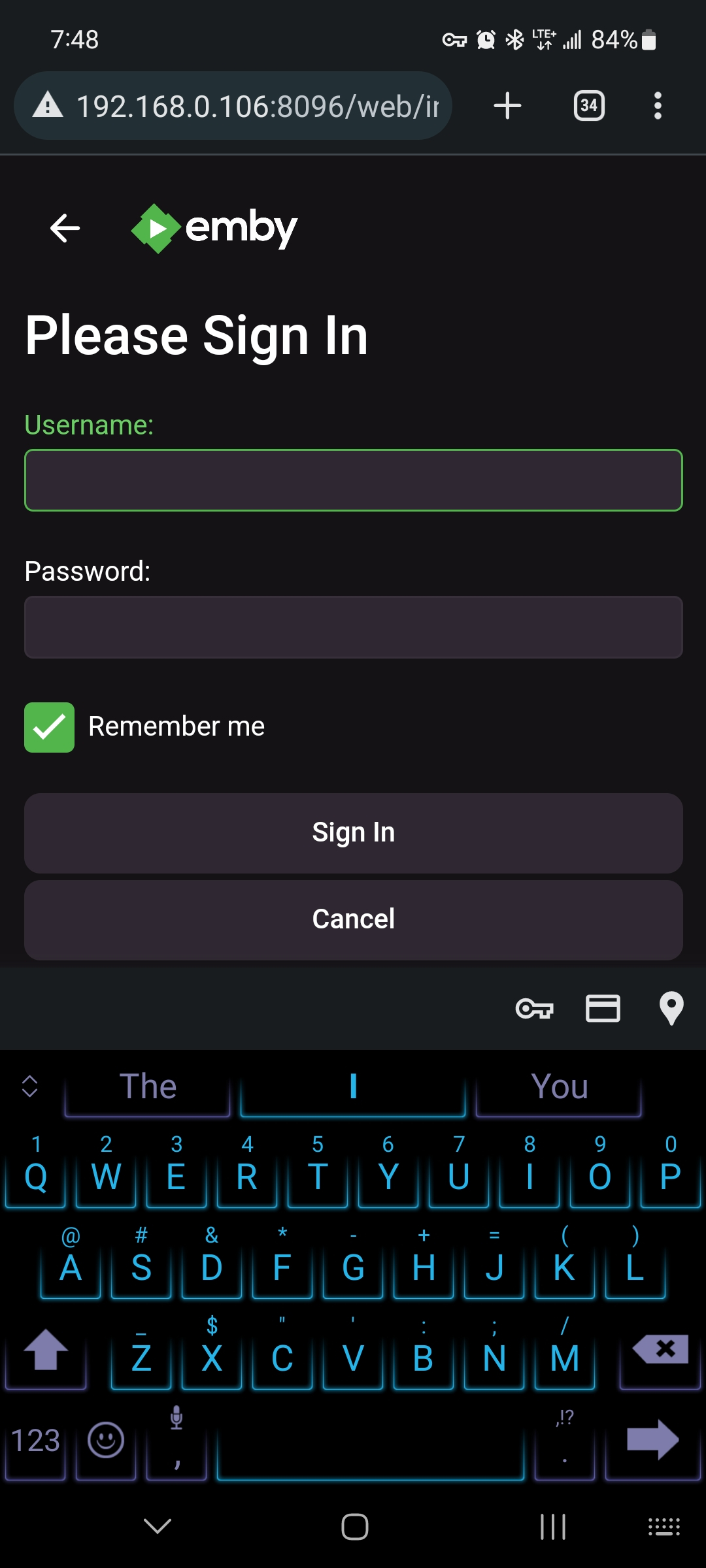

visproduction 283 Posted June 13, 2023 Posted June 13, 2023 The last image is a mobile screen. Mobile browsers do not allow direct IP address in the URL. Instead, the browsers always use a search engine first, by design. You need to open a private / incognito browser window, to be able to go to an IP address. Users often don't understand this and assume that typing an address in the URL goes to the site. Most mobile users never type an address anyway. They just tap on links.
darkassassin07 620 Posted June 13, 2023 Posted June 13, 2023 3 minutes ago, visproduction said: The last image is a mobile screen. Mobile browsers do not allow direct IP address in the URL. Instead, the browsers always use a search engine first, by design. You need to open a private / incognito browser window, to be able to go to an IP address. Users often don't understand this and assume that typing an address in the URL goes to the site. Most mobile users never type an address anyway. They just tap on links. Where are you getting that info? Mobile browsers accept ip addresses just fine:
visproduction 283 Posted June 13, 2023 Posted June 13, 2023 Safari or Chrome on Apple IOS goes first to a search engine, which finds nothing on an IP address. It depends on which browser and OS you are using in mobile to see this issue.
pwhodges 1855 Posted June 13, 2023 Posted June 13, 2023 Some browsers will search if just given an IP address alone, but will do what they should if it starts with http:// Paul 1 2
