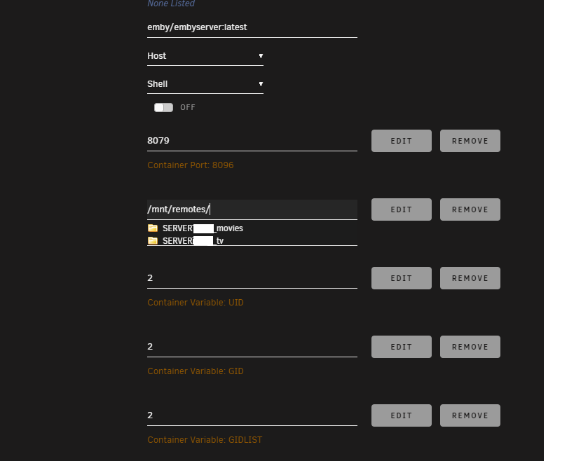

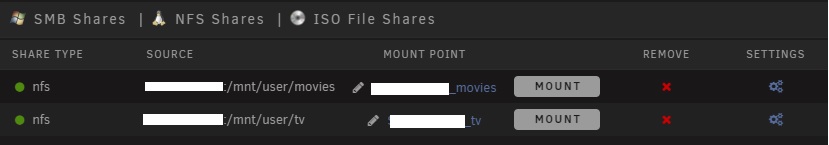

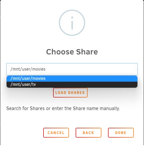

ryzen5000 12 Posted November 17, 2022 Author Posted November 17, 2022 (edited) I got the remote shares added to the docker template on my 1st staging server. UNRAID OS PRO https://officerat.store/product/lime-technology-unraid-os-pro-6-10-3-server-os-software/ Edited November 17, 2022 by ryzen5000
