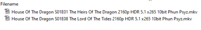

Krauz 1 Posted October 13, 2022 Author Posted October 13, 2022 hi, yes of course. So on my webdav cloud there are two files currently for testing purposes. Their names are : House Of The Dragon S01E01 The Heirs Of The Dragon 2160p HDR 5.1 x265 10bit.mkv and House Of The Dragon S01E08 The Lord Of The Tides 2160p HDR 5.1 x265 10bit.mkv They are both in said "links" folder. When adding this folder to my TV Shows library in emby it doesn't group them together into a single "The House of The Dragon" show but instead lists these singular episodes with their file names as episode names under "latest TV shows". Not even listing it under "TV Shows" in the library even after multiple restarts of the media server and rescans of my library. Under "latest TV shows" I can click play and watch them but when I finish watching them they completely disappear from my library nowhere to be found, even after rescanning and restarting again. I am guessing this is just all consequence of emby not being able to know where to list it because the files are just thrown together in a single folder. This is why I thought the "Auto Organizer" would help me but this is also where I came to find out what I described earlier. The files in the rclone mount folder obviously don't occupy nearly as much space on my disk as it says when inspecting it with "du -s --apparent-size" just because of the fact that my internet speed isn't fast enough to download 1.3 GB as fast as the files appear in the folder. Now trying to sort the files with the "Auto Organizer" plugin creates that exact problem I stated earlier where instead of moving/copying the "dummy file" (still for the lack of a better term) it downloads the file from my WebDAV cloud to the folder where it is supposed to copy the "dummy file" to. This is apparent by looking at my router admin panel and seeing the download speed of my media server go up exactly the moment I order the copy command. I hope you can help me and be sure to let me know if you need any more information, I'll be glad to help you help me My emby server is running version 4.7.8.0, rclone is running version 1.59.2 if that is any help to you.
Luke 40111 Posted October 13, 2022 Posted October 13, 2022 Can you please show us the exact folder structure? Thanks.
Krauz 1 Posted October 13, 2022 Author Posted October 13, 2022 Here you go. First one is the root of my disk, second one is in the "realdebrid" folder which is the mount folder for rclone and third one is my two files inside the "files" folder. This last one would be the folder where all of the files that are on my WebDAV cloud would be thrown in without any sorting.
Luke 40111 Posted October 13, 2022 Posted October 13, 2022 OK so you just have flat files without series folders. Currently that is not fully supported and that is the reason for your problem. This is something we'd like to support in future updates, we're just not there yet.
