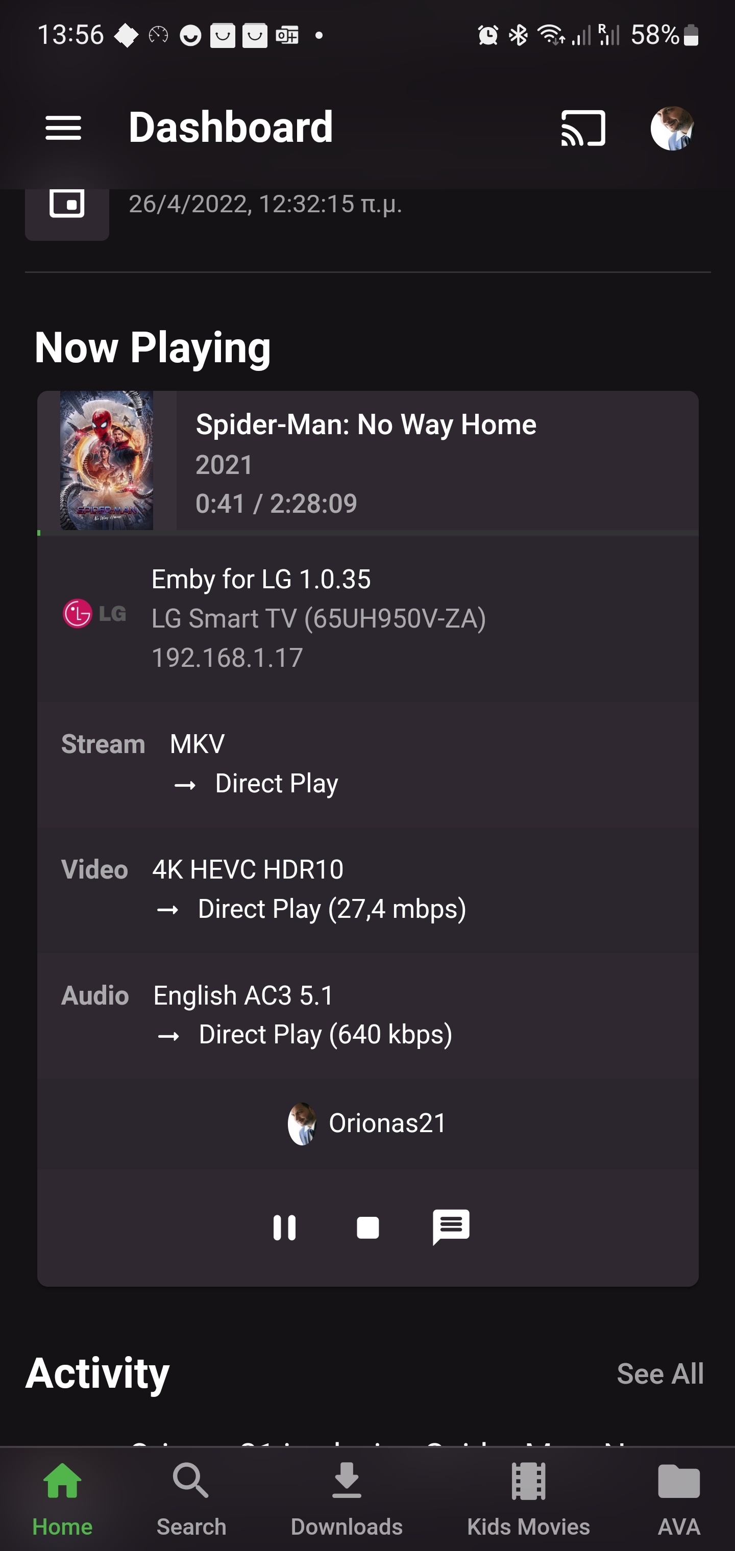

So since the client doesn't actually supports the selection, you perform it via this method. Meaning that if i select the AC3 i will have the mentioned issue with m3u8 but also if i leave the main audio track since TRUEHD is transcoded to AC3, as depicted in the above pictures, the issue reoccurs because again we have the m3u8 or something else?

Hey all!
Good news!!!
I installed the updated app in my LG and the issue is resolved!!
Thank you very much for your support!!

Is the new release available now?  Version 1.0.35?
Orionas21
Yes as you can see from my screen shots the new version is 1.0.35.
Today when I opened my tv a pop up informed me that a new version was available for some apps, so I went to the LG store and installed it.
I immediately tested it with a 15 minute preview of the "problematic" movie and everything looks great.
It seems that now indeed you can select the second audio without the m3u issue...
My country is Greece. So most probably Europe will have the new release within this week.
