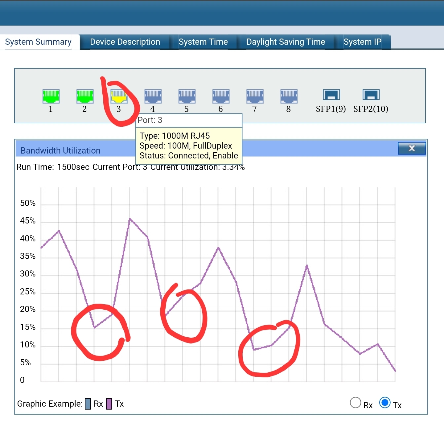

Orionas21 4 Posted March 18, 2022 Author Posted March 18, 2022 In addition to the above when the issue occurs you can observe in the below graph from my switch that the network traffic is dropping as if the app is not requesting any data. This is with the embedded ethernet card. And this is with the USB 3 to gigabit adapter.
SamES 1004 Posted March 18, 2022 Posted March 18, 2022 OK, thanks for confirming. For the example in your first post, can you please attached the ffmpeg logs from the server? Can you please check the webOS version for me? You will need to go into about this TV. Don't check the first version number you see, this is probably the firmware version, you need to go deeper into the menu to get the webOS version it will be 3.something (ie: 3.0, 3.5, 3.8)
