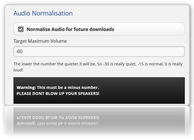

radeon 733 Posted December 5, 2013 Posted December 5, 2013 TV Theme Videos 1.0.3.0 Released! Added Custom Maximum Volume for Audio Normalisation features. Configure it through the Plugins Configuration Page The lower the number the quieter it will be. So -30 is really quiet, -15 is normal, 0 is really loud! 3
Cheesegeezer 3102 Posted December 5, 2013 Posted December 5, 2013 (edited) @@radeon good work mate, great feature added to an already great plugin. so i'd just like to add that to use this new feature you have to delete your filters(for titles that you want to be normalised) and the backdrops folders. Set your gain, I found -15 to -10 was a good range, then SAVE. Run the plugin again and voila..... normalized audio for all tv theme backdrops Edited December 5, 2013 by Cheesegeezer
