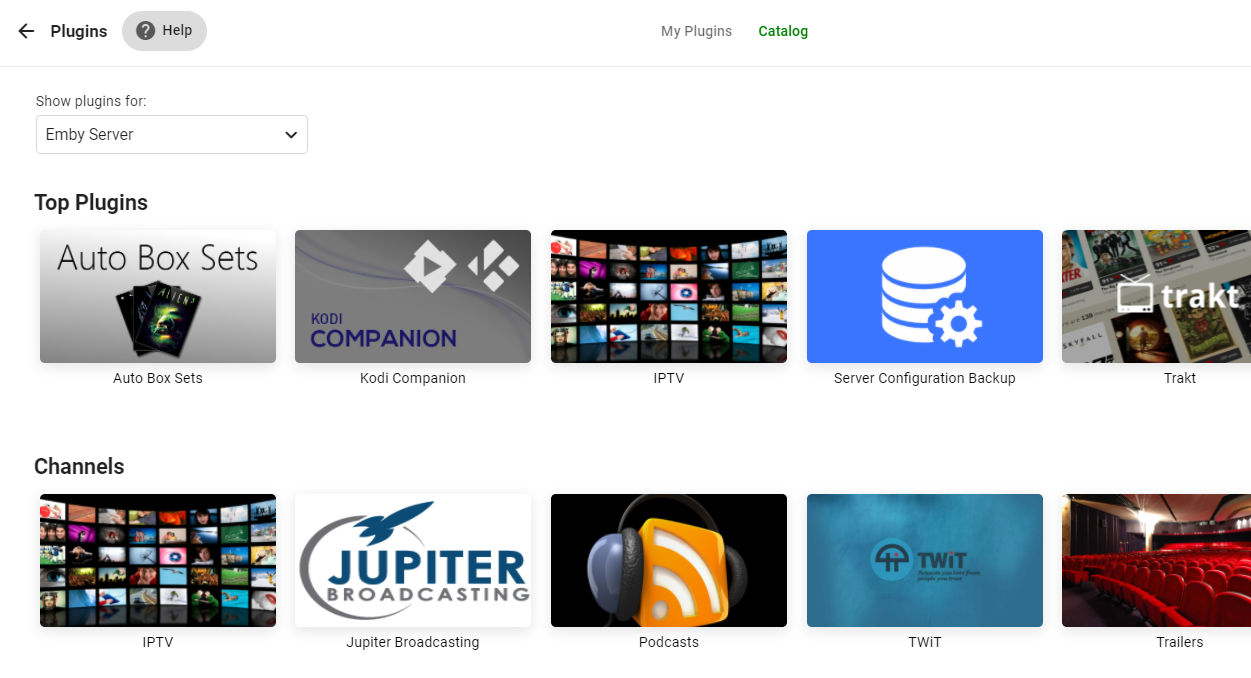

Carlo 4552 Posted December 13, 2021 Posted December 13, 2021 OK I'm getting read to pull the card and make an image of it. Doing a couple checks. I tested using my Premiere key before removing it. Here's a view from the the catelog: The hardware Decoders & Encoders So https is working fine for me. Download it from here. http://ayars.synology.me:5000/sharing/iaTnH5H8r You will want to change passwords. Pi/Raspberry for for the OS Admin/password for Emby I didn't set geo, time zones or video resolution so you will want to adjust settings to your liking.
