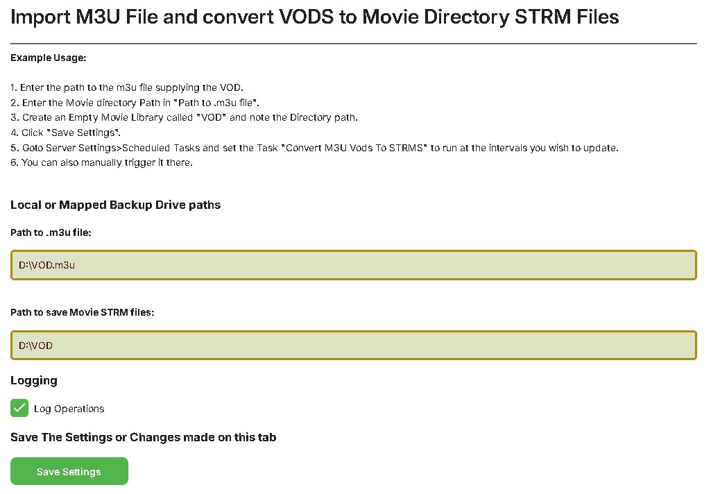

mickle026 607 Posted February 7 Posted February 7 I can do this internally within Emby - I have my own plugin that does it. I actually just saw this post because I did a little coding on it today to fix a bug and was reading the forum looking for examples. Then it is ran as a scheduled task, it creates the strm and downloads the logo as Poster.jpg into the movie folder with the strm file .(The path can be an url). Its a scheduled Task so it keeps the directory updated with new content. So I can run it daily, or weekly or whatever.. on a schedule. Because it mine for my needs only, its pretty basic. but i can make it better so that it can seperate TV VOD from Movie VOD. This is currently part of another plugin thats personal for myself, but if you want me to make this avaliable as a standalone plugin, I would need some examples though even if they dont work, just for the way they are named and formatted so that I can cover more bases on how to detect whether or not it was a VOD It would also add the ability to remove what was no longer avaliable via the task aswell, its not there currently but its no biggie.

mickle026 607 Posted February 12 Posted February 12 (edited) 20 hours ago, sundevil67 said: The m3u file looks like this for each entry: #EXTINF:-1 tvg-id="tt32249644" tvg-name="tt32249644" tvg-type="movies" group-title="Movies 2024" ,Bad Tidings (2024) https://IPTV-provider-URL/username/password/movie/tt32249644 So far, no luck with @mickle026's plugin unfortunately. It has not ever been published here, and the fact that you guys have only just answered my question hasnt enabled me to work on it to fit your needs yet This string is different to mine, so i will have to make some alterations to my code to make this one work with it. Mine doesnt have the tvg-type and has VOD in the group-title. So the next question is how can the "logic" determine this is a VOD and not a channel, what sets this apart from a movie tv channel for processing purposes? I just need to change the regex for yours to like this to cover yours and mine, but would it catch live tv channels in it? I have added segments of my code here with the regex as it might be helpful to you. This is mine: Detect vod in group title and any of the inclusive words in the moviename in brackets () or [] string incluseionwords = "vod|video on demand|movie|film"; Regex.IsMatch(groupTitle, @"^[\[\(]?vod", RegexOptions.IgnoreCase) && Regex.IsMatch(movieName, $@"[\[\(]({incluseionwords})[\]\)]", RegexOptions.IgnoreCase) This is what i would add for yours Detect imdb ttxxxx in both tvg-id & tvg-name aswell as the word movie in tvg-type & group-title || Regex.IsMatch(tvgId, @"^[tt]{2}\d{6,12}$", RegexOptions.IgnoreCase) && Regex.IsMatch(tvgName, @"^[tt]{2}\d{6,12}$", RegexOptions.IgnoreCase) && Regex.IsMatch(tvgType, @"^[\[\(]?movies", RegexOptions.IgnoreCase)) Here is my extraction code - incase it helps you with your script private string ExtractGroupTitle(string titleElement) { var match = Regex.Match(titleElement, @"group-title=""([^""]*)"""); return match.Success ? match.Groups[1].Value : string.Empty; } private string ExtracttvgType(string titleElement) { var match = Regex.Match(titleElement, @"tvg-type=""([^""]*)"""); return match.Success ? match.Groups[1].Value : string.Empty; } private string ExtractTvgId(string titleElement) { var match = Regex.Match(titleElement, @"tvg-id=""([^""]*)"""); return match.Success ? match.Groups[1].Value : string.Empty; } private string ExtractTvgName(string titleElement) { var match = Regex.Match(titleElement, @"tvg-name=""([^""]*)"""); return match.Success ? match.Groups[1].Value : string.Empty; } private string ExtractMovieName(string titleElement) { var split = titleElement.Split(new[] { ',' }, 2); return split.Length > 1 ? split[1] : string.Empty; } private string ExtractTvgLogoUrl(string titleElement) { var match = Regex.Match(titleElement, @"tvg-logo=""([^""]*)"""); return match.Success ? match.Groups[1].Value : string.Empty; } but then do you also need it to create the folder "Movies 2024", because thats where it makes my logic a bit more complex, my plugin already writes everything it detects with this string to your chosen folder. In your example in would create Chosen Folder/Bad Tidings (2024)/Bad Tidings (2024).strm with the STRM content https://IPTV-provider-URL/username/password/movie/tt32249644 Edited February 13 by mickle026 correct the regex

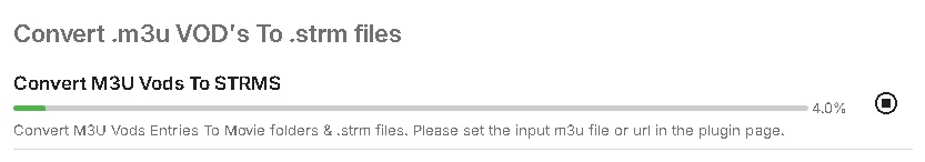

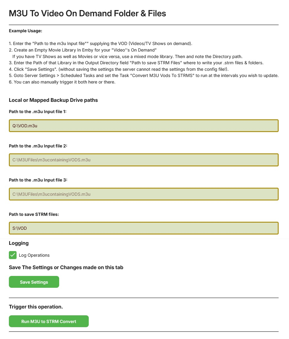

mickle026 607 Posted February 13 Posted February 13 (edited) I have done the code, its all working. Currently the progress bar doesnt work in the scheduled task either, but i am not worried about that yet, the scheduled task does though. I am concentrating on getting the tv shows into season folders at the moment. I have enabled the plugin to take 3 m3u urls or paths, but it is designed so that it can do it all from one m3u. its here: Edited February 13 by mickle026 1
mickle026 607 Posted February 14 Posted February 14 Updated it, to also split a stream providers m3u file into LiveTV,TVshows and Movies (3 seperate m3u files) and save them. 1
