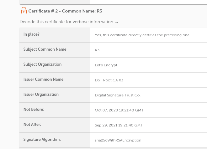

nickbmx2100 2 Posted October 4, 2021 Author Posted October 4, 2021 I used this SSL checker https://decoder.link/sslchecker/ to check what certs my emby server is reporting . It still shows the expired Root CA . But I could not find where the certs are stored on the server. I was also looking for temp folder but could not located it. My Emby Server is on Synology DSM7 installed via Package Center Subject Common Name R3 Subject Organization Let's Encrypt Issuer Common Name DST Root CA X3 Issuer Organization Digital Signature Trust Co. Not Before: Oct 07, 2020 19:21:40 GMT Not After: Sep 29, 2021 19:21:40 GMT

nickbmx2100 2 Posted October 4, 2021 Author Posted October 4, 2021 I was looking for the X509 store. I found it at /volume1/@apphome/EmbyServer/.dotnet/corefx/cryptography/x509stores/ca Inside the folder is the PEM file. I renamed it backup.txt and restarted Emby Server to test. ash-4.4# pwd /volume1/@apphome/EmbyServer/.dotnet/corefx/cryptography/x509stores/ca ash-4.4# del 48504E974C0DAC5B5CD476C8202274B24C8C7172.pfx ash: del: command not found ash-4.4# mv 48504E974C0DAC5B5CD476C8202274B24C8C7172.pfx backup.txt ash-4.4# ls backup.txt
nickbmx2100 2 Posted October 4, 2021 Author Posted October 4, 2021 Now when to run SSL checker https://decoder.link/sslchecker/ the updated ISRG Root X1 cert is now being used by server Subject Organization Let's Encrypt Issuer Common Name ISRG Root X1 Issuer Organization Internet Security Research Group Not Before: Sep 04, 2020 00:00:00 GMT Not After: Sep 15, 2025 16:00:00 GMT 1
nickbmx2100 2 Posted October 4, 2021 Author Posted October 4, 2021 (edited) This resolved my issues. I was able to Successfully connect my Roku TV/ Emby App to my Remote Emby Server using HTTPS . Recap: So even after updated cert gets saved via the Network menu under "Custom ssl certificate path" The server still holds on to old expired PFX at the X509store directory. There should be a way for Emby to clear that directory if a new PFX is updated by Admin. A Server restart does not update it. I had SSH with my to that specific directory as "Root" to clear it. Then restart EmbyServer Edited October 4, 2021 by nickbmx2100 1
