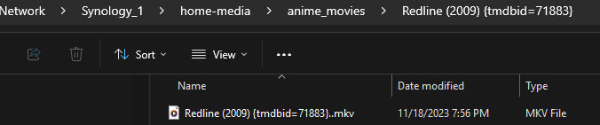

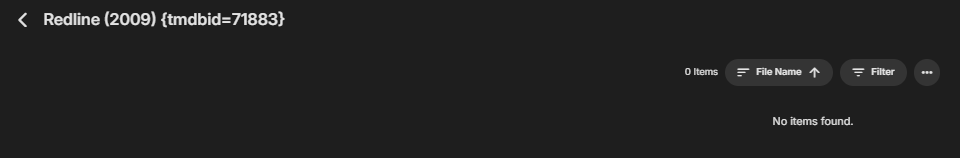

Some movies not showing up in Emby- Round 2
ServerNoob005 replied to ServerNoob005's topic in General/Windows
Good evening. @brothom @LukeAs I feared, it did not succeed. Even tried moving it to the normal generic "movies" folder on the off chance that would make a difference, and it gives the same result as below. I really don't know what to say at this point. It simply doesn't seem to care about the folder or mkv name at all. Unfortunately, I can't reasonably guess what has caused this as I said, I have hardly touched the settings. It doesn't matter how many times IU rescan the library- The result is always the same. I open to any further suggestions of where I should look next... - Today
Good evening @Luke In short: …no. In full: I have yet to try the most recent post by @brothom I will update once I have, likely in a few hours. Thus far, none of the suggestions have bared fruit unfortunately. I’ve given each one a respectful try I think. Honestly, I’m rather baffled how something so relatively simple can prove to be so difficult to crack. Like pwhodge’s said— I really don’t know what I missing at this point. I haven’t really played much with the setting so the system should be and borderline default settings. Why my emby server hates these 3 movies in particular remains unclear. If brothom’s naming suggestion fails, which I honestly expect it will, then I am going to be out of ideas, sadly. Already tried putting these 3 movies into their own library, etc, and I don’t think unmounting and remounting in Linux is going to do anything either. =[ -
