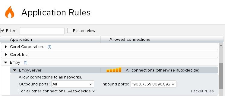

Methodman104 10 Posted June 4, 2021 Posted June 4, 2021 (edited) Hello, I hope I posted this in the right section, if not please feel free to move this topic to the right section of the forum. After months of being able to connect to my Emby server remotely, I am unable to connect to it again. This started about 2 or 3 weeks ago when Emby also started to no longer stream on my Firestick anymore. I contacted my internet provider they told me the ports are still open (8096). I use Avast Anti-Virus and my Firewall settings is still on "private network" but are set to allow Emby. Can anyone address this issue? Thanks! Edited June 4, 2021 by Methodman104
