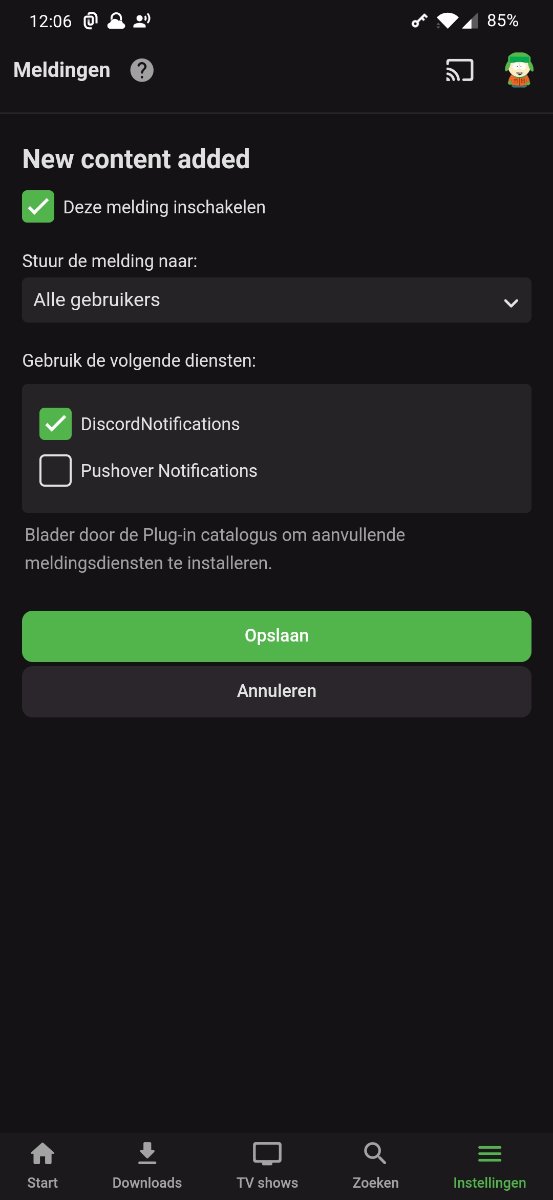

BaukeZwart 94 Posted May 24, 2021 Posted May 24, 2021 I have Pushover notification disabled for new content added but still im getting Pushover notifications for ot. embyserver.txt
GrimReaper 4852 Posted May 24, 2021 Posted May 24, 2021 1 hour ago, BaukeZwart said: I have Pushover notification disabled for new content added but still im getting Pushover notifications for ot. embyserver.txt 287.83 kB · 0 downloads Same here, but it's Pushbullet notifications. Also, I have two Discord Webhooks - one for Playback and one for New content added - and while Video playback started and Video playback stopped respect configuration and send notification to one channel only, New content added does not, it sends to both of them. Looks like New content added is sending EVERYWHERE and on all methods, regardless of configuration.

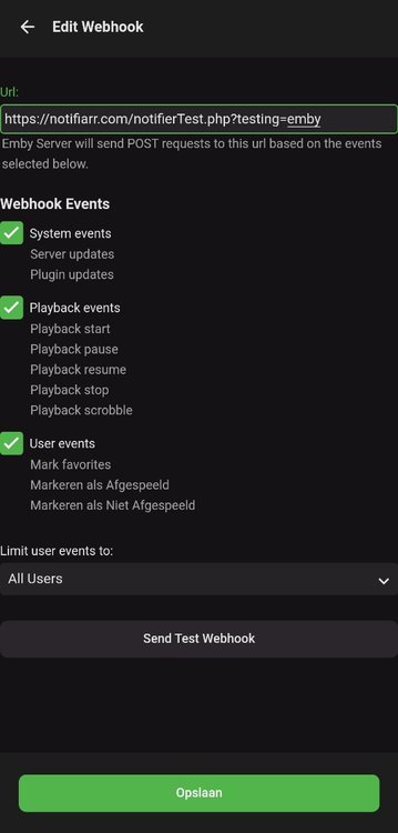

BaukeZwart 94 Posted May 25, 2021 Author Posted May 25, 2021 (edited) If anybody wants to help to speedup the Notifiarr Emby support please add a webhook that points to: https://notifiarr.com/notifierTest.php?testing=emby It will send payload information to the developers server, once he has payloads for all these events, Emby support can be added. Edited May 25, 2021 by BaukeZwart 2
GrimReaper 4852 Posted May 25, 2021 Posted May 25, 2021 2 hours ago, BaukeZwart said: If anybody wants to help to speedup the Notifiarr Emby support please add a webhook that points to: https://notifiarr.com/notifierTest.php?testing=emby It will send payload information to the developers server, once he has payloads for all these events, Emby support can be added. Added. 1

mad_cow 2 Posted January 19, 2022 Posted January 19, 2022 On 5/24/2021 at 2:14 PM, GrimReaper said: Same here, but it's Pushbullet notifications. Also, I have two Discord Webhooks - one for Playback and one for New content added - and while Video playback started and Video playback stopped respect configuration and send notification to one channel only, New content added does not, it sends to both of them. Looks like New content added is sending EVERYWHERE and on all methods, regardless of configuration. I have the same issue as well with Pushbullet. I once added a token to the wrong user. Now I can't remove it, and so now I get every notification twice Will this be fixed in an upcoming release?
adkeyz 2 Posted May 23, 2022 Posted May 23, 2022 @Luke Was this ever fixed? I am having the same issue. I previously set up new content notifications for a user, but now I want it set up for a different user but the old user is still getting them so I get the notifications twice. Is there a way to just reset all notification settings completely and start again?
Luke 42186 Posted May 23, 2022 Posted May 23, 2022 7 hours ago, adkeyz said: @Luke Was this ever fixed? I am having the same issue. I previously set up new content notifications for a user, but now I want it set up for a different user but the old user is still getting them so I get the notifications twice. Is there a way to just reset all notification settings completely and start again? HI there, can you please go over a specific example? Thanks.
