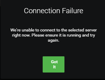

teiva 18 Posted November 11, 2016 Posted November 11, 2016 Ubuntu 16 Docker Emby 3.0.8500 Connection failure upon simple direct login within the network. Server is definitely running because I can access my media files via windows explorer from a box within the home network. I have no idea where my server logs are without access to my emby server dashboard. Everything was working fine until I updated/upgraded Ubuntu and emby server within docker.
teiva 18 Posted November 11, 2016 Posted November 11, 2016 (edited) Ubuntu 16 Docker Emby 3.0.8500 Connection failure upon simple direct login within the network. Server is definitely running because I can access my media files via windows explorer from a box within the home network. I have no idea where my server logs are without access to my emby server dashboard. Everything was working fine until I updated/upgraded Ubuntu and emby server within docker. I figured it out. I ran out of disk space on my home directory. Edited November 14, 2016 by teivalp
