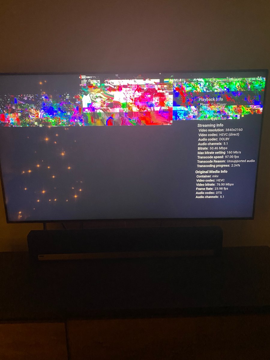

CogyG 3 Posted January 3, 2021 Posted January 3, 2021 (edited) Just trying to watch some 4K movies with DTS while transcoding to AC3. But some movies cant playback the image, i get some purple, greenish color's. This is because of the transcoding. If i select another track aC3 (with commentary), there''s no problem. Why does one movie have this problem, and the other not? Inception has this problem, intersteller doesn't - Direct stream becasue of the audio - 4K movie with 76 mbps - MKV content Thanks in your advance ffmpeg-remux- Interstellar.txt ffmpeg-remux-Inception.txt Edited January 3, 2021 by CogyG
vdatanet 1619 Posted January 3, 2021 Posted January 3, 2021 16 minutes ago, CogyG said: Just trying to watch some 4K movies with DTS while transcoding to AC3. But some movies cant playback the image, i get some purple, greenish color's. This is because of the transcoding. If i select another track aC3 (with commentary), there''s no problem. Why does one movie have this problem, and the other not? Inception has this problem, intersteller doesn't - Direct stream becasue of the audio - 4K movie with 76 mbps - MKV content Thanks in your advance ffmpeg-remux- Interstellar.txt 82.98 kB · 1 download ffmpeg-remux-Inception.txt 103.52 kB · 1 download Take a look at this: 4k HEVC files freeze after a few seconds - Android - Emby Community

vdatanet 1619 Posted January 3, 2021 Posted January 3, 2021 (edited) 1 hour ago, CogyG said: I''m on the latstest beta version, but no succes. Also i can'' t find the NCDEX.Ex decoder. Is this because the server is on a Shield? This is a server issue: 18:29:38.537 Stream #0:0 -> #0:0 (copy) 18:29:38.537 Stream #0:1 -> #0:1 (dts (dca) -> ac3 (native)) Edited January 3, 2021 by vdatanet
CogyG 3 Posted January 3, 2021 Posted January 3, 2021 37 minutes ago, vdatanet said: This is a server issue. Can you explain to me please
vdatanet 1619 Posted January 3, 2021 Posted January 3, 2021 Just now, CogyG said: Can you explain to me please There's an issue in the server while remuxing HEVC HDR content, it seems to be due to a bug in ffmpeg. Here's in another example:
vdatanet 1619 Posted January 3, 2021 Posted January 3, 2021 (edited) 13 minutes ago, CogyG said: Can you explain to me please As a workaround: If you are running Android TV stable you can set audio output "Enable downmix" and If you run Android TV beta you can disable "Convert Unsupported Audio to Dolby Digital". Edited January 3, 2021 by vdatanet
CogyG 3 Posted January 5, 2021 Posted January 5, 2021 On 1/3/2021 at 9:07 PM, vdatanet said: As a workaround: If you are running Android TV stable you can set audio output "Enable downmix" and If you run Android TV beta you can disable "Convert Unsupported Audio to Dolby Digital". This will downmix all audio to pcm. I also have the beta version, but “convert unsupported audio” is not available Only enable downmix My sonos playbar can play truehd, so this is no option. i will wait untill dts can be remuxed to ac3 without any problems. Thanks

CogyG 3 Posted January 5, 2021 Posted January 5, 2021 (edited) I thought you mean the server, just update and see the option. But still doesn't work for all movies: Still, some movies have some troubles while transcoding 4k HDR, as i steaded below. On 1/3/2021 at 6:52 PM, CogyG said: Just trying to watch some 4K movies with DTS while transcoding to AC3. But some movies cant playback the image, i get some purple, greenish color's. This is because of the transcoding. If i select another track aC3 (with commentary), there''s no problem. Why does one movie have this problem, and the other not? Inception has this problem, intersteller doesn't - Direct stream becasue of the audio - 4K movie with 76 mbps - MKV content Thanks in your advance ffmpeg-remux- Interstellar.txt 82.98 kB · 2 downloads ffmpeg-remux-Inception.txt 103.52 kB · 1 download I can play movies with TrueHD audio on SonosPlaybar, without transcoding, so DirectPlay. (see attachment) In Sonos settings -> about my system, it's Dolby Digital 5.1. -While ''Allow DTS Pass-thru'' and ''Enable DTS-HD Pass thru'', enabled. If i disable above and enable ''Covert Unsupported Audio to Dolby Digital,'' TrueHD (and DTSand DTS-HD) will transcode. Isn't TrueHD not just a new updated codec for Dolby Digital and Dolby DTS something else? Some of my movies have only DTS and some new movies have TrueHD. Normally i switch my tv (LG) audio settings, from Auto to PCM, if i want to watch a movie with DTS. 'Allow DTS Pass-thru'' and ''Enable DTS-HD Pass thru'', are enabled. I hope I have explained everything correctly. Edited January 5, 2021 by CogyG
