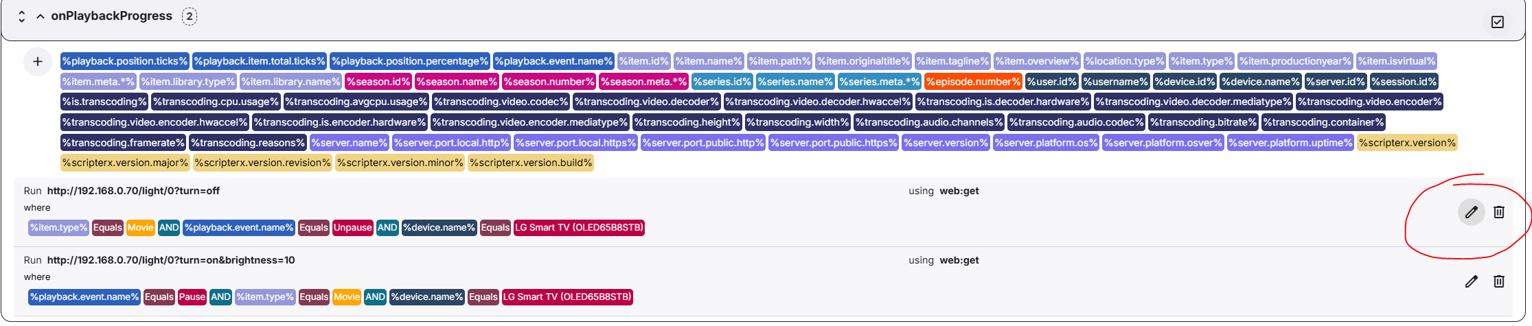

Anthony Musgrove 220 Posted March 28, 2025 Author Posted March 28, 2025 38 minutes ago, Luke said: What are you doing with drag and drop? The drag and drop functionality has existed in the plugin since early days mate - its used to drag and drop the actions list into an order that helps the user manage the list easier, but its also used to drag tokens into the parameters bar for configuring the outgoing scripting parameters. If you click Add (+) beside any of the actions in the actions list, then click the edit button on that new entry, then drag tokens and logic tokens into the parameters box Sorry, I'd screenshot but I'm currently holding a naughty little man who refuses to sleep 1 1

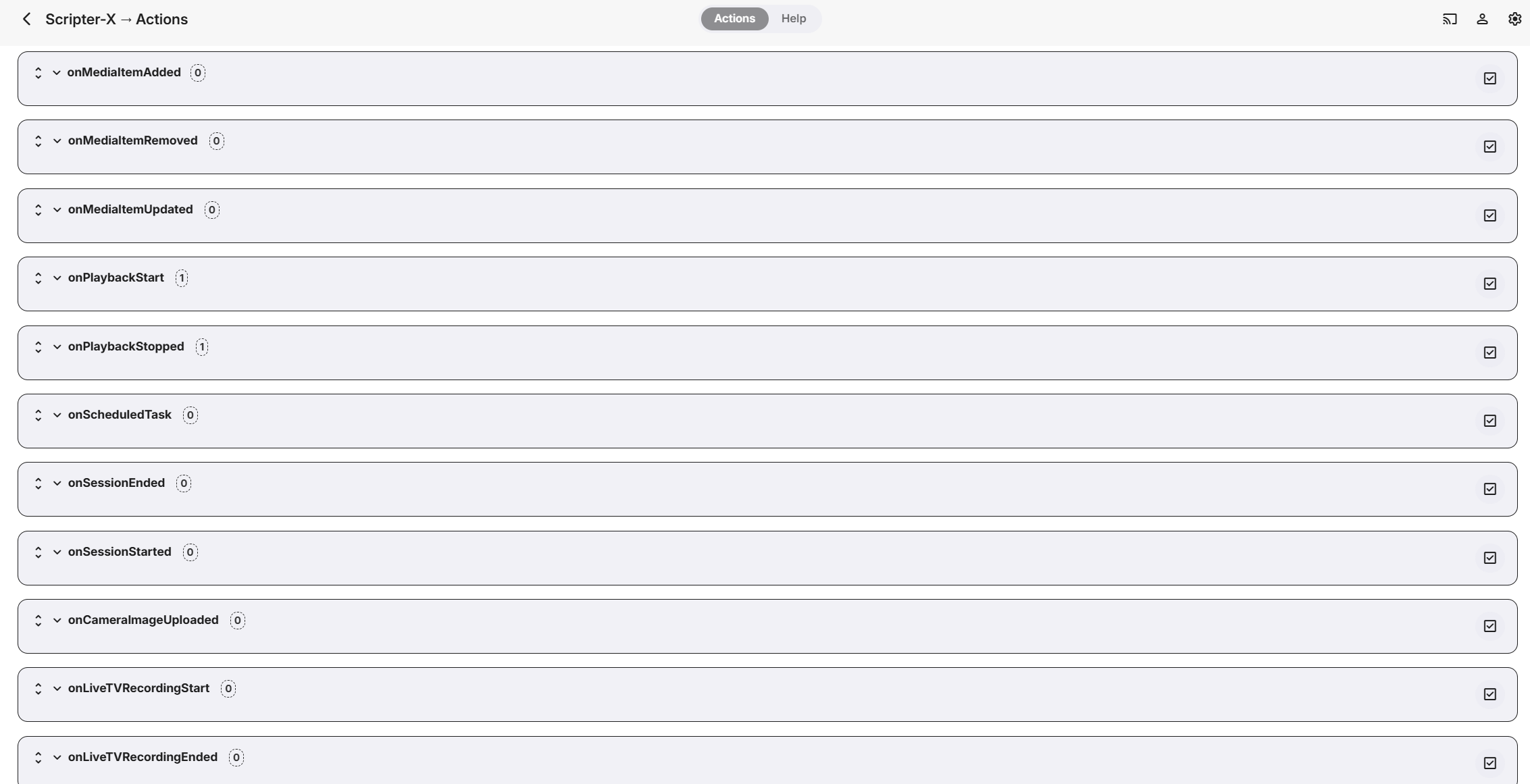

Stan Guiseppe 8 Posted March 29, 2025 Posted March 29, 2025 Hi Anthony, I've just done a fresh install of Emby 4.8.11.0 on DSM 7.2.2. I have installed Emby Scripter X 6.0.0.1. All works except my Pause/Unpause playback events aren't triggering. I have checked my EmbyScripter.xml file against the older version in my old plugins folder on previous Emby server install, and the config is the same. Do you know if something has changed on the Emby side? i.e. event name change? I have also noticed that in ScripterX, I have more than one trigger, and I cannot edit the top one. I can add more and edit them, but the top line remains unresponsive... i.e buttons circled below do nothing - any ideas? Cheers!
Stan Guiseppe 8 Posted March 29, 2025 Posted March 29, 2025 In fact, if you have multiple scripts, only the bottom one can be edited, the rest are locked
Anthony Musgrove 220 Posted March 29, 2025 Author Posted March 29, 2025 Hey Stan, thank you so much for bringing this to my attention. Both issues are now resolved in v6.0.0.2 (latest on catalog!) * Resolved action editor configuration not allowing editing of previously loaded actions * Resolved onPlaybackProgress %playback.event.name% as it was resolving to Item Name instead of Event Name
Stan Guiseppe 8 Posted March 29, 2025 Posted March 29, 2025 Thanks Anthony, both those issues now working great again! But I think something else may have broken - now you cannot drag and drop to change priority order on the main screen - the up/down cursor appears but trying to drag does not move the line... this was working in 6.0.0.1 - not really an issue for me but may be for others. Cheers!
Anthony Musgrove 220 Posted March 29, 2025 Author Posted March 29, 2025 Thanks again @Stan Guiseppe Sorting is now resolved too, v6.0.0.3 now on Catalog.
Stan Guiseppe 8 Posted March 29, 2025 Posted March 29, 2025 Yep, working again. Good on you mate that's excellent. Thanks again!

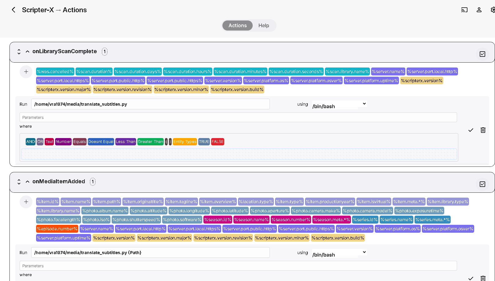

victor@vialy.com 9 Posted March 29, 2025 Posted March 29, 2025 Hi! I setup scripter to run a py script using bash everytime new content is added or full library scan. But it does not trigger the script. There is nothing in the log files other than "Scripter loaded" Am I doing something wrong?

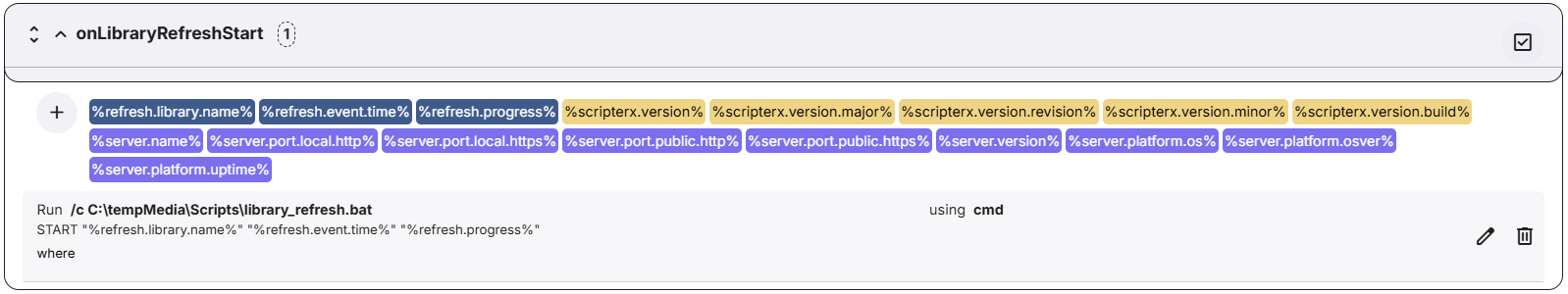

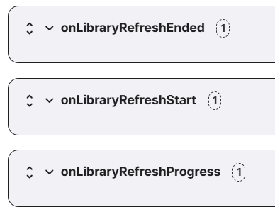

Anthony Musgrove 220 Posted March 29, 2025 Author Posted March 29, 2025 (edited) Hi Victor! Thank you for your question - New Functionality/Feature Please update to version 6.0.0.4 (latest on catalog). I've introduced three new Events: These events will trigger when your library is refreshed - which includes adding new items, removing items, etc. I will also have a way to output the items affected in the next release. Script example (library_refresh.bat REM Parameters expected: start|end|progressupdate "%refresh.library.name%" "%refresh.event.time%" "%refresh.progress%" @echo Library Refresh [%1] (Library: %2) (Event Time: %3) (Progress: %4) >> C:\tempMedia\Scripts\libraryrefresh.log Log yielded (libraryrefresh.log # libraryrefresh log Library Refresh [START] (Library: "TV") (Event Time: "3/30/2025 8:09:38 AM") (Progress: "0") Library Refresh [PROGRESS] (Library: "TV") (Event Time: "3/30/2025 8:09:38 AM") (Progress: "5") Library Refresh [PROGRESS] (Library: "TV") (Event Time: "3/30/2025 8:09:38 AM") (Progress: "10") Library Refresh [START] (Library: "Shifting Gears") (Event Time: "3/30/2025 8:09:38 AM") (Progress: "0") Library Refresh [PROGRESS] (Library: "TV") (Event Time: "3/30/2025 8:09:38 AM") (Progress: "14") Library Refresh [PROGRESS] (Library: "Shifting Gears") (Event Time: "3/30/2025 8:09:38 AM") (Progress: "5") Library Refresh [PROGRESS] (Library: "TV") (Event Time: "3/30/2025 8:09:38 AM") (Progress: "18") Library Refresh [PROGRESS] (Library: "Shifting Gears") (Event Time: "3/30/2025 8:09:38 AM") (Progress: "10") Library Refresh [PROGRESS] (Library: "Season 1") (Event Time: "3/30/2025 8:09:38 AM") (Progress: "5") Library Refresh [START] (Library: "Season 1") (Event Time: "3/30/2025 8:09:38 AM") (Progress: "0") Library Refresh [PROGRESS] (Library: "Shifting Gears") (Event Time: "3/30/2025 8:09:38 AM") (Progress: "14") Library Refresh [START] (Library: "Jimmy") (Event Time: "3/30/2025 8:09:38 AM") (Progress: "0") Library Refresh [PROGRESS] (Library: "Shifting Gears") (Event Time: "3/30/2025 8:09:38 AM") (Progress: "19.06666666666667") Library Refresh [PROGRESS] (Library: "Shifting Gears") (Event Time: "3/30/2025 8:09:38 AM") (Progress: "20.133333333333333") Library Refresh [PROGRESS] (Library: "Shifting Gears") (Event Time: "3/30/2025 8:09:38 AM") (Progress: "18") Library Refresh [PROGRESS] (Library: "Season 1") (Event Time: "3/30/2025 8:09:38 AM") (Progress: "10") Library Refresh [PROGRESS] (Library: "TV") (Event Time: "3/30/2025 8:09:38 AM") (Progress: "25.253333333333337") Library Refresh [PROGRESS] (Library: "TV") (Event Time: "3/30/2025 8:09:39 AM") (Progress: "41.46666666666667") Library Refresh [START] (Library: "Picnic") (Event Time: "3/30/2025 8:09:39 AM") (Progress: "0") Library Refresh [PROGRESS] (Library: "TV") (Event Time: "3/30/2025 8:09:38 AM") (Progress: "21.200000000000003") Library Refresh [PROGRESS] (Library: "TV") (Event Time: "3/30/2025 8:09:38 AM") (Progress: "24.4") Library Refresh [END] (Library: "Picnic") (Event Time: "3/30/2025 8:09:39 AM") (Progress: "100") Library Refresh [PROGRESS] (Library: "Jimmy") (Event Time: "3/30/2025 8:09:38 AM") (Progress: "5") Library Refresh [PROGRESS] (Library: "Picnic") (Event Time: "3/30/2025 8:09:39 AM") (Progress: "5") Library Refresh [PROGRESS] (Library: "Season 1") (Event Time: "3/30/2025 8:09:39 AM") (Progress: "63.33333333333333") Library Refresh [PROGRESS] (Library: "Shifting Gears") (Event Time: "3/30/2025 8:09:39 AM") (Progress: "60.666666666666664") Library Refresh [PROGRESS] (Library: "Season 1") (Event Time: "3/30/2025 8:09:39 AM") (Progress: "64.66666666666666") Library Refresh [PROGRESS] (Library: "Shifting Gears") (Event Time: "3/30/2025 8:09:39 AM") (Progress: "61.73333333333333") Library Refresh [PROGRESS] (Library: "Season 1") (Event Time: "3/30/2025 8:09:39 AM") (Progress: "38") Library Refresh [PROGRESS] (Library: "Season 1") (Event Time: "3/30/2025 8:09:39 AM") (Progress: "39.33333333333333") Library Refresh [PROGRESS] (Library: "Shifting Gears") (Event Time: "3/30/2025 8:09:39 AM") (Progress: "41.46666666666667") Library Refresh [PROGRESS] (Library: "TV") (Event Time: "3/30/2025 8:09:39 AM") (Progress: "58.53333333333333") Library Refresh [PROGRESS] (Library: "Shifting Gears") (Event Time: "3/30/2025 8:09:39 AM") (Progress: "40.400000000000006") Library Refresh [PROGRESS] (Library: "TV") (Event Time: "3/30/2025 8:09:40 AM") (Progress: "90") Library Refresh [START] (Library: "Career") (Event Time: "3/30/2025 8:09:39 AM") (Progress: "0") Library Refresh [PROGRESS] (Library: "TV") (Event Time: "3/30/2025 8:09:39 AM") (Progress: "60.24000000000001") Library Refresh [END] (Library: "Season 1") (Event Time: "3/30/2025 8:09:40 AM") (Progress: "100") Library Refresh [PROGRESS] (Library: "Shifting Gears") (Event Time: "3/30/2025 8:09:39 AM") (Progress: "62.800000000000004") Library Refresh [PROGRESS] (Library: "TV") (Event Time: "3/30/2025 8:09:40 AM") (Progress: "100") Library Refresh [PROGRESS] (Library: "Season 1") (Event Time: "3/30/2025 8:09:40 AM") (Progress: "90") Library Refresh [PROGRESS] (Library: "Shifting Gears") (Event Time: "3/30/2025 8:09:40 AM") (Progress: "90") Library Refresh [END] (Library: "Shifting Gears") (Event Time: "3/30/2025 8:09:40 AM") (Progress: "100") Library Refresh [PROGRESS] (Library: "TV") (Event Time: "3/30/2025 8:09:39 AM") (Progress: "43.17333333333334") Library Refresh [END] (Library: "TV") (Event Time: "3/30/2025 8:09:40 AM") (Progress: "100") Library Refresh [PROGRESS] (Library: "Career") (Event Time: "3/30/2025 8:09:39 AM") (Progress: "5") Library Refresh [PROGRESS] (Library: "TV") (Event Time: "3/30/2025 8:09:40 AM") (Progress: "100") Library Refresh [PROGRESS] (Library: "TV") (Event Time: "3/30/2025 8:09:40 AM") (Progress: "100") Library Refresh [PROGRESS] (Library: "TV") (Event Time: "3/30/2025 8:09:40 AM") (Progress: "93.33333333333333") Library Refresh [PROGRESS] (Library: "Movies") (Event Time: "3/30/2025 8:09:40 AM") (Progress: "10") Library Refresh [PROGRESS] (Library: "TV") (Event Time: "3/30/2025 8:09:40 AM") (Progress: "82") Library Refresh [PROGRESS] (Library: "Movies") (Event Time: "3/30/2025 8:09:40 AM") (Progress: "90") Library Refresh [PROGRESS] (Library: "Season 1") (Event Time: "3/30/2025 8:09:39 AM") (Progress: "36.666666666666664") Library Refresh [PROGRESS] (Library: "Career") (Event Time: "3/30/2025 8:09:39 AM") (Progress: "10") Library Refresh [PROGRESS] (Library: "Season 1") (Event Time: "3/30/2025 8:09:39 AM") (Progress: "66") Library Refresh [PROGRESS] (Library: "TV") (Event Time: "3/30/2025 8:09:40 AM") (Progress: "90") Library Refresh [PROGRESS] (Library: "TV") (Event Time: "3/30/2025 8:09:40 AM") (Progress: "96.66666666666667") Library Refresh [PROGRESS] (Library: "Picnic") (Event Time: "3/30/2025 8:09:39 AM") (Progress: "10") Library Refresh [PROGRESS] (Library: "TV") (Event Time: "3/30/2025 8:09:40 AM") (Progress: "75.60000000000001") Library Refresh [END] (Library: "Movies") (Event Time: "3/30/2025 8:09:40 AM") (Progress: "100") Library Refresh [PROGRESS] (Library: "Shifting Gears") (Event Time: "3/30/2025 8:09:40 AM") (Progress: "82") Library Refresh [PROGRESS] (Library: "Movies") (Event Time: "3/30/2025 8:09:40 AM") (Progress: "5") Important to note : This triggers for each folder / item in your libraries as well - so you could just use a Logic Parameter for WHERE %refresh.library.name% EQUALS "TV" or "Movies" etc. You could also use this to monitor particular TV series by using WHERE %refresh.library.name% EQUALS "Shifting Gears", so this is much more powerful than first anticipated. Awesome! Please let me know if you experience any issues, but this should clear up many concerns with library scanning and monitoring within ScripterX Kind regards, Anthony Edited March 29, 2025 by Anthony Musgrove

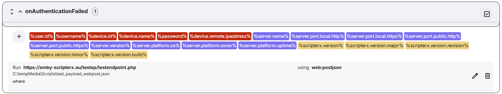

Stan Guiseppe 8 Posted March 29, 2025 Posted March 29, 2025 Hey Anthony, I have set up Scripter to send a webhook to my HA, using a json file as shown in one of your examples. I am getting a Newtonsoft.json missing file error when the script tries to run (see below) Is there something else that I need to install? I'm a bit new to webhooks etc..... ~~~ *** Error Report *** Version: 4.8.11.0 Command line: /volume1/@appstore/EmbyServer/system/EmbyServer.dll -programdata /var/packages/EmbyServer/var -ffdetect /var/packages/EmbyServer/target/bin/ffdetect -ffmpeg /var/packages/EmbyServer/target/bin/ffmpeg -ffprobe /var/packages/EmbyServer/target/bin/ffprobe -nolocalportconfig -ignore_vaapi_enabled_flag -pidfile /var/packages/EmbyServer/var/EmbyServer.pid -defaultdirectory /volume1/Public -updatepackage emby-server-synology72_{version}_x86_64.spk -noautorunwebapp Operating system: Linux version 4.4.302+ (root@build7) (gcc version 12.2.0 (GCC) ) #72806 SMP Thu Sep 5 13:42:01 CST 2024 Framework: .NET 6.0.36 OS/Process: x64/x64 Runtime: volume1/@appstore/EmbyServer/system/System.Private.CoreLib.dll Processor count: 4 Data path: /var/packages/EmbyServer/var Application path: /volume1/@appstore/EmbyServer/system System.IO.FileNotFoundException: System.IO.FileNotFoundException: Could not load file or assembly 'Newtonsoft.Json, Version=13.0.0.0, Culture=neutral, PublicKeyToken=30ad4fe6b2a6aeed'. The system cannot find the file specified. File name: 'Newtonsoft.Json, Version=13.0.0.0, Culture=neutral, PublicKeyToken=30ad4fe6b2a6aeed' at EmbyScripterX.Core.ScripterXEventContext.getTemplate_substituteTokens(String template_contents, Boolean jsonSafe) at EmbyScripterX.Core.ScripterXEventContext.ProcessWeb(String method) at EmbyScripterX.Core.ScripterXEventContext.Process(EmbyScripterXAction withAction) at EmbyScripterX.ScripterXDVRMonitor._livetvManager_RecordingEnded(Object sender, GenericEventArgs`1 e) at MediaBrowser.Common.Events.EventHelper.TriggerAll[T](EventHandler`1 mainHandler, Object sender, T args, ILogger logger) Source: EmbyScripterX TargetSite: System.String getTemplate_substituteTokens(System.String, Boolean) ~~~ Any help is appreciated.
Anthony Musgrove 220 Posted March 30, 2025 Author Posted March 30, 2025 Hey @Stan Guiseppe thank you mate - this will be resolved in the next release this evening. Just doing some testing. I'll also be writing proper documentation on the new wiki for all these extras Https://wiki.emby-scripterx.au is live, but still much so in progress
Stan Guiseppe 8 Posted March 30, 2025 Posted March 30, 2025 Nice one Anthony, thanks heaps. I'll check out the wiki too
Anthony Musgrove 220 Posted March 30, 2025 Author Posted March 30, 2025 No problems @Stan Guiseppe Please note - I've revised the code, updated the internal libraries for Newtonsoft.Json, and added the following: web:postjson For information on how it works, please see the following wiki page: https://wiki.emby-scripterx.au/en/processors/web If any issues please let me know
