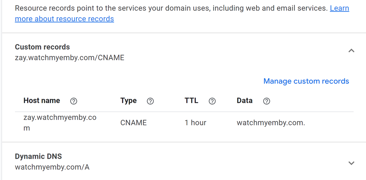

Carlo 4561 Posted October 23, 2021 Posted October 23, 2021 Hi, it's not working for you because your DNS is setup incorrectly. You need an A record with an IP address that points to your WAN IP address. You can verify this does not work by opening a command prompt and trying either: ping zay.watchmyemby.com pin watchmyemby.com neither work because it can't resolve to an IP address.

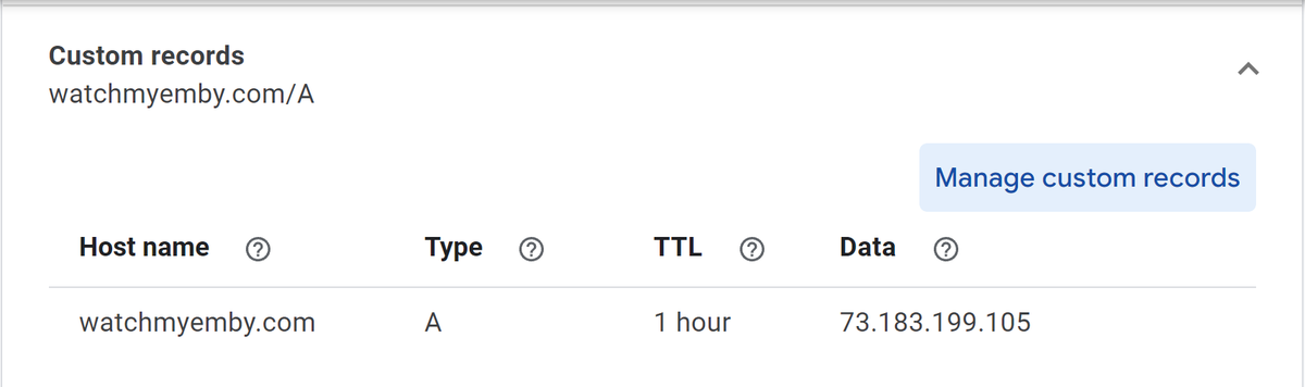

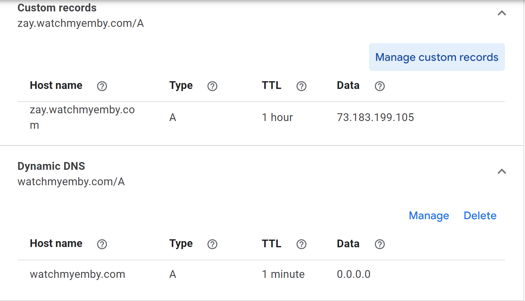

AbnrangerZay 1 Posted October 23, 2021 Posted October 23, 2021 1 hour ago, cayars said: Hi, it's not working for you because your DNS is setup incorrectly. You need an A record with an IP address that points to your WAN IP address. You can verify this does not work by opening a command prompt and trying either: ping zay.watchmyemby.com pin watchmyemby.com neither work because it can't resolve to an IP address. Thanks for the tip. Do I need to, or should I delete the other A record? Here is what I now have: That is my public IP there.

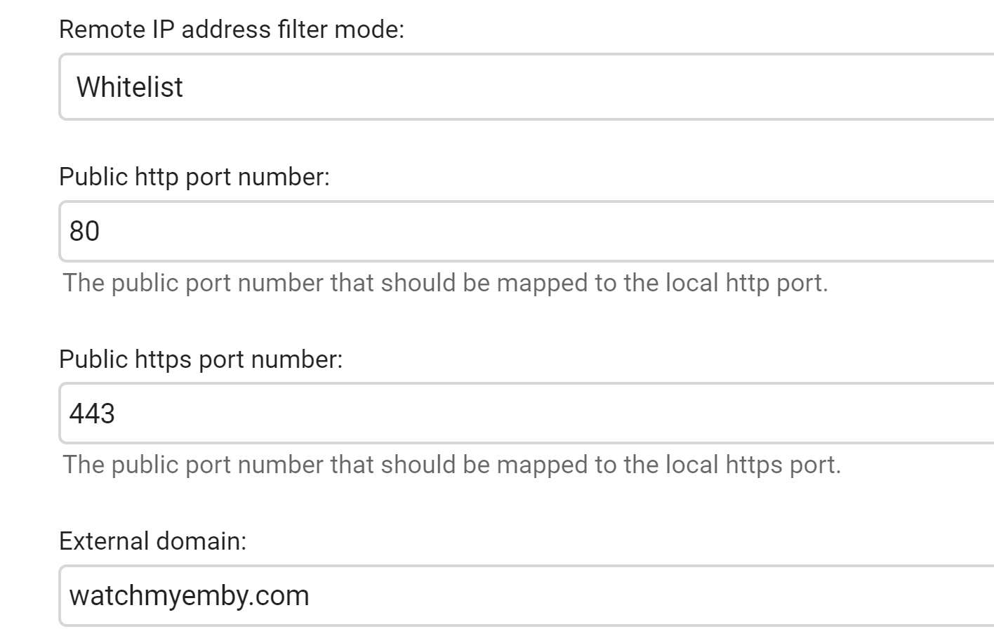

Carlo 4561 Posted October 23, 2021 Posted October 23, 2021 I'm still confused by your IPing above. Why are you setting the domain itself to a non-existent IP of 0.0.0.0? Let's do this a different way. First do you need anything other that "watchmyemby.com"? Will this domain be used for anything other than Emby? It's wouldn't seem so based on the name. If not get rid of the zay entry and just set the domain A record to your IP. Then in Emby network settings you enter watchmyemby.com as the remote name (domain). Regardless of the domain part, if you go to canuseeme.org and run a port check does it pass or fail using the Emby ports?
AbnrangerZay 1 Posted October 23, 2021 Posted October 23, 2021 55 minutes ago, cayars said: I'm still confused by your IPing above. Why are you setting the domain itself to a non-existent IP of 0.0.0.0? Let's do this a different way. First do you need anything other that "watchmyemby.com"? Will this domain be used for anything other than Emby? It's wouldn't seem so based on the name. If not get rid of the zay entry and just set the domain A record to your IP. Then in Emby network settings you enter watchmyemby.com as the remote name (domain). Regardless of the domain part, if you go to canuseeme.org and run a port check does it pass or fail using the Emby ports? Thanks for your suggestions and patience. No, this will only be used for watching my Emby media remotely. I followed the post and the Zay entry was for the cname and dynamic DNS. Per your last set of instructions, I removed the everything, except just the A record pointing to my public IP address as you see in the below screenshot. Now, again, per the initial set of instructions, an entry for DDNS should be setup as well as a CName, of which I now have none of those. However, I am leaving as is until further instructions. I included screenshots to show that the caddy service is running, and what my domain configuration and Emby network settings are. But to your question about the ping results, no. When I do the port check, they all error out. Although, I may need to give the domain settings more time for them to propagate. I will try it again in a bit and provide a status. Thanks again.

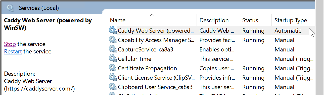

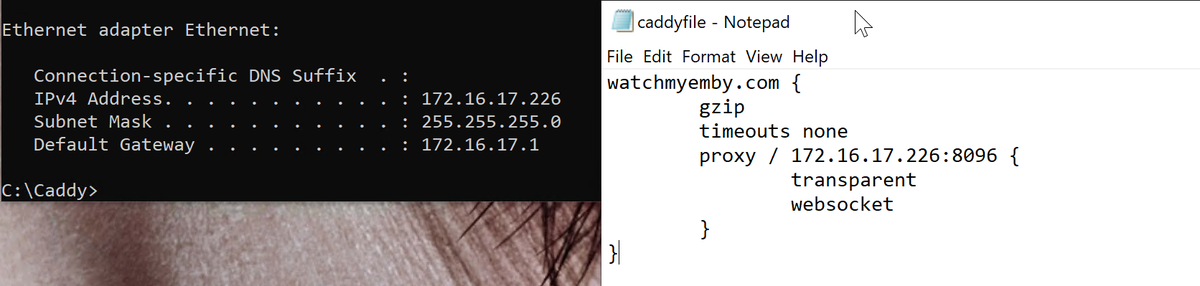

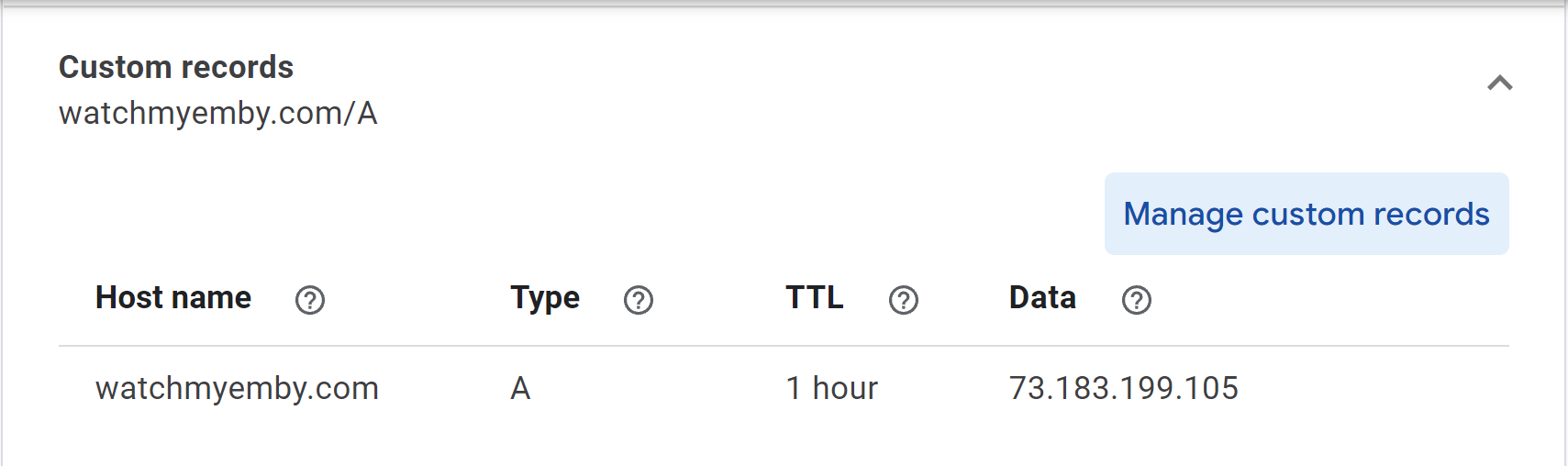

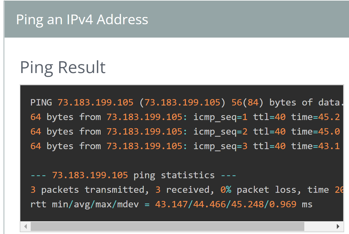

AbnrangerZay 1 Posted October 23, 2021 Posted October 23, 2021 7 hours ago, cayars said: Hi, it's not working for you because your DNS is setup incorrectly. You need an A record with an IP address that points to your WAN IP address. You can verify this does not work by opening a command prompt and trying either: ping zay.watchmyemby.com pin watchmyemby.com neither work because it can't resolve to an IP address. Ok, so I can ping watchmyemby.com, but not able to telnet to port 80 or 443. The results from the port check website also shows it is not working, so not sure what else could be wrong. I double checked ports 443 and 80 in my router are forwarded to my Emby server. Now even though the caddy service is running, how do I know that it is actually working? Here are the results of my ping. In fact see if you can ping it from your computer. I also included the information
Carlo 4561 Posted October 24, 2021 Posted October 24, 2021 With Caddy running you have extra steps to make sure are correct before anything works. Do you need Caddy for anything other than Emby? If not I would stop it and go back to a basic setup and work up from there. Example: First shutdown Caddy so it's not running. Setup a port forward for port 8096 in your router that points to the Emby Server using port 8096 (don't worry about SSL for now). Configure Emby networking without the domain name (so it uses the WAN IP address) and set the Secured mode in Emby to Disabled. Restart Emby Server. Now test from canyouseeme.org to see if port 8096 is open. This is the most basic of tests. No point trying to configure anything else until this port shows as open. If this port check doesn't work we need to figure out why which could be things like: A firewall blocking your connection Some other security software or VPN causing the issue Are you behind a CGNAT your ISP has in place So can you try that and report back your results?
