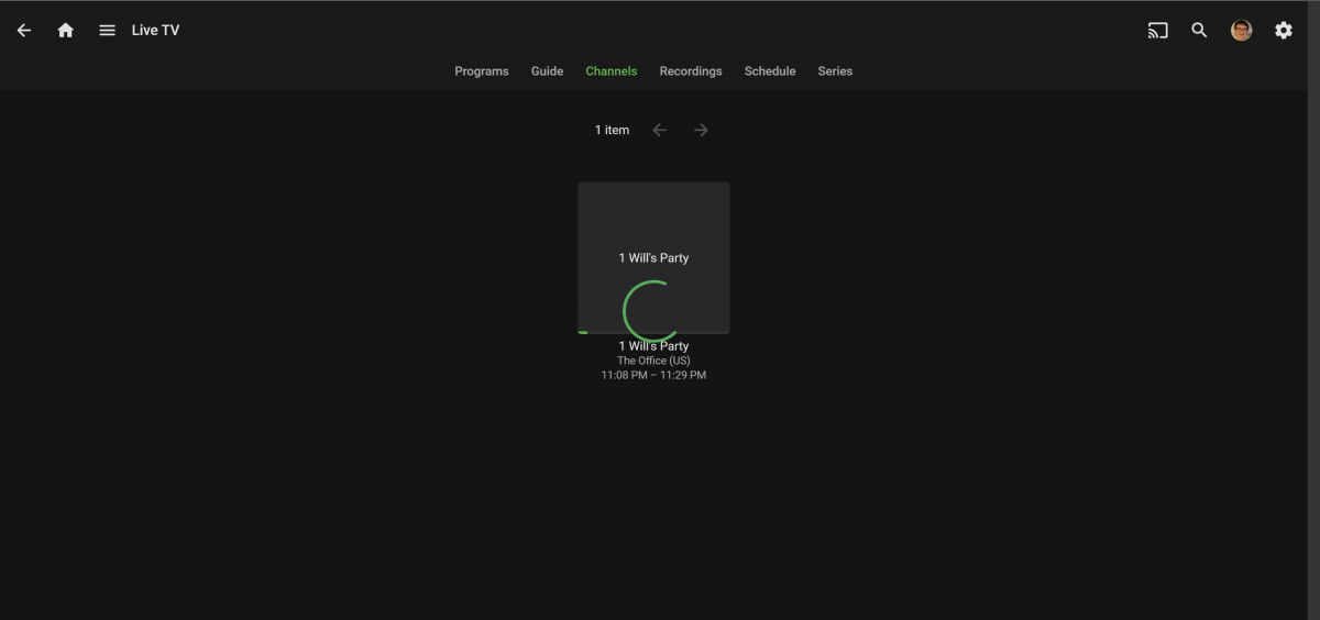

wmilun 0 Posted April 14, 2020 Posted April 14, 2020 Hello. I am very interested in using VirtualTV plugin for my Emby server running in a jail on my FreeNAS server. I am able to configure a channel for Single Playback, to the points where it shows up on the guide with a schedule, but when I attempt to play the "channel" it sits there loading infinitely (As shown in screenshot). I have attached the error in the emby log. 2020-04-13 22:51:42.423 Info LiveTvManager: Opening channel stream from VirtualTV, external channel Id: VirtualTV0 2020-04-13 22:51:42.424 Error HttpServer: Error processing request *** Error Report *** Version: 4.3.1.0 Command line: /usr/local/lib/emby-server/system/EmbyServer.exe -os freebsd -ffmpeg /usr/local/bin/ffmpeg -ffprobe /usr/local/bin/ffprobe -programdata /var/db/emby-server -updatepackage emby-server-freebsd_{version}_amd64.txz -noautorunwebapp Operating system: Unix 11.3.7.0 64-Bit OS: True 64-Bit Process: True User Interactive: False Mono: 5.10.1.57 (5.10.1.57 Thu Apr 9 02:10:25 UTC 2020) Runtime: file:///usr/local/lib/mono/4.5/mscorlib.dll Processor count: 4 Program data path: /var/db/emby-server Application directory: /usr/local/lib/emby-server/system System.MissingMethodException: System.MissingMethodException: void System.Net.ServicePointManager.CloseConnectionGroups(string) at System.Net.Http.HttpMessageHandler.Dispose () [0x00000] in <27bbdd4ceaf04a95b172ee502d76a725>:0 at System.Net.Http.HttpMessageInvoker.Dispose (System.Boolean disposing) [0x0001e] in <27bbdd4ceaf04a95b172ee502d76a725>:0 at System.Net.Http.HttpClient.Dispose (System.Boolean disposing) [0x0002c] in <27bbdd4ceaf04a95b172ee502d76a725>:0 at System.Net.Http.HttpMessageInvoker.Dispose () [0x00000] in <27bbdd4ceaf04a95b172ee502d76a725>:0 at VirtualTV.Services.StreamingService+<RequestPlaybackInfo>d__20.MoveNext () [0x00271] in <8db711ee08a24d649ee7e80e93d46ca9>:0 Source: System.Net.Http TargetSite: Void Dispose() Config: Stuck Loading:
pünktchen 1411 Posted April 14, 2020 Author Posted April 14, 2020 @@wmilun obviously the mono framework is missing a basic method that is called by a function i'm using. I'm working on it. 1
