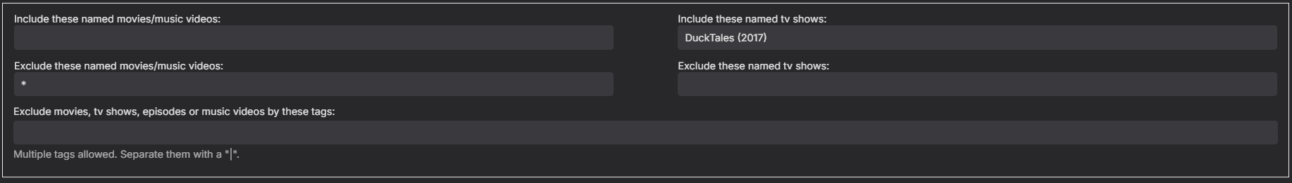

Kyouma 61 Posted June 21 Posted June 21 (edited) Wanted to try out this plugin but run into an issue. When i press play on the remote the playback will start at the correct time, but it will immeadiatly go back to the previous screen. You can still hear the audio in the background. Here is a recording of it 20260621_231742.mp4 I am using the Apple TV ver 2.0.6 (3) and Emby server 4.9.5. Edit: I am using the Playlist (live) mode Also i have another question. How to only get the shows i have set in "Include these named tv shows"? I tried some combinations, but it always puts other shows in there or none when i set "*" in " Exclude these named tv shows" Edited June 21 by Kyouma

Kyouma 61 Posted June 25 Posted June 25 4 hours ago, pünktchen said: I've uploaded Dev version 2.1.8.2 to the plugin catalog. Just for testing i've modified the playback setting "Playlist Intro Delay" so that it will also be used for "Native (Live)" playback. Gonna try that when I'm home. 4 hours ago, pünktchen said: Please give me a specific example with screenshots of your channel rules and the preview result. If you like, you can pm me in German. Send you a pm.
