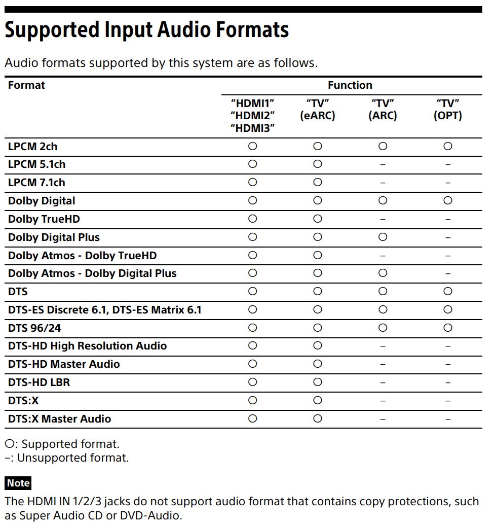

Sigogglin 1 Posted October 8, 2019 Author Posted October 8, 2019 Here is a complete log: Transcode.log I also found this table for the soundbar. I have been able to test video with DD , TrueHD, Atmos Dolby TrueHD, DTS DTS-ES 6.1. They all work/don't work as the sheet says except DTS 7.1. DTS 7.1 the sound is slow, garbled and often completely missing. It is not trying to transcode. For DTS 7.1 I enabled debug logging on the server and played Venom, this is the piece in the log between starting/stopping the video. The sound was not good: Debug.rtf Hopefully this can help with DTS 7.1 thanks again, david Debug.rtf Transcode.log
ebr 16338 Posted October 8, 2019 Posted October 8, 2019 Hi. As barong stated - your soundbar may support those formats but your TV does not so they will not pass and the app will transcode to a format that is supported. Plex is transcoding too they are just doing it in a different way/place. Sony TVs have always had trouble with DTS from Android apps too which is actually why those options exist in the app. If this is a new TV then 5.1 DTS should work but 7.1 may have to be downmixed. As you found, the Shield has no problem with any of this.
