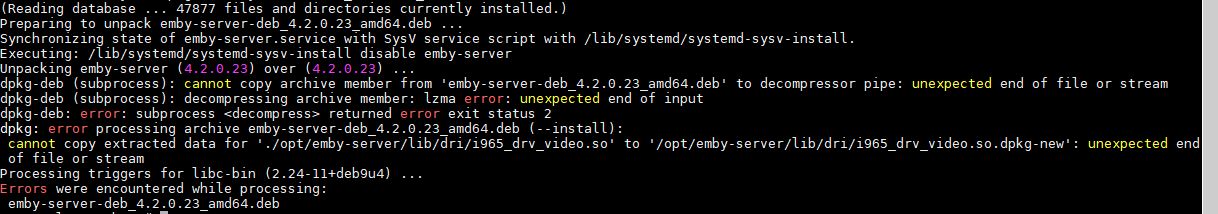

MaC_ToC 1 Posted July 1, 2019 Posted July 1, 2019 Good morning, everyone, Here I'm looking to install emby-server 4.1 on debian. When I follow the instructions on https://emby.media/linux-server.html that's what it tells me ( sorry it's in French): Out through other tutorials I managed to install Emby-server 3.3.5. Do you have an idea to help me I don't know where to look? Thank you

Luke 42246 Posted July 1, 2019 Posted July 1, 2019 Thanks ! What is the exact terminal command that you entered?
MaC_ToC 1 Posted July 2, 2019 Author Posted July 2, 2019 I did exactly as written on https://emby.media/linux-server.html dpkg -i emby-server-deb_4.2.0.23_amd64.deb
alucryd 318 Posted July 2, 2019 Posted July 2, 2019 It seems the deb was corrupted, your download probably got interrupted. Please uninstall, redownload the full deb and try installing again.

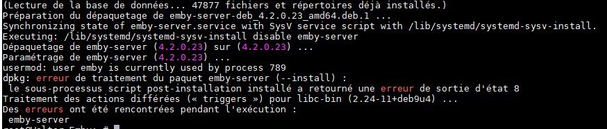

alucryd 318 Posted July 2, 2019 Posted July 2, 2019 You're getting a completely different error now, your package was indeed corrupted. You seem to have a process running as emby now. Did you per chance manually create an emby user? Please don't do that, we need that particular user for the emby server. If you didn't, then you already have a running emby-server, please visit localhost:8096, and if it still doesn't work, you'll have to kill the pid from the error log, 788 here, and try installing again.
MaC_ToC 1 Posted July 2, 2019 Author Posted July 2, 2019 Okay just for your information I made a blank 9.9 debian vm and yet I have an error with the.deb I uploaded earlier
mastrmind11 722 Posted July 3, 2019 Posted July 3, 2019 how are you doing this? This clearly states the user `emby` already exists which is causing the issues you're experiencing.
MaC_ToC 1 Posted July 3, 2019 Author Posted July 3, 2019 how are you doing this? This clearly states the user `emby` already exists which is causing the issues you're experiencing. What do you mean? That I'm lying? I installed a debian VM with nothing on it and I'm just installing Emby.server. And I have the mistake here before! How could you think I'm talking nonsense????? I preferred to spend time configuring emby than to take care of its installation! In the meantime, it's not working!
mastrmind11 722 Posted July 3, 2019 Posted July 3, 2019 What do you mean? That I'm lying? I installed a debian VM with nothing on it and I'm just installing Emby.server. And I have the mistake here before! How could you think I'm talking nonsense????? I preferred to spend time configuring emby than to take care of its installation! In the meantime, it's not working! Not implying anything, simply asking what steps you're using to install since systemd clearly things the emby user already exists, which is odd given what you're describing as your install process. Stranger still that it's behaving the same on 2 different flavors. Maybe try the docker version since it's self contained. 1

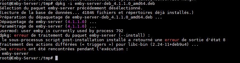

CChris 59 Posted July 3, 2019 Posted July 3, 2019 I have just installed the emby server 4.1.1.0 without any issues on my debian container...Unfortunately, I cannot give a clear advice here, but from my point of view, your errors are not related to the installer itself.let's try another thing:1) Create a new / fresh VM with Debian 9 2) apt-get update3) apt-get dist-upgrade 4) Then, create a download folder somewhere:# mkdir /downloads5) download the emby server applciation for debian# wget https://github.com/MediaBrowser/Emby.Releases/releases/download/4.1.1.0/emby-server-deb_4.1.1.0_amd64.deb 6) Install the package again# dpkg -i emby-server-deb_4.1.1.0_amd64.deb this worked perfectly fine for me... 1
MaC_ToC 1 Posted July 4, 2019 Author Posted July 4, 2019 (edited) Not implying anything, simply asking what steps you're using to install since systemd clearly things the emby user already exists, which is odd given what you're describing as your install process. Stranger still that it's behaving the same on 2 different flavors. Maybe try the docker version since it's self contained. Thank you all and sorry for my reactions. After his intervention of mastermind11, I had an awakening. And yes, it's all my fault. To debian's installation when he asks to create a user I put...................emby................................. and that's it, when the server is installed he can do nothing because the user emby already exists ... it took me a long time to understand. So now everything is settling in well! But I still have a problem. My installation is on proxmox in vm debian. On this Vm I mount a hard disk ( sdb1) in /media. In debian (desktop or terminal) in media I have all the movies no worries. But in emby when I click on /media/Films the path doesn't want to go. When I force it by putting it manually I have no movies in the playlist. I can't see what I've missed again. If you have any ideas. Thank you again and sorry. Edited July 4, 2019 by MaC_ToC
